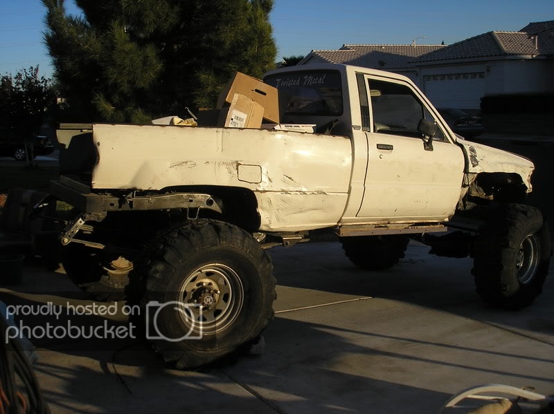

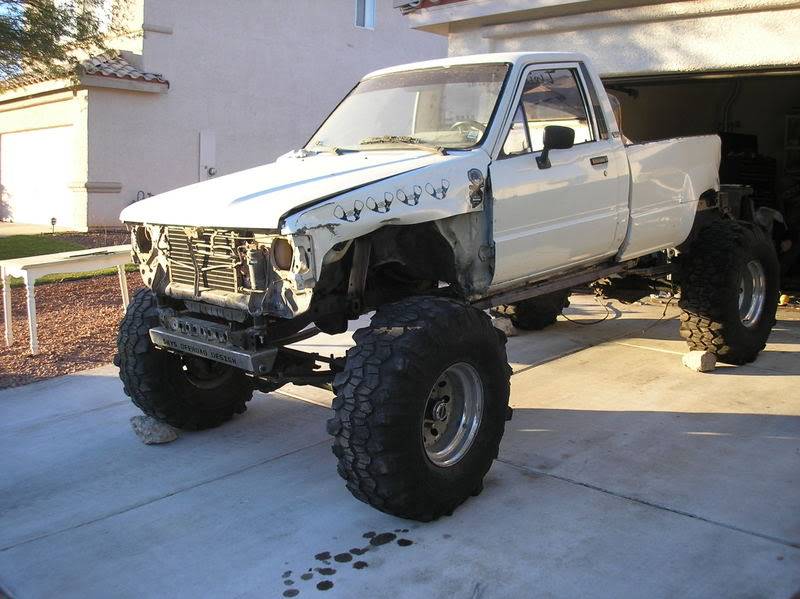

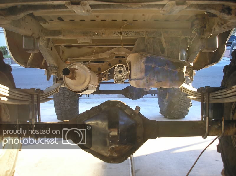

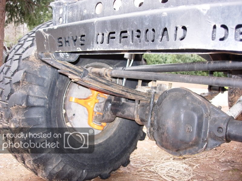

Here's some pics during the build.

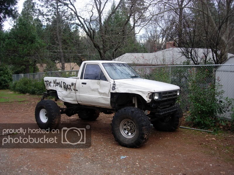

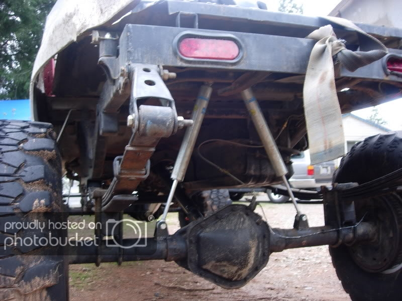

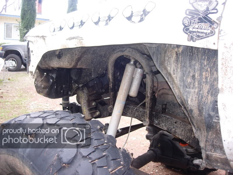

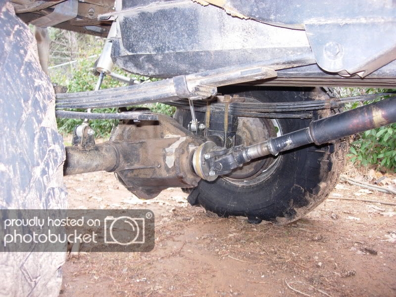

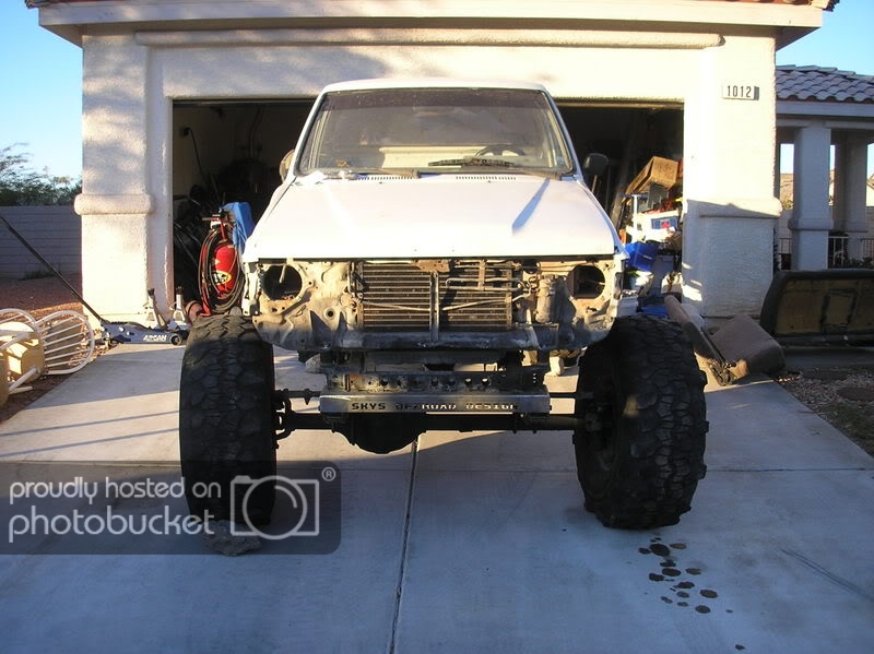

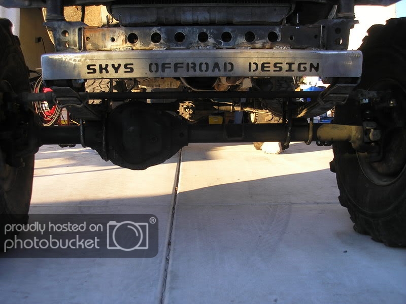

here's some finished pics of the truck. the specs are 22r-G52-dual cases w/ 4.7 in the rear case. bilsteins all around, dedenbear knuckles d44 & 14 bolt 4.10's welded, crossover, toy rears front, 63's rear with 2" block and double shackle thing. toy flange for the 14 bolt and square front shaft. Dovetailed bed all the way to the frame. 39" swampers cut on 16.5x10 wheels

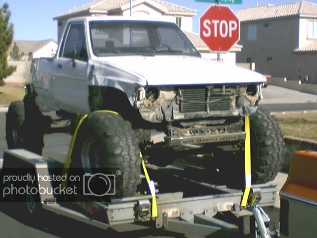

and a pic driving it up to its new owner. The new owner later blew the motor up after snow wheeling and getting stuck in 4 feet of fresh powder. I guess the 22r couldn't power out of its way and hold together and about 5500rpms
