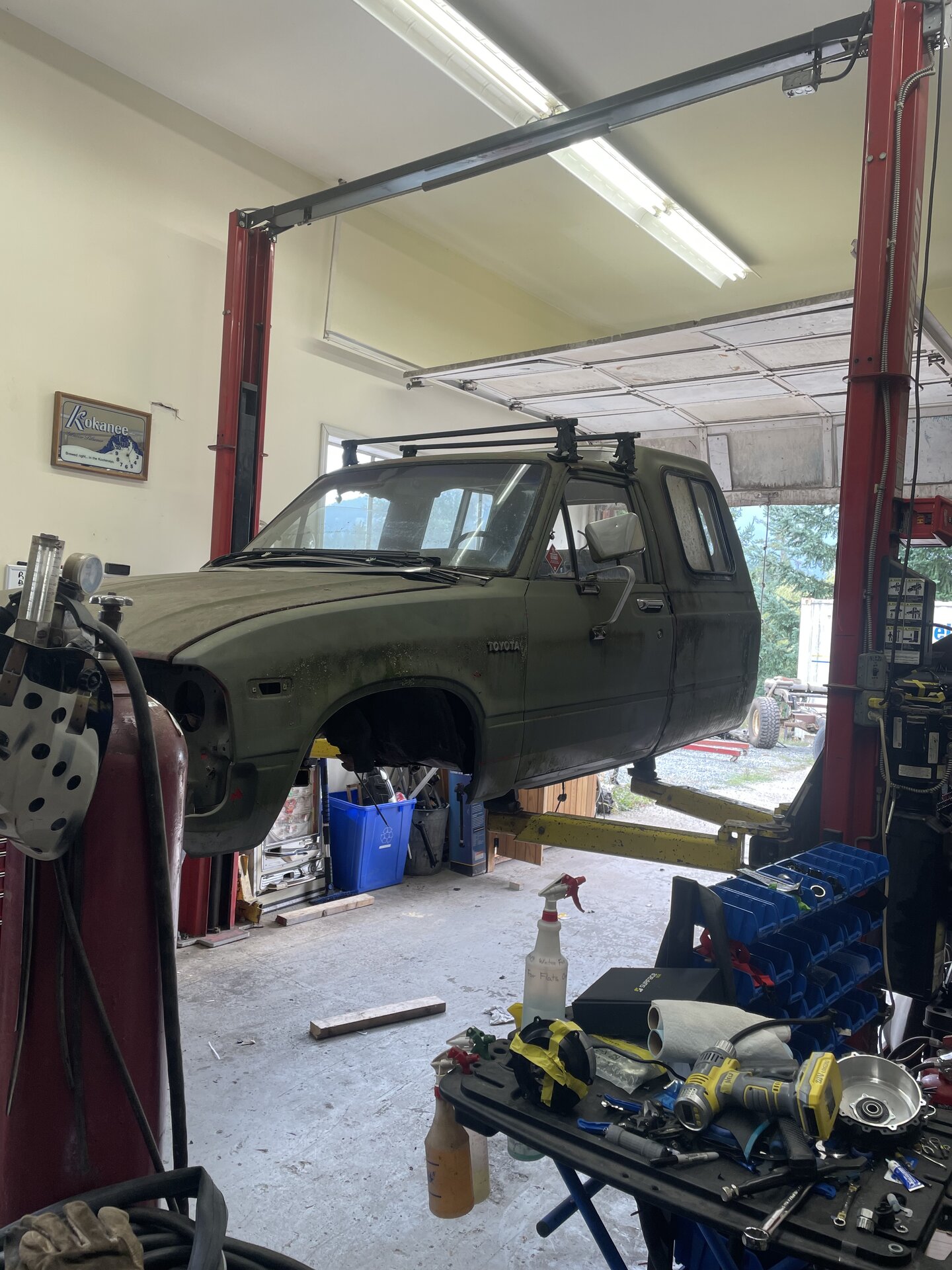

Found this 83 custom cab locally, quite rare here in BC.

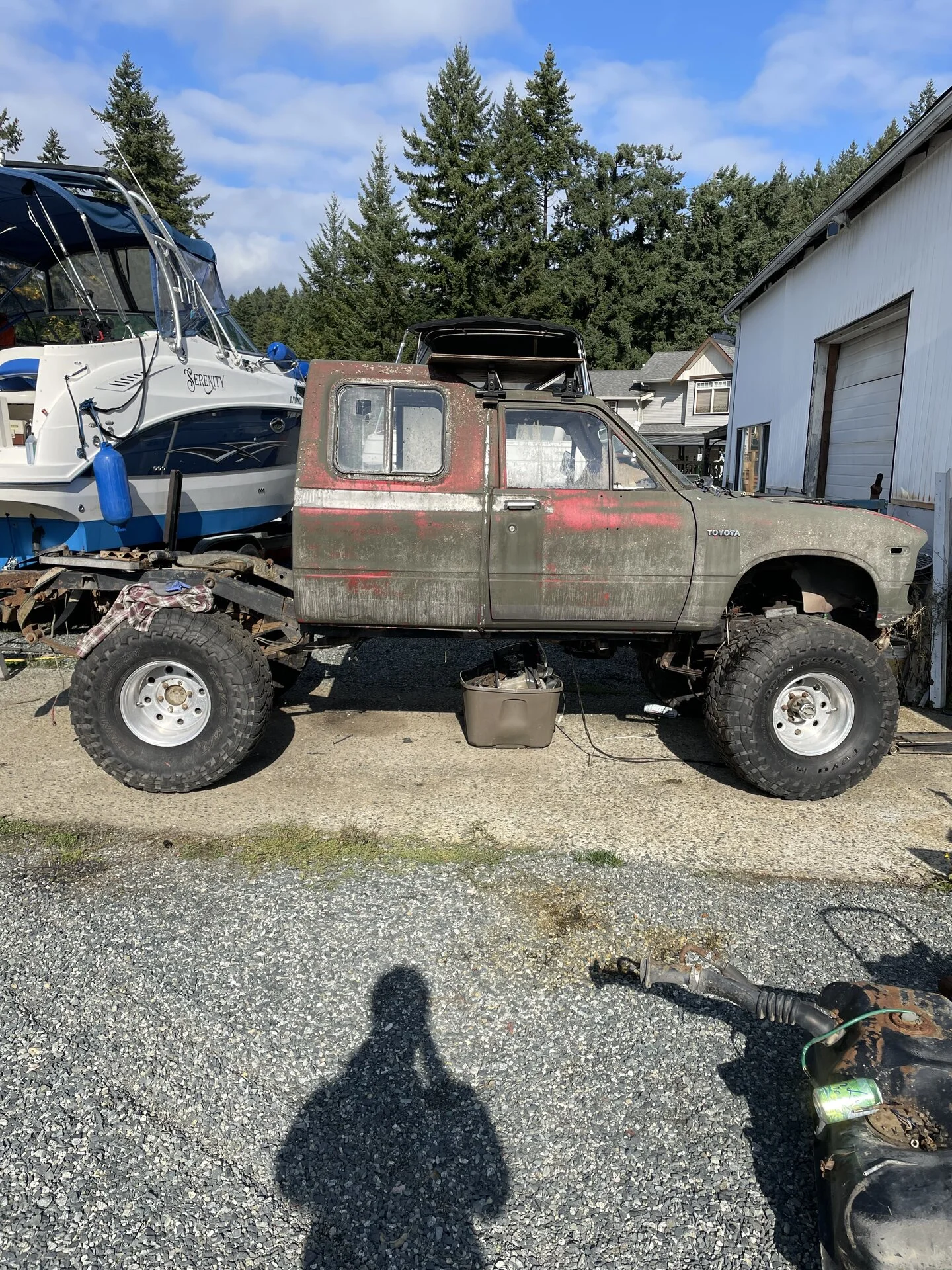

original frame/motor/tranamision was gone so I found a sas'd 3rd gen xtra cab frame.
Put the cab on the new running gear.
Had to move a few mounts around and the front mounts needed to be moved back just a couple inches.

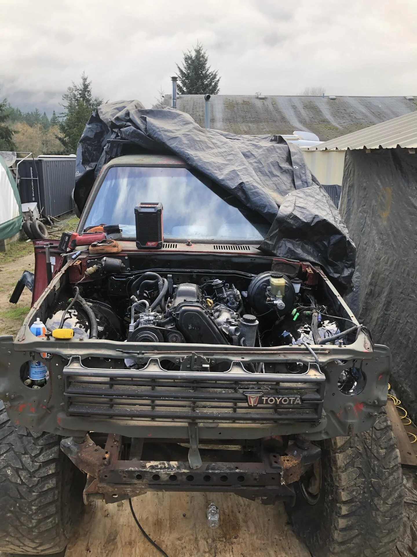

Found a hilux surf getting parted out so I picked it up and took the motor and many other small things to go on the truck.
Havnt had a ton of time but so far it's got the motor/transmission in it.

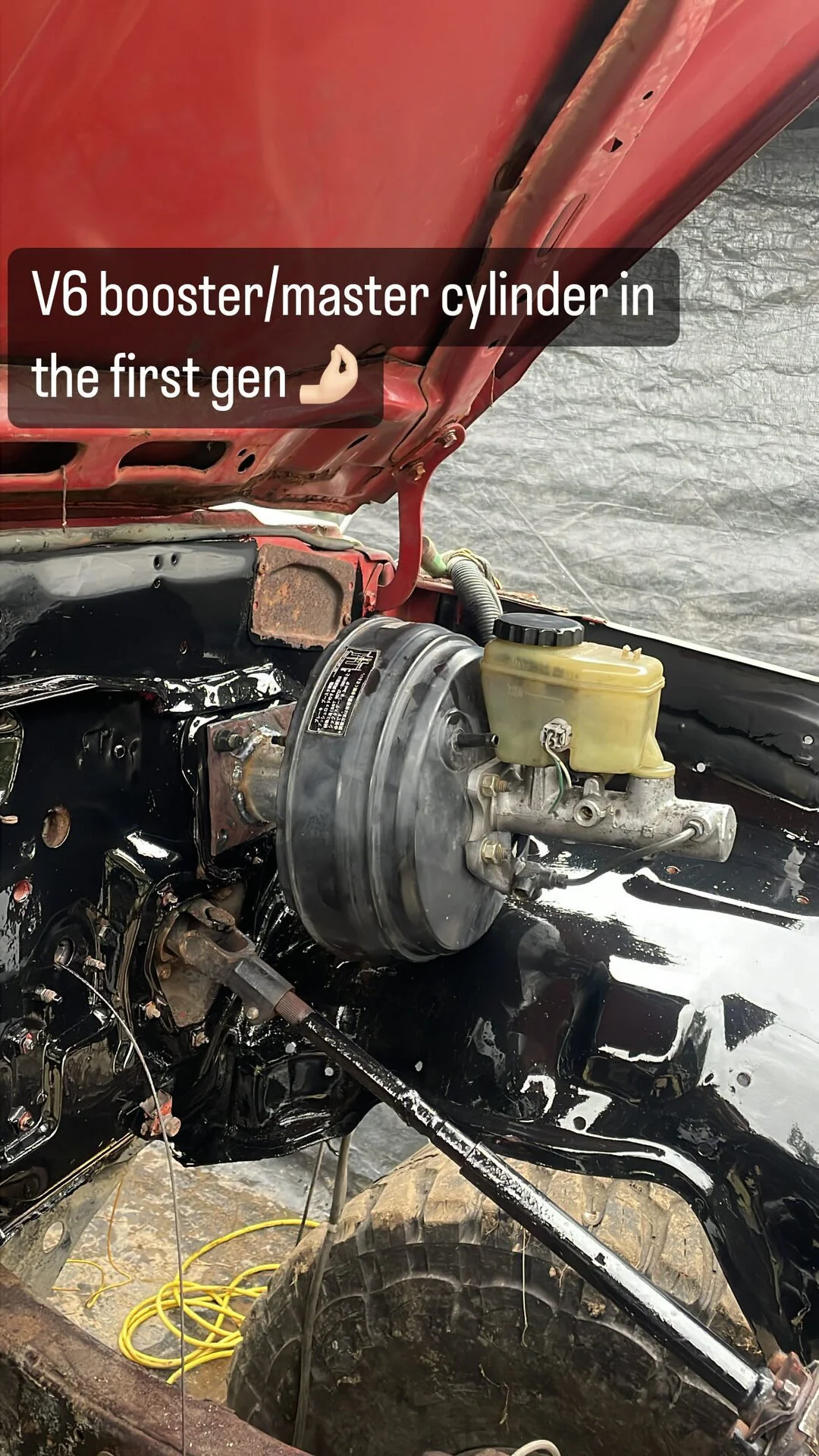

Got a v6 booster/master cylinder installed. Installed a tilt column from a second gen pickup.
4M40 Mechanical injection pump installed

The 1KZ TE is a sweet option. I had a 93 runner with one in for a moment in time but never saw it run. Does this have the mechanical pump or electrical one?
It came with an electric pump but I put a zexel 4M40 pump from a Delica on it.
