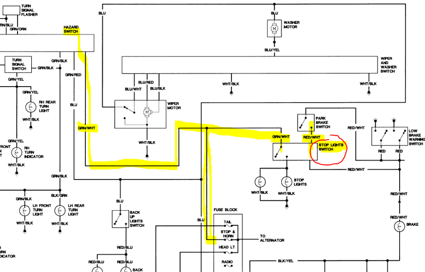

First question: PO had partially disassembled and reassembled for sale... I can't find the connection to the brake pedal switch... switch is there, connector is dangling (with 2 green wires going to the connector) but can't find the mate. Should I look for it towards the fuse block? or towards the brake light in dash? or towards the eBrake handle? I'm assuming fuse block, but man, it's tight under there! :) I have wiring diagrams:
Thoughts?
Thoughts?

Figured it out... took out the dash cluster, found the mate up behind the dash cluster. This didn't fix my problem, however. Now I need to repair/replace the wiring as one of the POs spliced in dodgy trailer harness wiring, booger welded in a square receiver AND mounted what looks like an amplifier up under the bed.
Get yourself the correct toyota wiring diagram - it shows a lot more information than this one, and is almost completely correct ( unlike this one).
