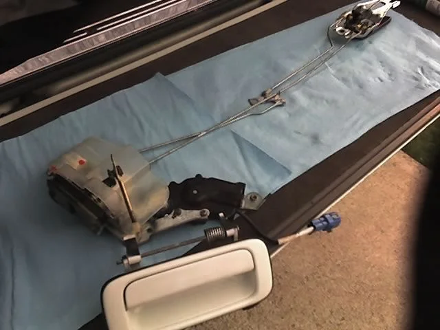

This thread had the best description of the repair and had pictures to help with understanding how the mechanism works.
attachment.php
(Sample image from the above thread)
