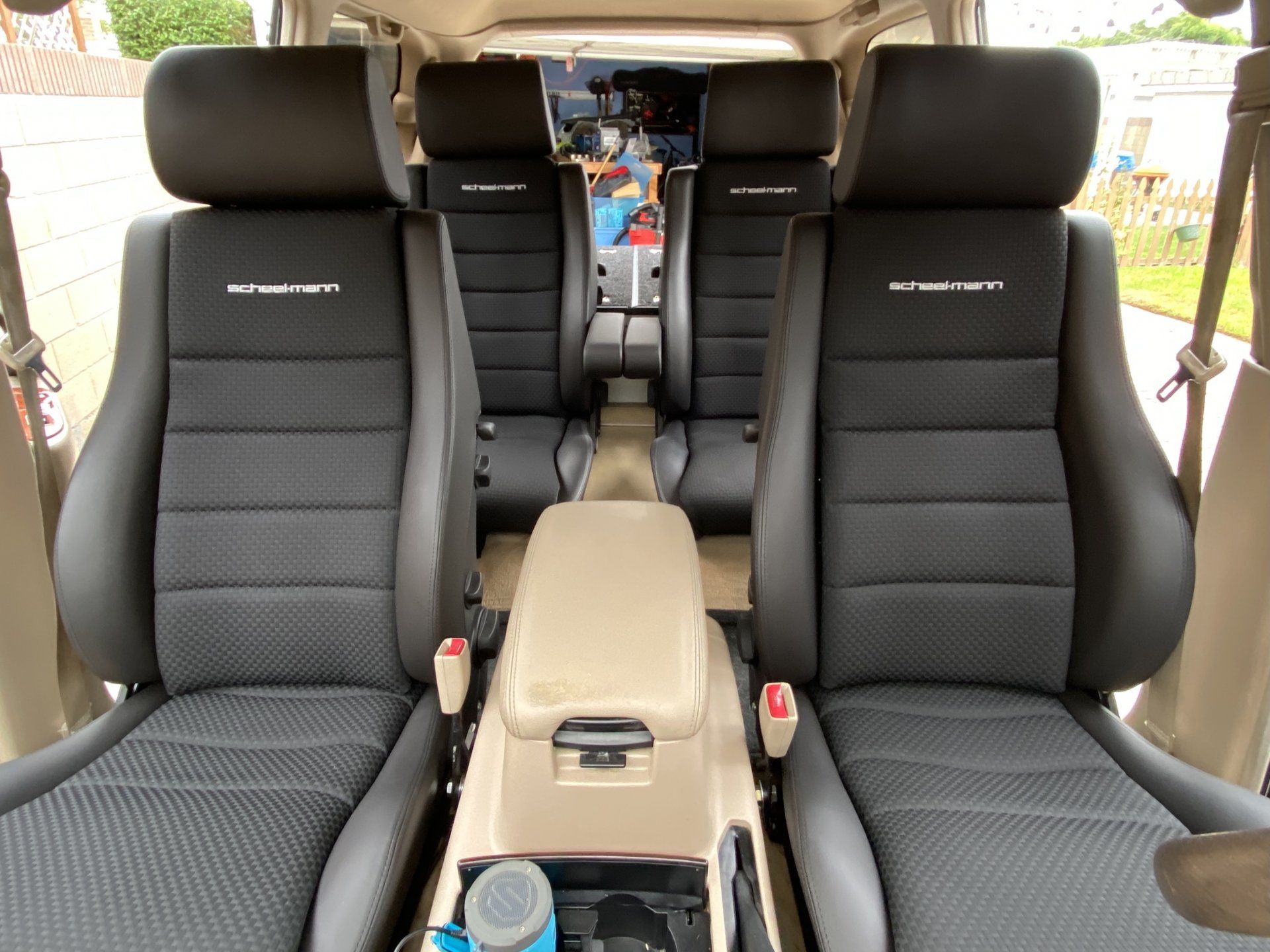

The Scheel Mann seats look nice and if there was a direct bolt in option for the middle row it would be more tempting but the cost of the seats and the custom brackets needed would be pretty high I would think.

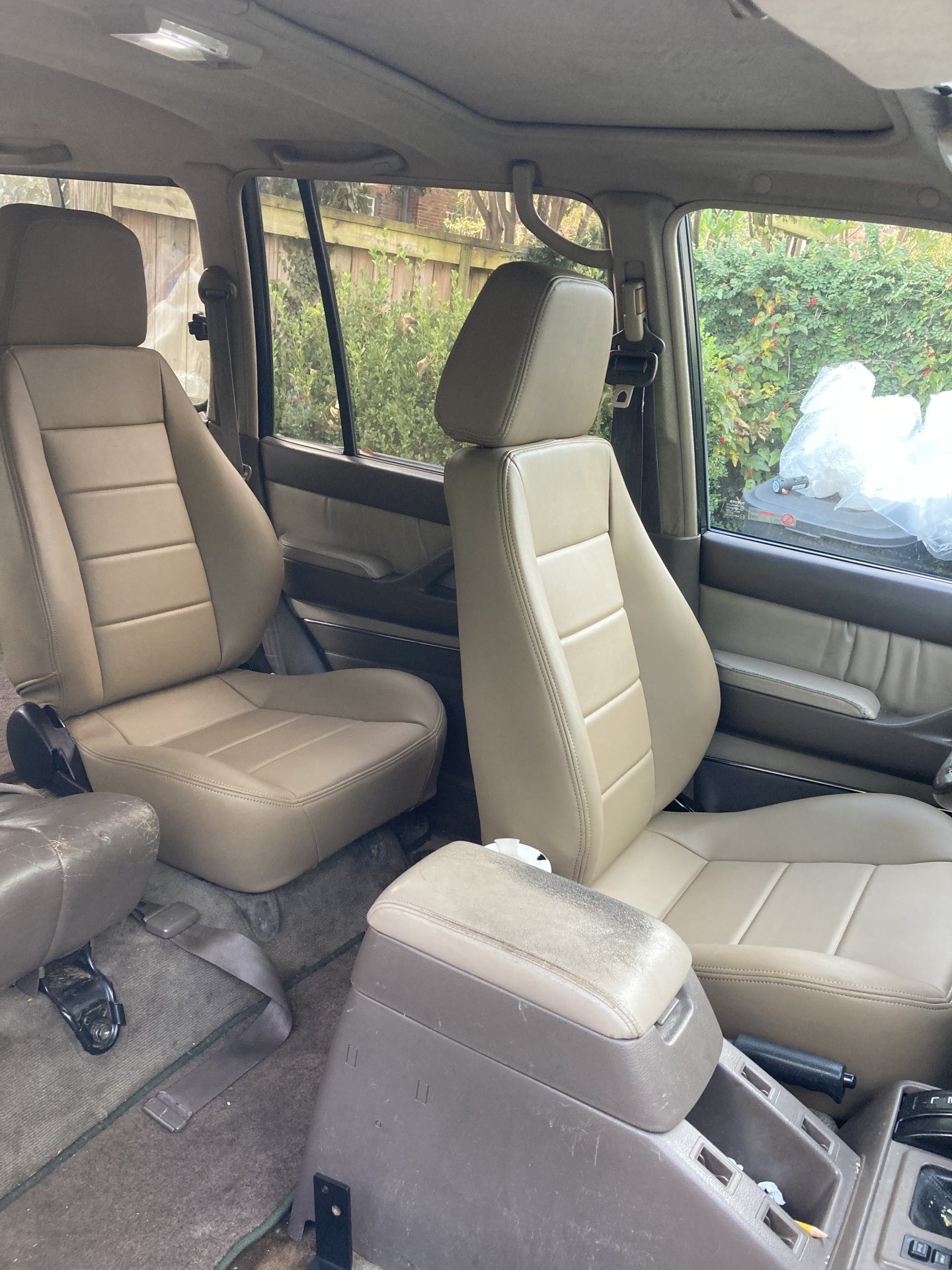

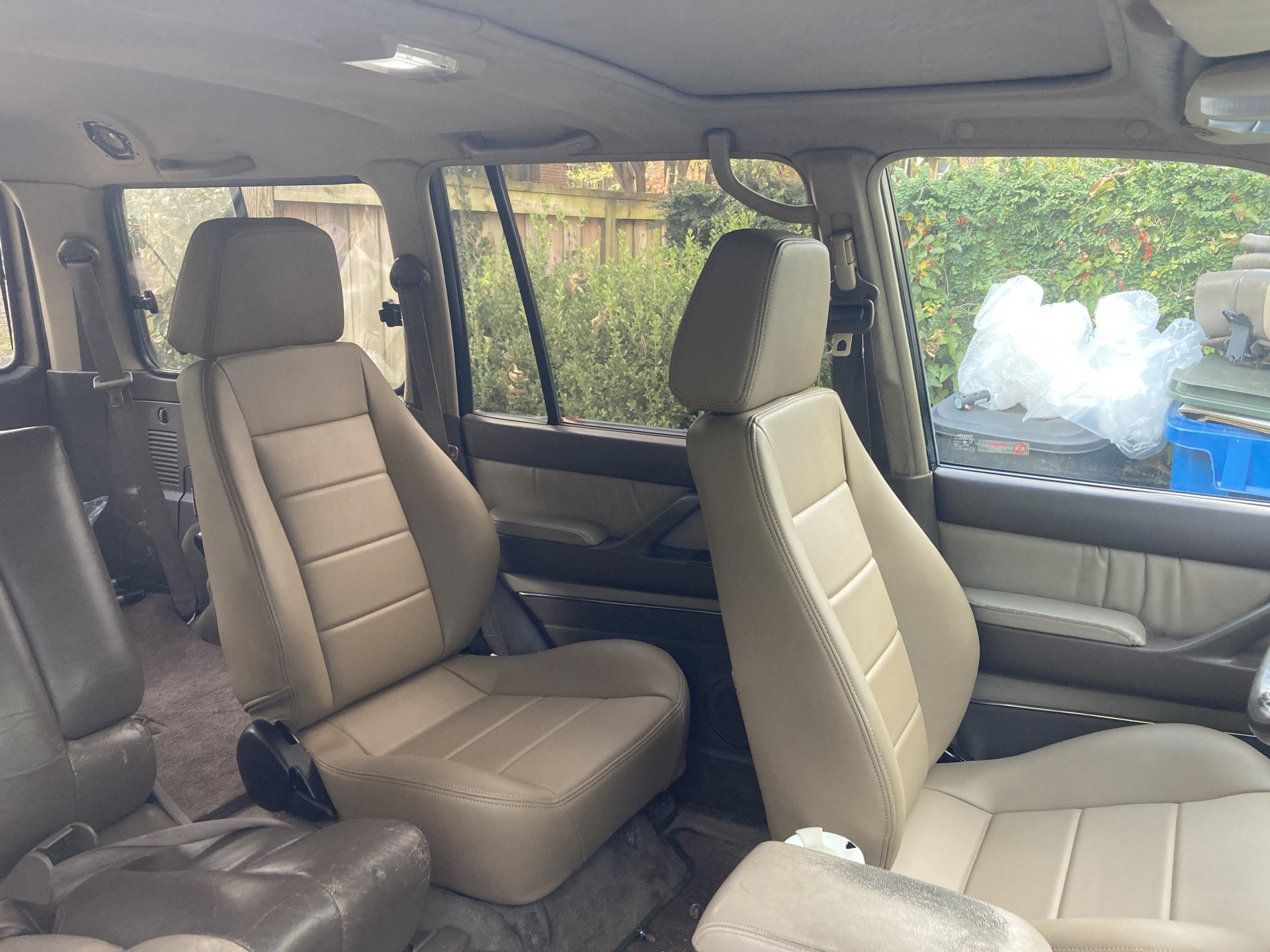

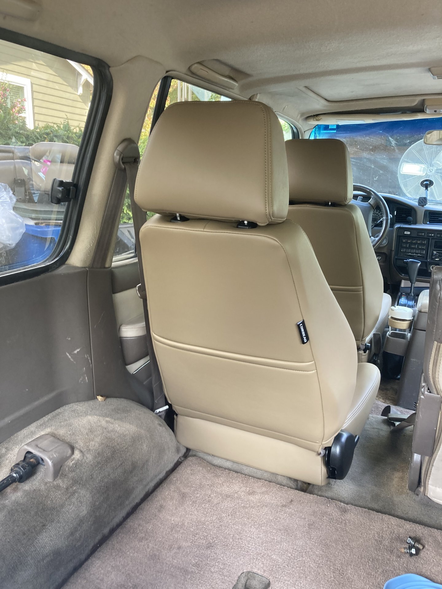

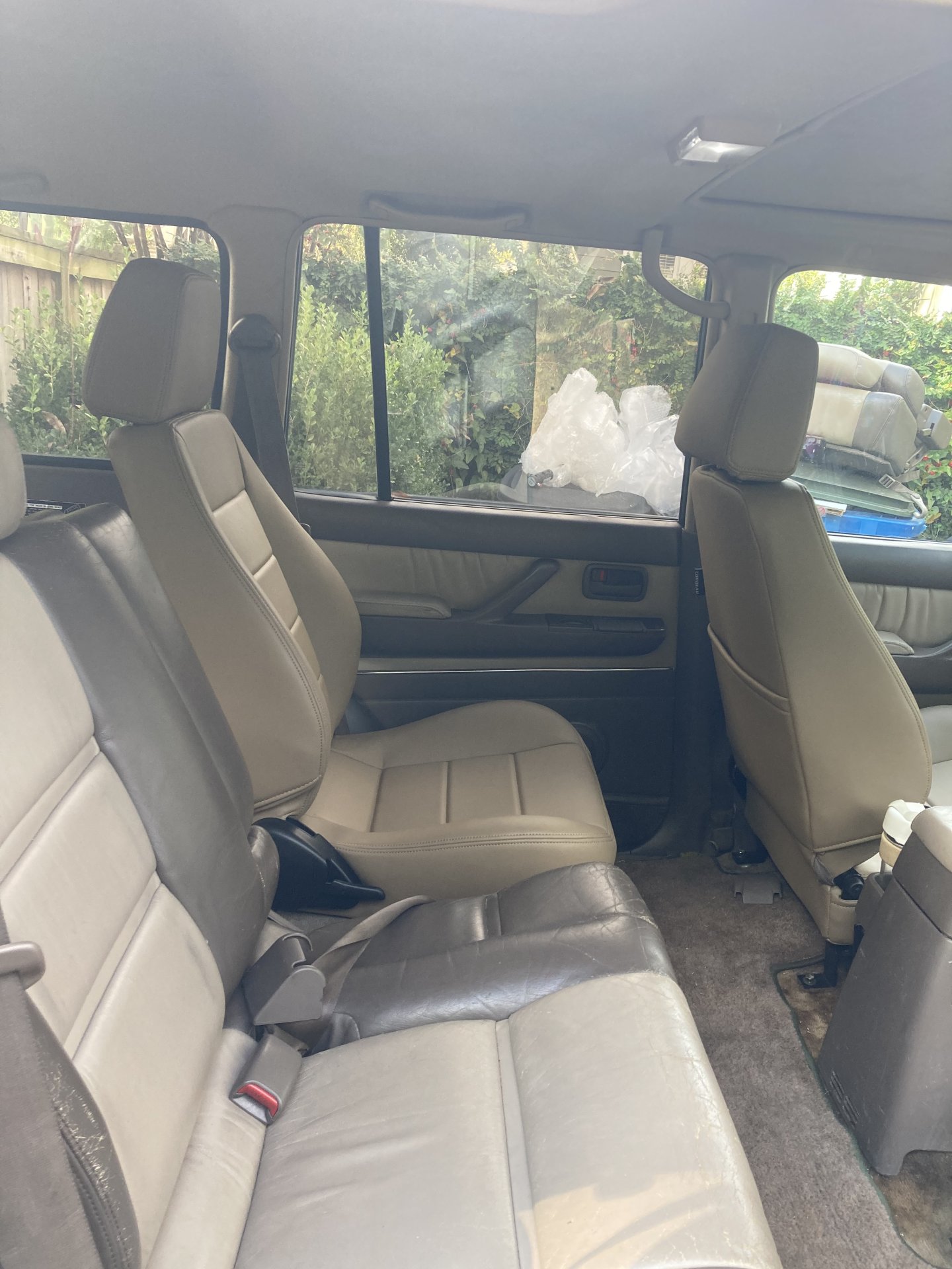

I was installing some Corbeau Sport seats so I pulled one of the rear seats to see how it would fit.
It actually fits pretty well. Plenty of headroom for me at 5’11” and the brackets would be simple to build.
Nice, thanks for the photos and taking the time to do that. Looks like a nice option. Do the corbeau seats have an integrated seat belt or the reciever to use the OEM belt? After doing quite a bit of looking in the 100 and 200 section, it seems like only 1 person actually followed through and switched these out to captains chairs. There are so many things to consider and account for when switching out the seats that are hard to predict the impact on functionality that I think most people end up staying with the OEM seats. I like the pass through idea but you loose the ability to fold the 2nd row seat forward with aftermarket options. I'll have to look into the corbeau options and prices. Thanks again.

Mine are Corbeau sport seats in Spice vinyl. The seatbelt was retained from the factory seat and bolted to the seat adapter. That is one complaint I have with them is that the seatbelt is fixed instead of moving with the seat.
If you were creative with the mounting bracket they would be easy to remove instead of folding. They are noticeably lighter than the factory seats so it be much easier.
