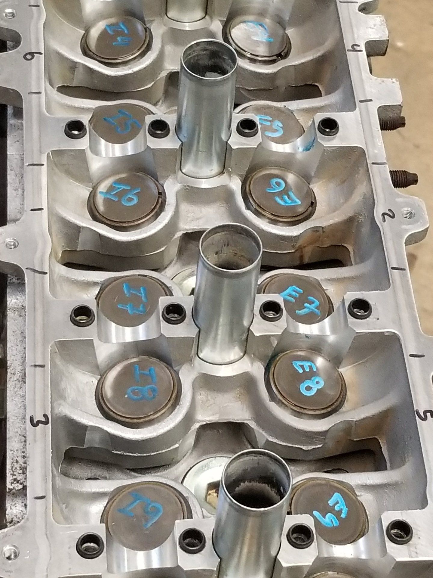

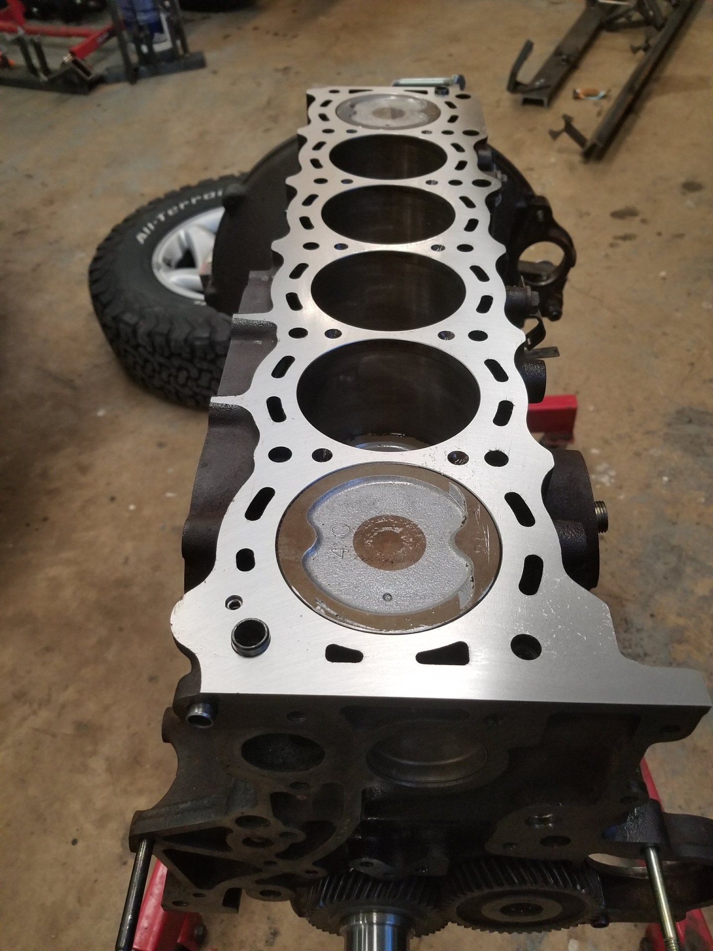

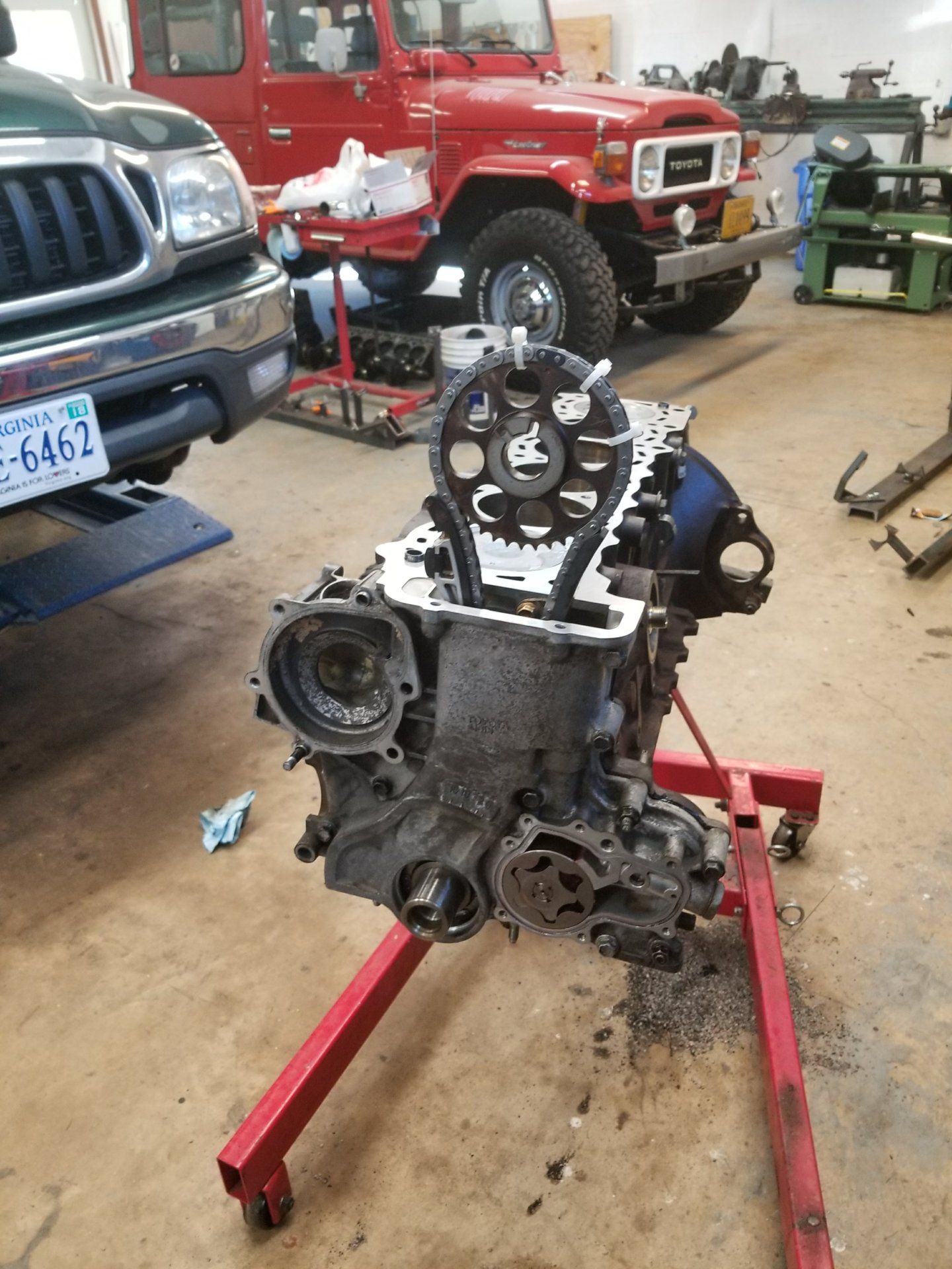

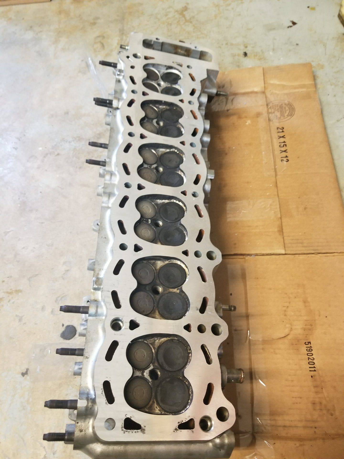

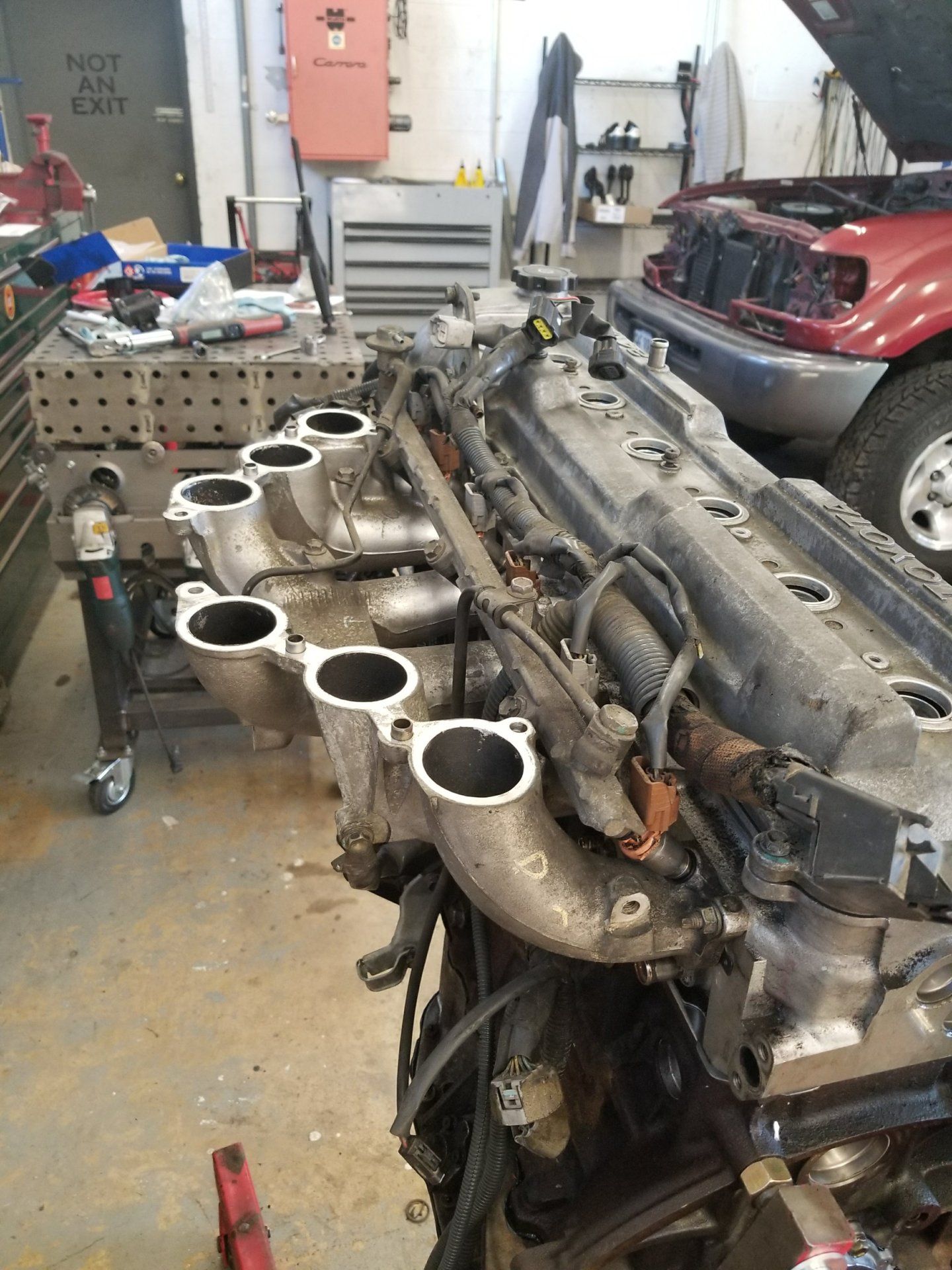

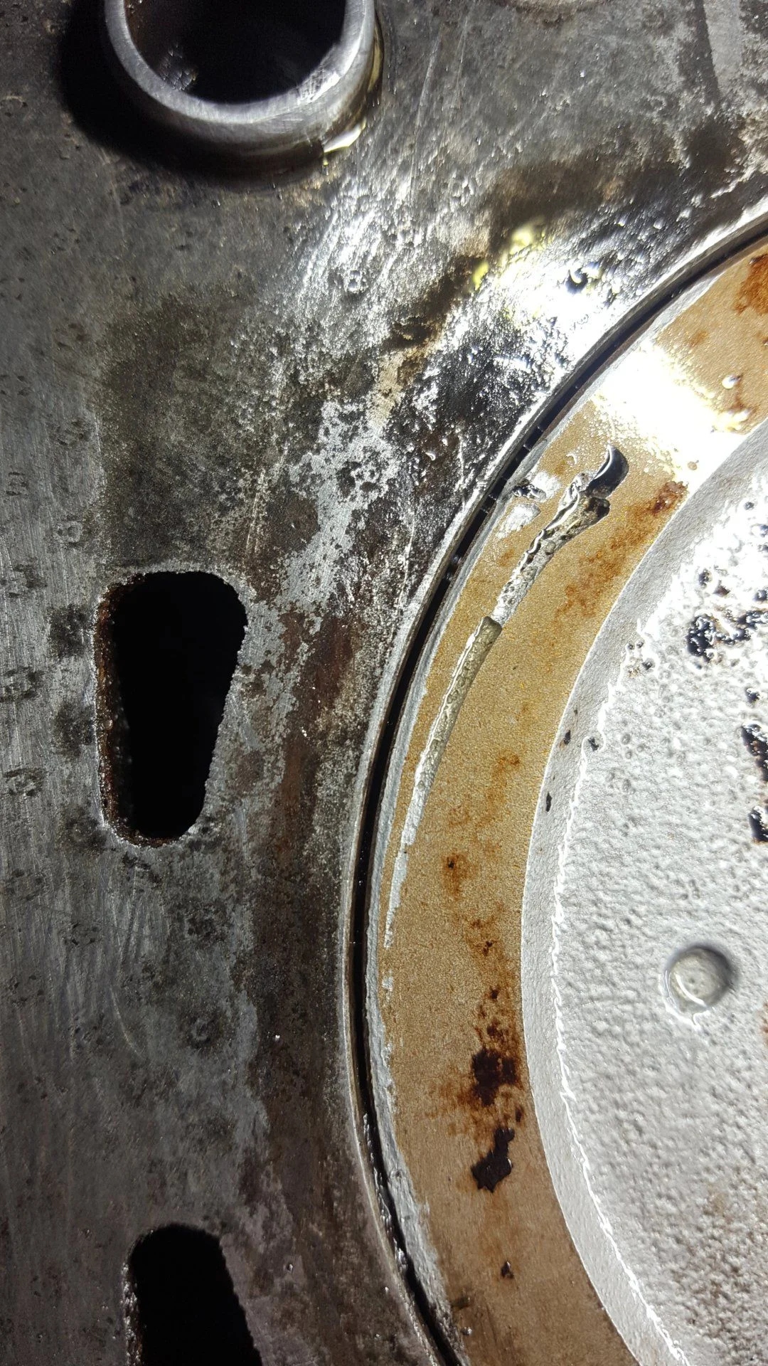

We had this 96 80 series come in just before the holidays with a blown head gasket. Got the head pulled off and found some deep pitting around the number one cylinder fire ring. And a simple head gasket turned in to pulling the block and stripping it to send to the machine shop for decking. Everything inside looked great so it just got cleaned up and reassembled.

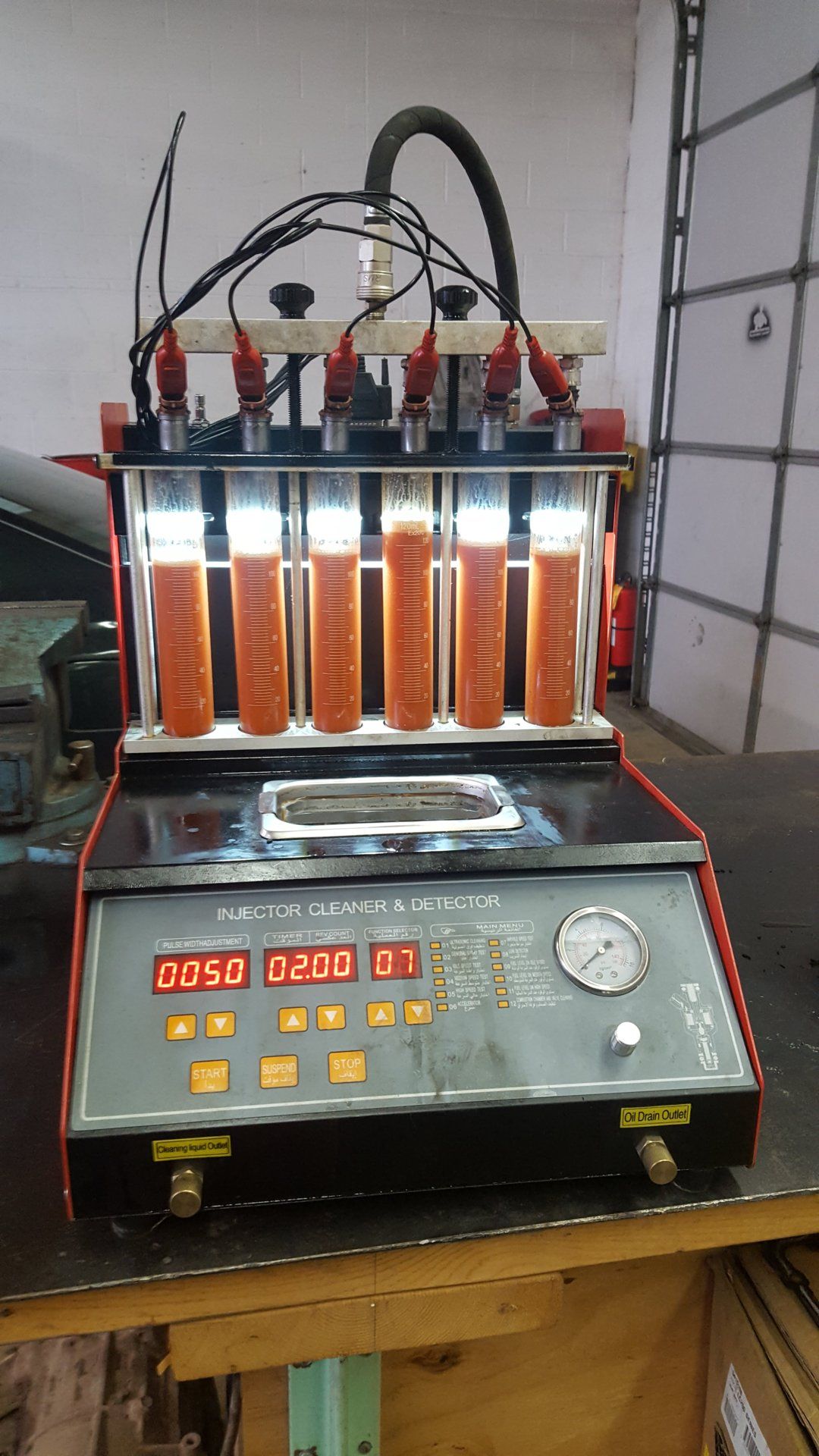

The injectors weren't bad off to begin with. It's hard to judge before and after on my rig beyond if they're all even. I need to find a more temperature stable fluid. The viscosity on the stuff I'm using changes enough with temperature that the volumes swing wildly with temp changes. I'll have to see if i can find the before pictures. They were on my old phone.
