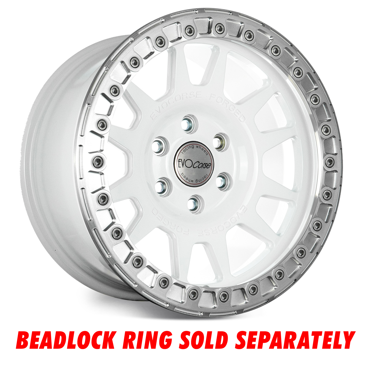

another really cool option you have in Europe is Evo Corse. They're in Italy. I wanted to get these but they were out of my budget:
Oh yeah wow shame on me. I live evocorse it’s our European powerhouse for high quality Offroad wheels and more.
The problem: the look with the evo is not as brutal as with yours. They looks amazing. Given the price difference the win on every aspect.
I asked the Italians if at some time they are also producing a fully machined one. Here we say: questions do cost nothing.
But see the huge difference yourself
