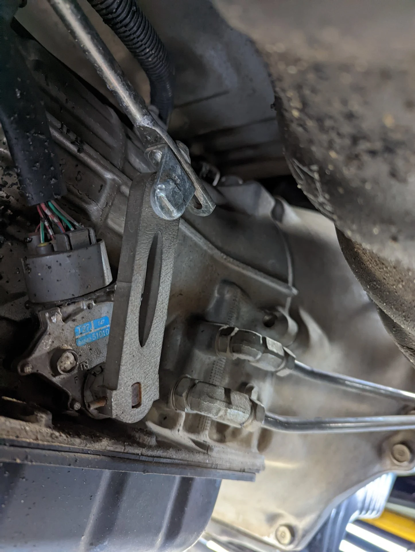

A custom linkage lever added to the right hand side of the trans

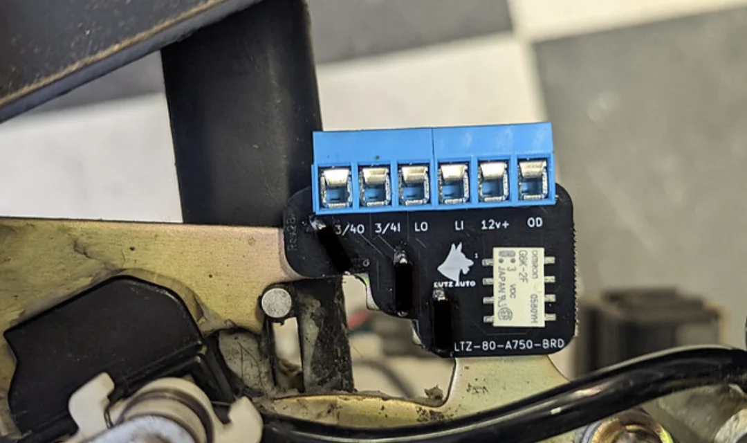

A circuit board to connect it electronically

I just wanted to update this thread with a link to the final product kit. The shifter board is almost plug and play. It requires splicing into the o/d button wires, but the factory connector gets most of the work done.
