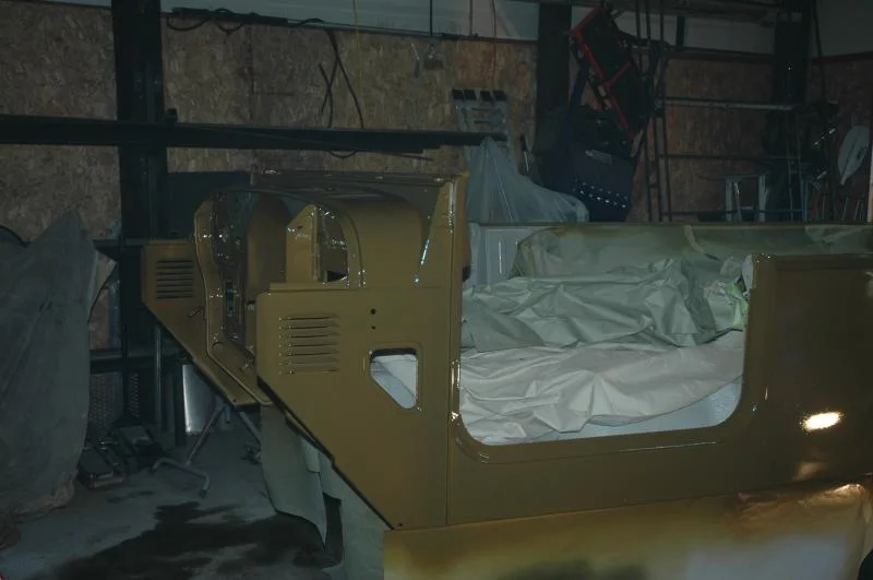

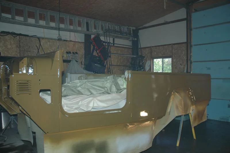

I've been working on my troopie from OZ that turned into a full frame off restoration. It's amazing how much time it takes to complete each step along the way. I take my hat off to the guys that do this full time. Definetely a labor of love. After fixing the tub, steel patch panels, body work, straighting the body, a full coat of epoxy primer, and a sprayed in bedliner inside and the underside it was time to sand some more. Two coats of high build epoxy primer and then 400 and 600 wet sanding it was time for the ole' 653 OEM Olive Green. Five coats later and then two coats of clear she is looking pretty good. Time for more patch panels in the roof, and pretty much every corner of the side panels and doors.
Here are several recent pictures from this last Friday.

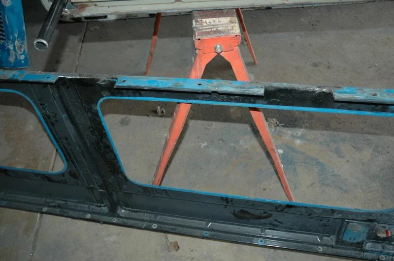

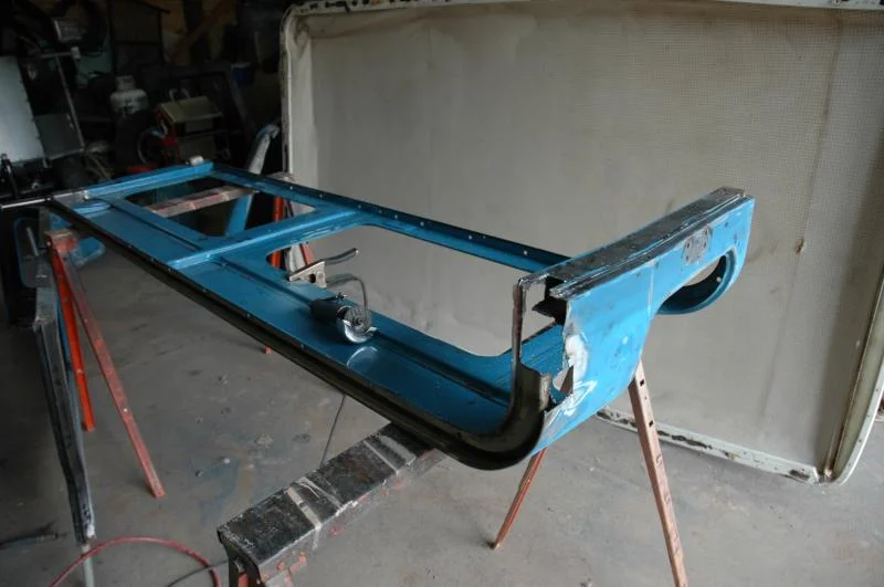

Here are several photos of the side panel rot!!! The b pillar 1 inch support and side is gone, replaced, and then the c pillar end is replaced too along with several splices on the top where the roof rests. I'll post more tonight of the somewhat completed welding.
Peter
