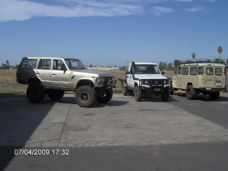

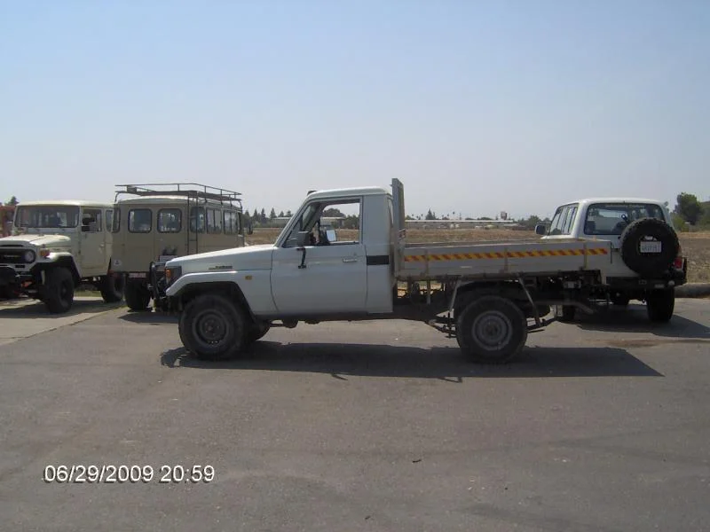

i rarely get to work on any 70 series rigs although i just finished a 13BT/h55f swap on a customers' fj60. but right now i have a 79 pickup at the shop and one of the things the customer requested was a mild lift. so i got an ome kit for it. simple install, turned out well and rides really nice.
the toughest part was finding some wheels for it. the owner did not want to keep running his split rims and none of the rims from the dealer had the proper back spacing. so we finally had to settle on some procomp wheels. they will be powder-coated flat black in the near future.
i'm gonna be sad to see this truck go back to it's rightful home.....:frown:
but i've had a great time working on it, that's for sure.

it is an aussie truck.
the 100 series rims will not work, waaaaay too much back-spacing. i have a set of LX470 rims off a 2001 at the shop. they have about 6.5" of back spacing. the ones on the truck are 4" back spacing and they work perfect. any more and they'll hit the calipers or the tie rod right where they attach to the steering arms.

Looks like your have a few nice projects going on mate,I think those rims are awsum looking im not to sure about them in flat back though 2 mates have the pro comps on there 79 series and they have front center caps to ,ones that unclip at the end to do your hubs , Aus dosnt seem to be running out of the procomp rims.
rosco when i first seen the pic i thought it looked suspicioulsy aus spec ;)
Its the mirrors, tray and factory snorkle. :D I dont think the bullbar is Toyota,more ARB

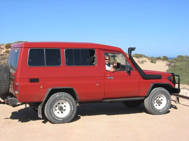

My first 70 series was a 75 series 87 troopy with the 2H , that bus was awesome. It was red with the grey interior. At that time it was incredibly rare colour. Nearly all 70 series in Aus then were white with the occasional tan one, Excellent 4wd with the 2H, I did over 470,000 KMS, sold it, and still saw it driving around years later......still miss it:crybaby:
