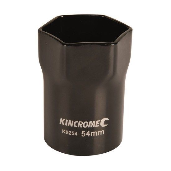

Trying to find out what size socket to use to remove the very large nuts that hold the front hub and rotor assembly onto the spindle for a 1993 PZJ75.
One sight says the socket might be 54 mm.... Anyone know for sure ?
This looks like a socket that I should have for future repairs.
Thanks...
Yes 54mm. I use one of these, not too bad for the price .
