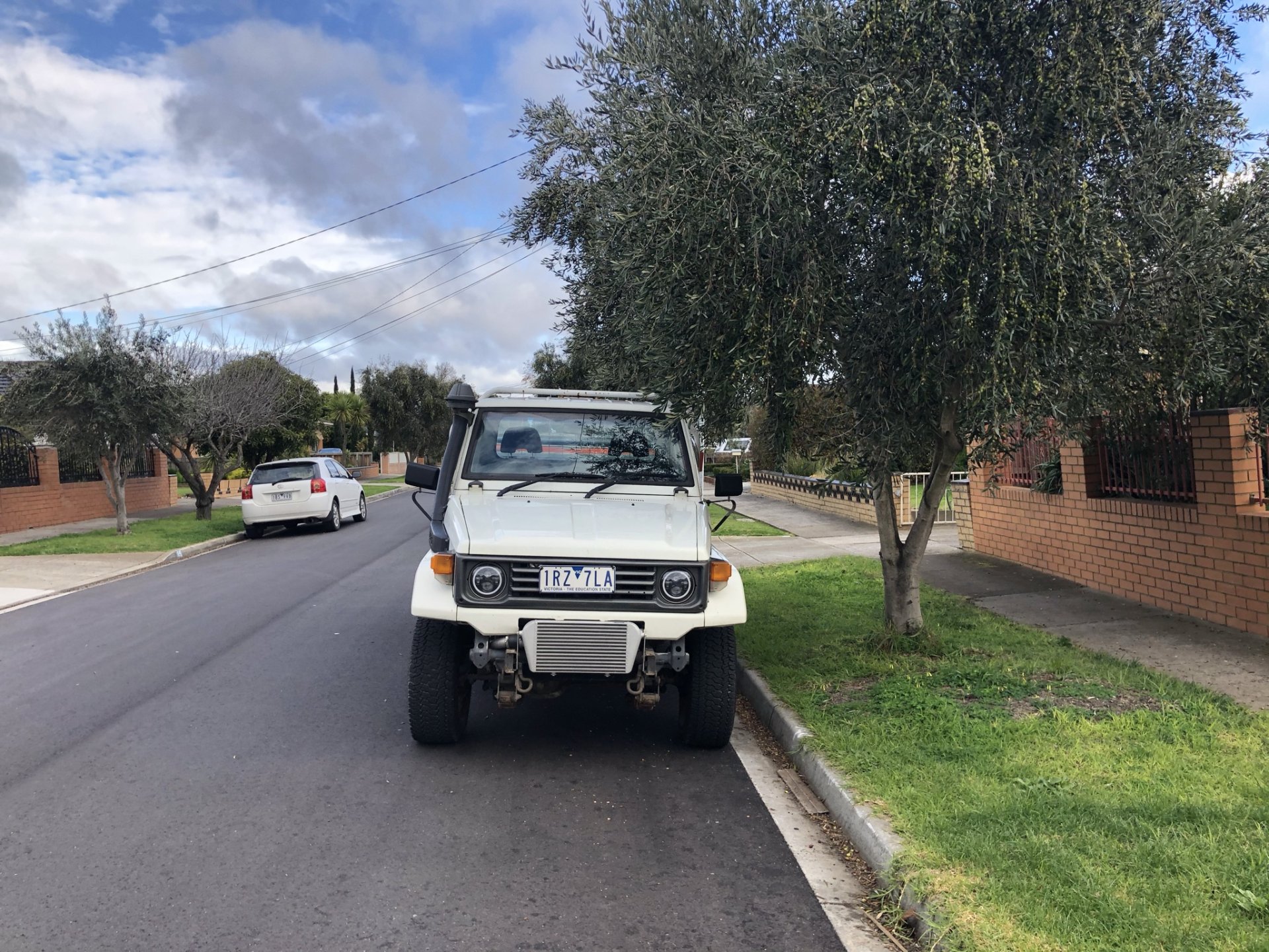

Full build pics in the thread “PZJ70 refresh rebuild”, I did the conversion a few years ago. @Loober has also done it and documented his work in his thread.
