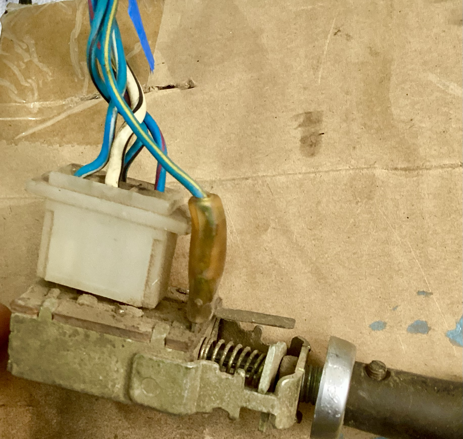

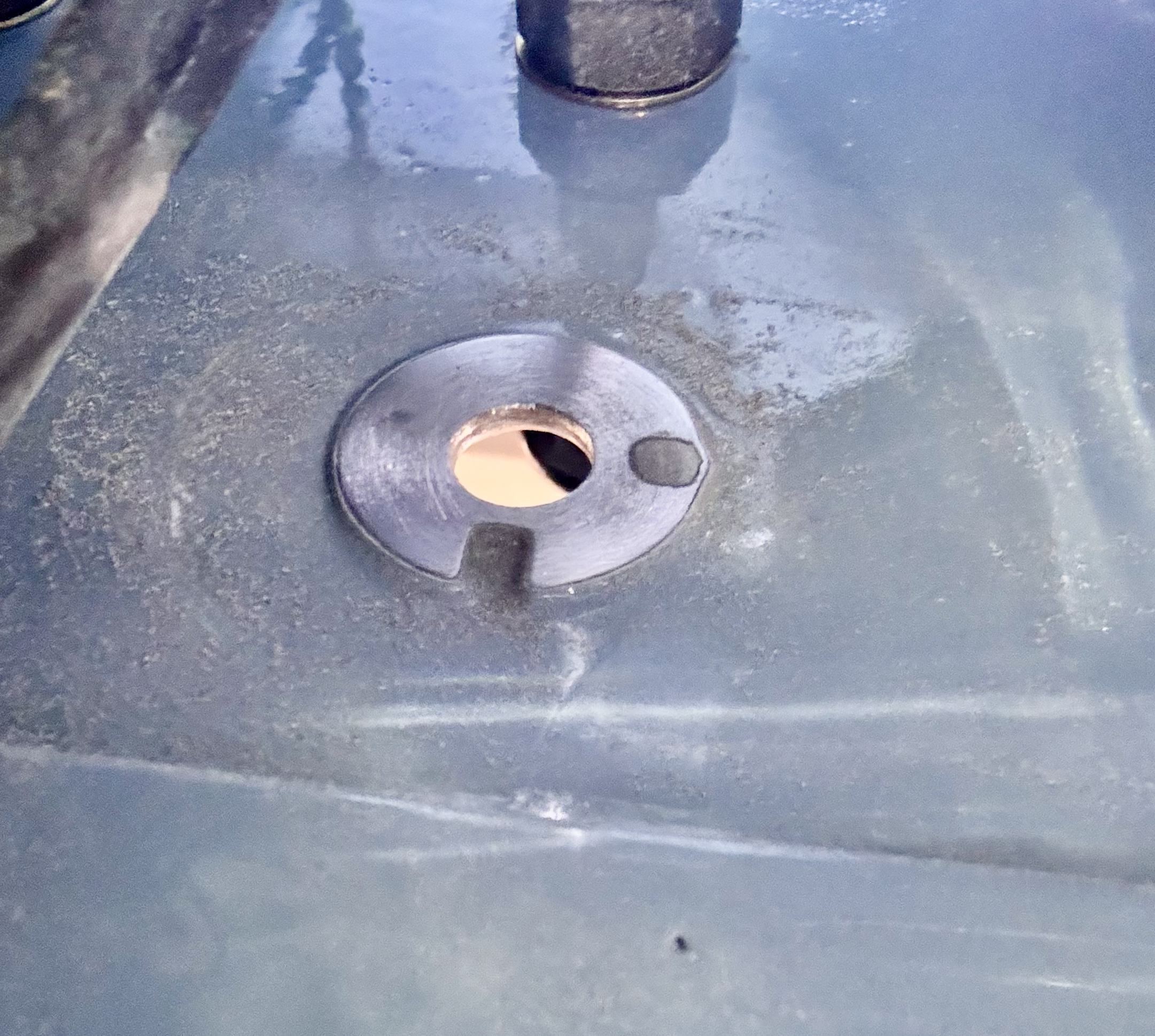

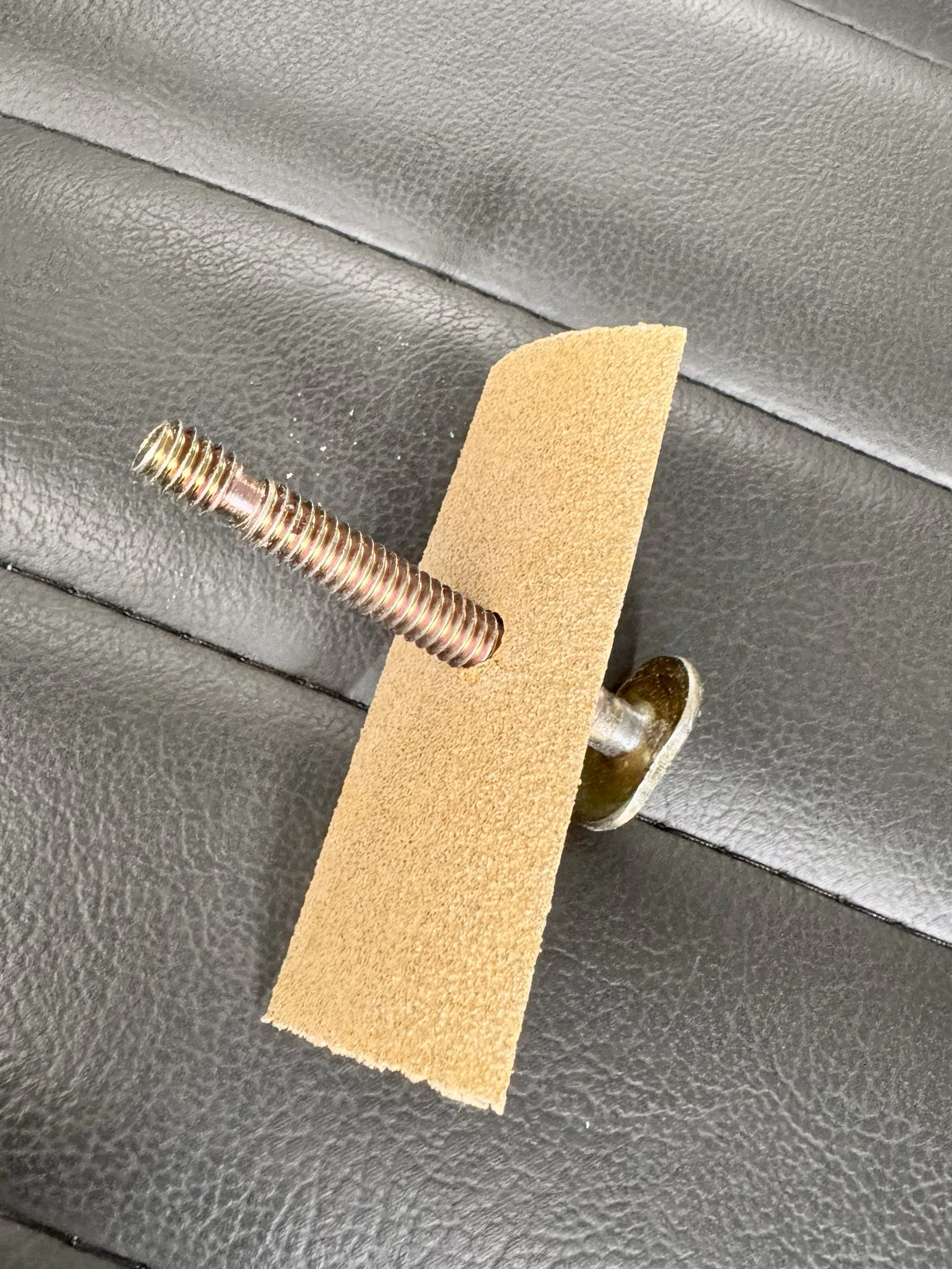

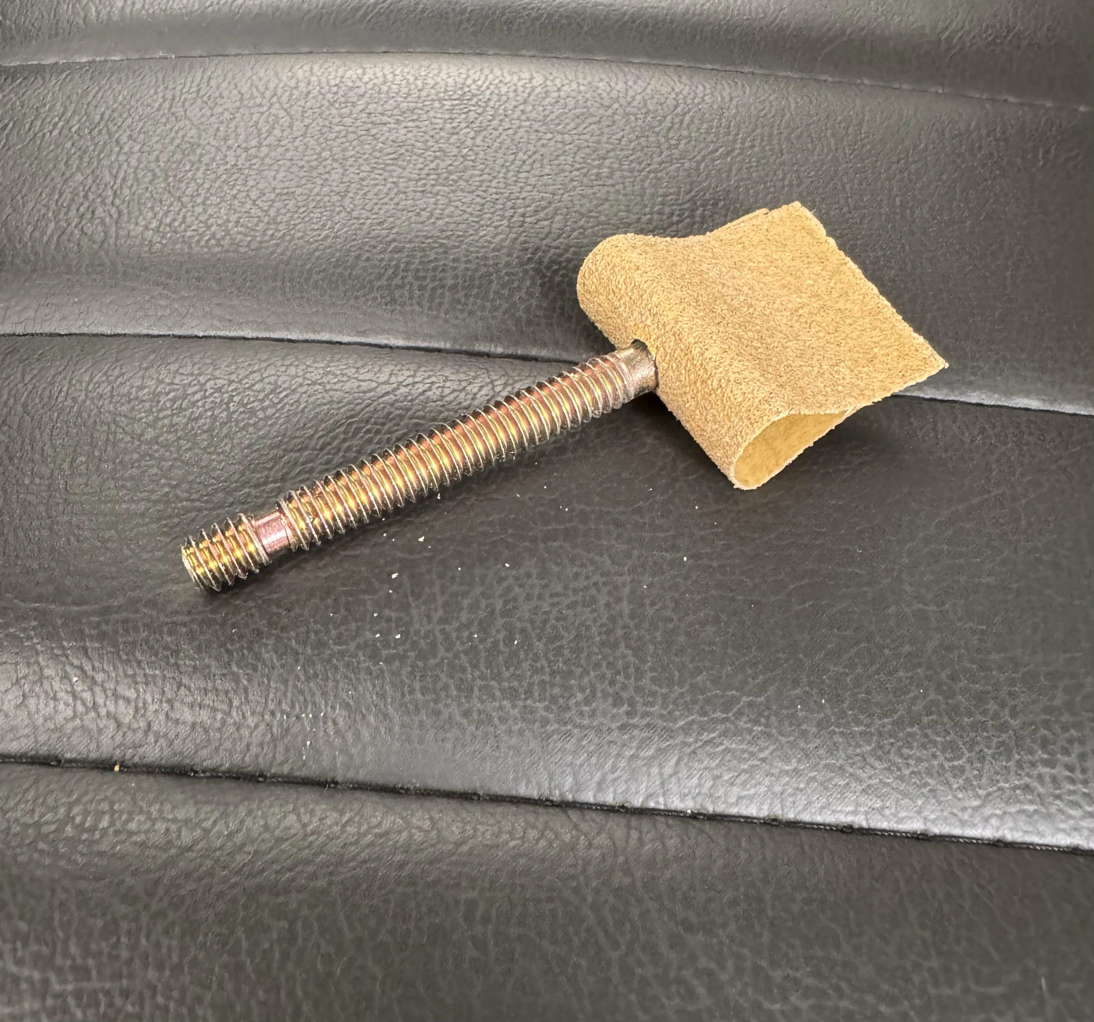

This is where my issue was: when I painted the body, I was proud of myself for getting a good, thick coating of epoxy primer and paint over every nook and cranny including the back side of the dash: the switch was not grounded.
here is how it looked from behind the dash ( I had already started trying to remove the paint at this point)

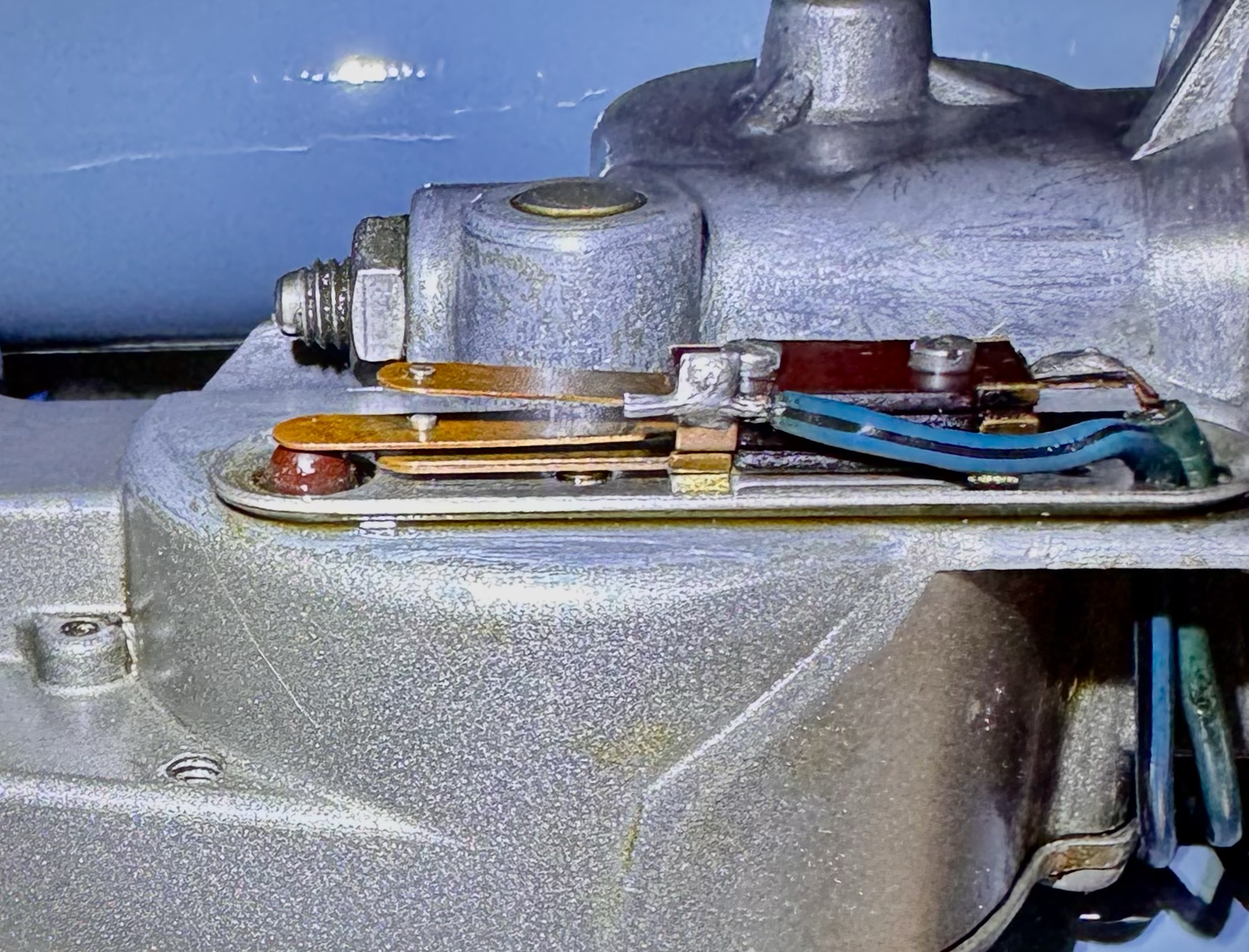

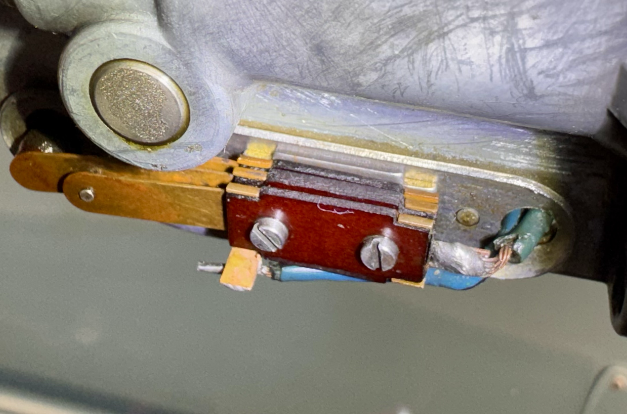

There are 3 insulation plates and 1 metal plate - the order is critical as well as the spacing of the arms. Hard to see but next to the housing is the metal plate, followed by a short arm with thin insulator. Next is the long arm with a thick insulator. Finally, another short arm with thin insulator.
here you can see the switch while the wipers are functioning: the plunger is down and the bottom/ middle plates are touching.
in the second picture, you can see the plunger protruding up, pushing the middle plate up, contacting the upper plate and 'parking' the wipers
