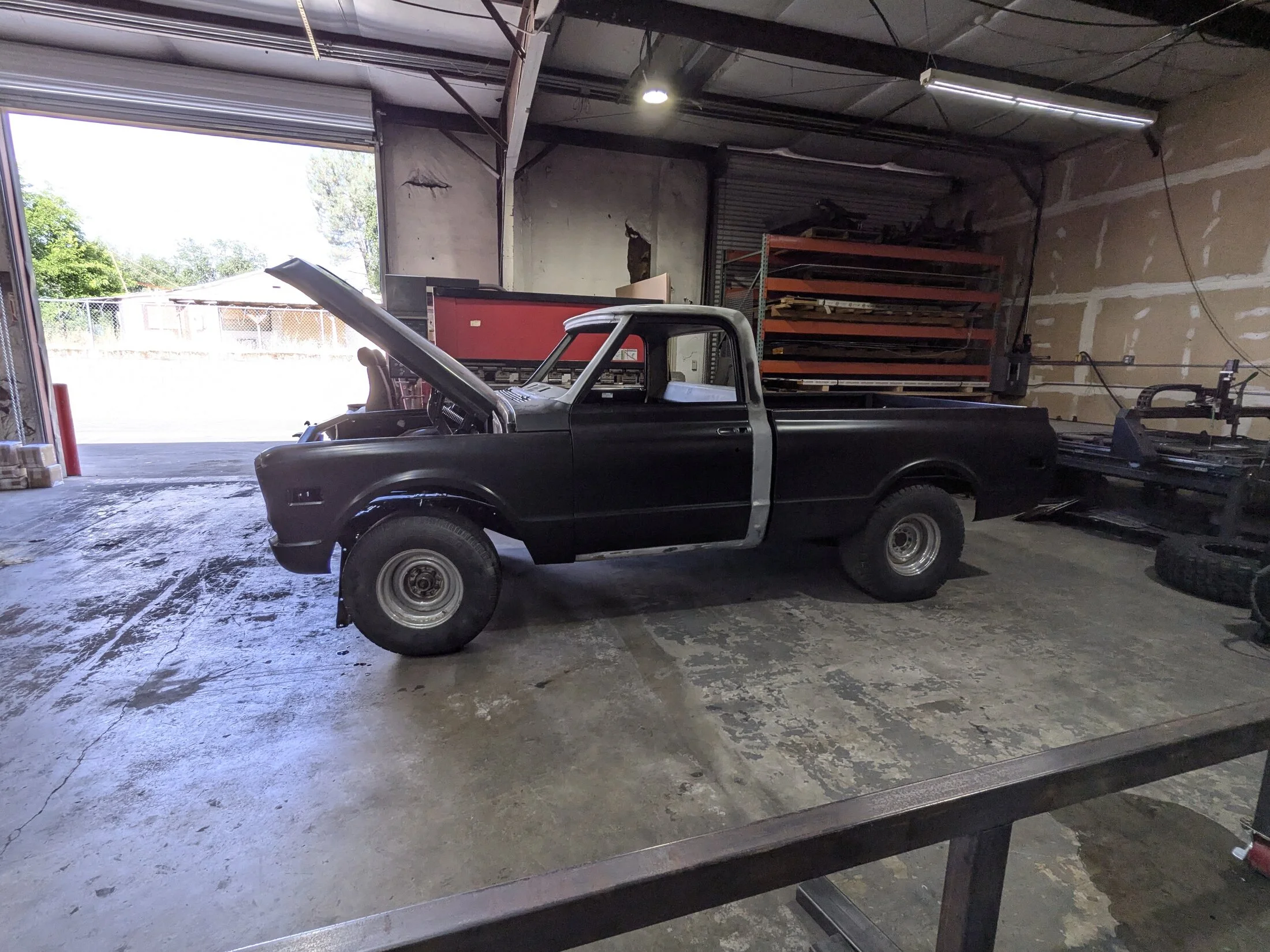

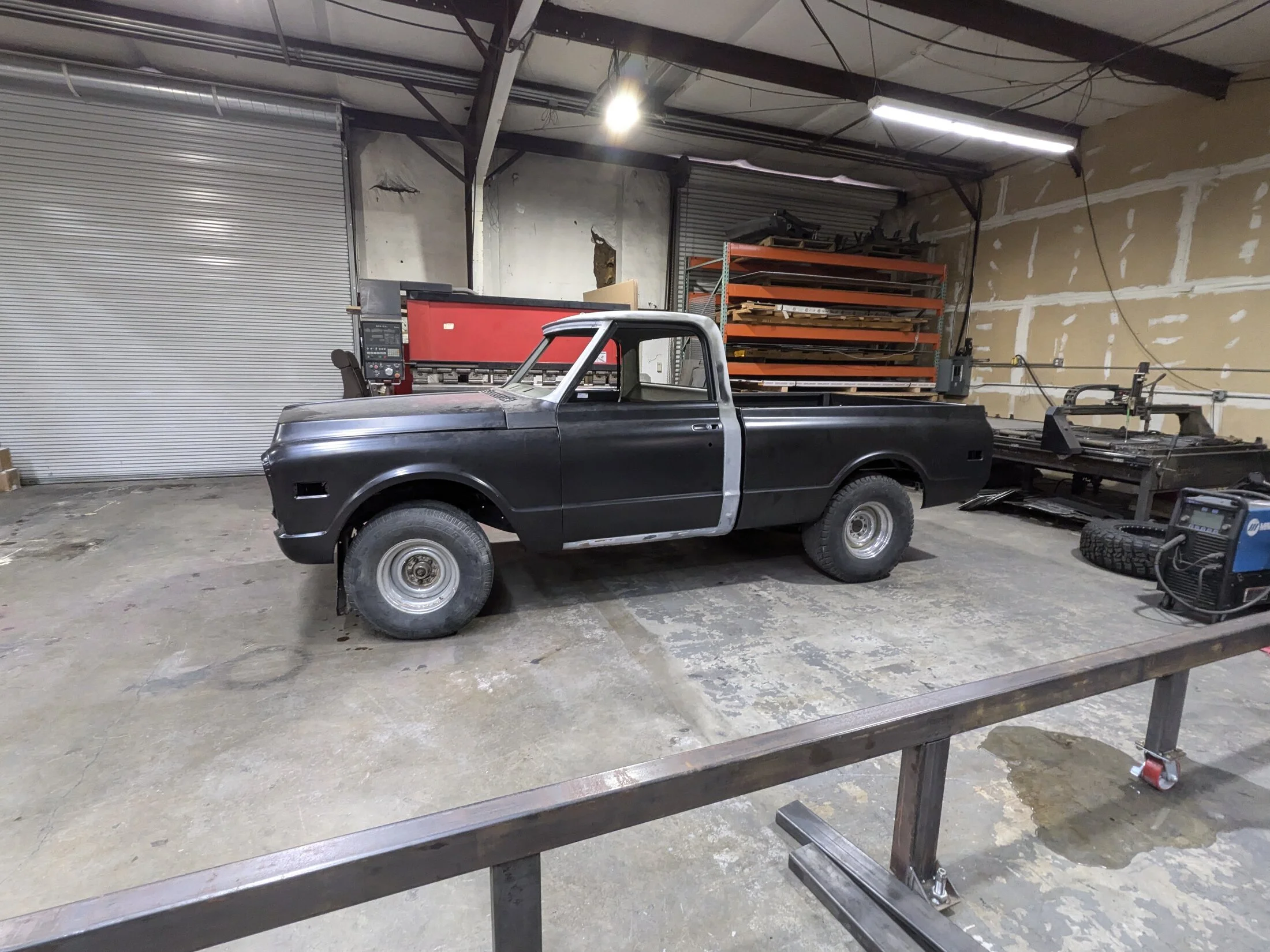

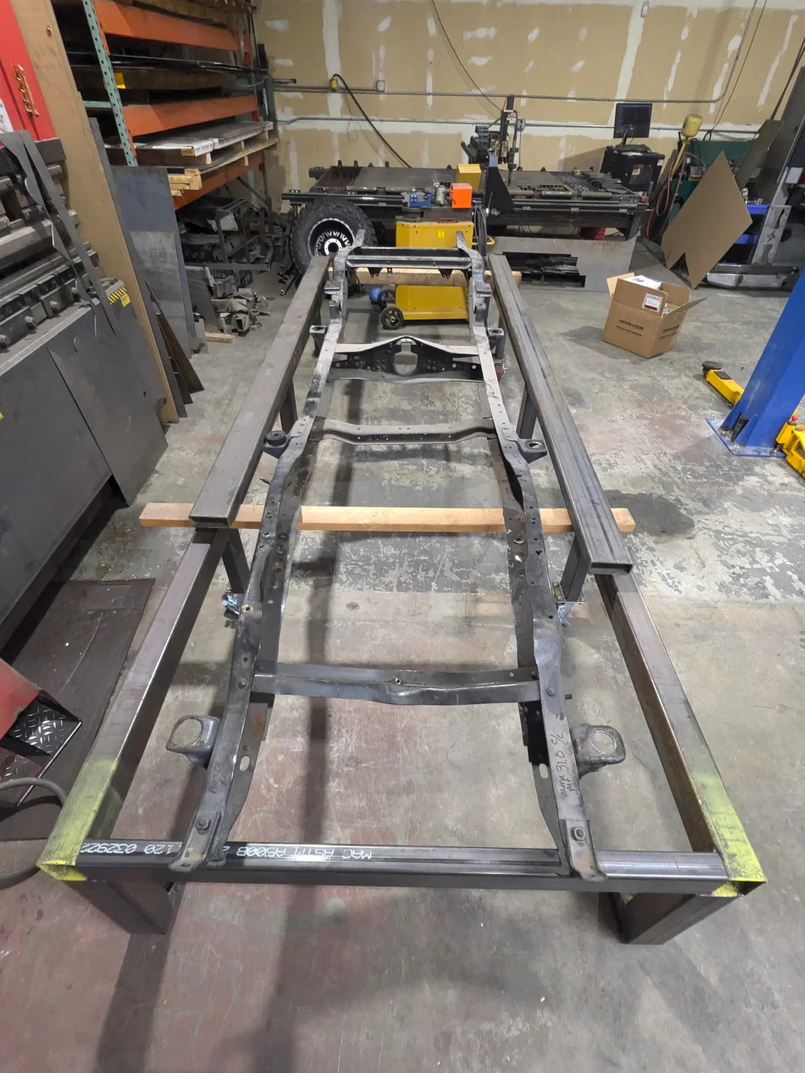

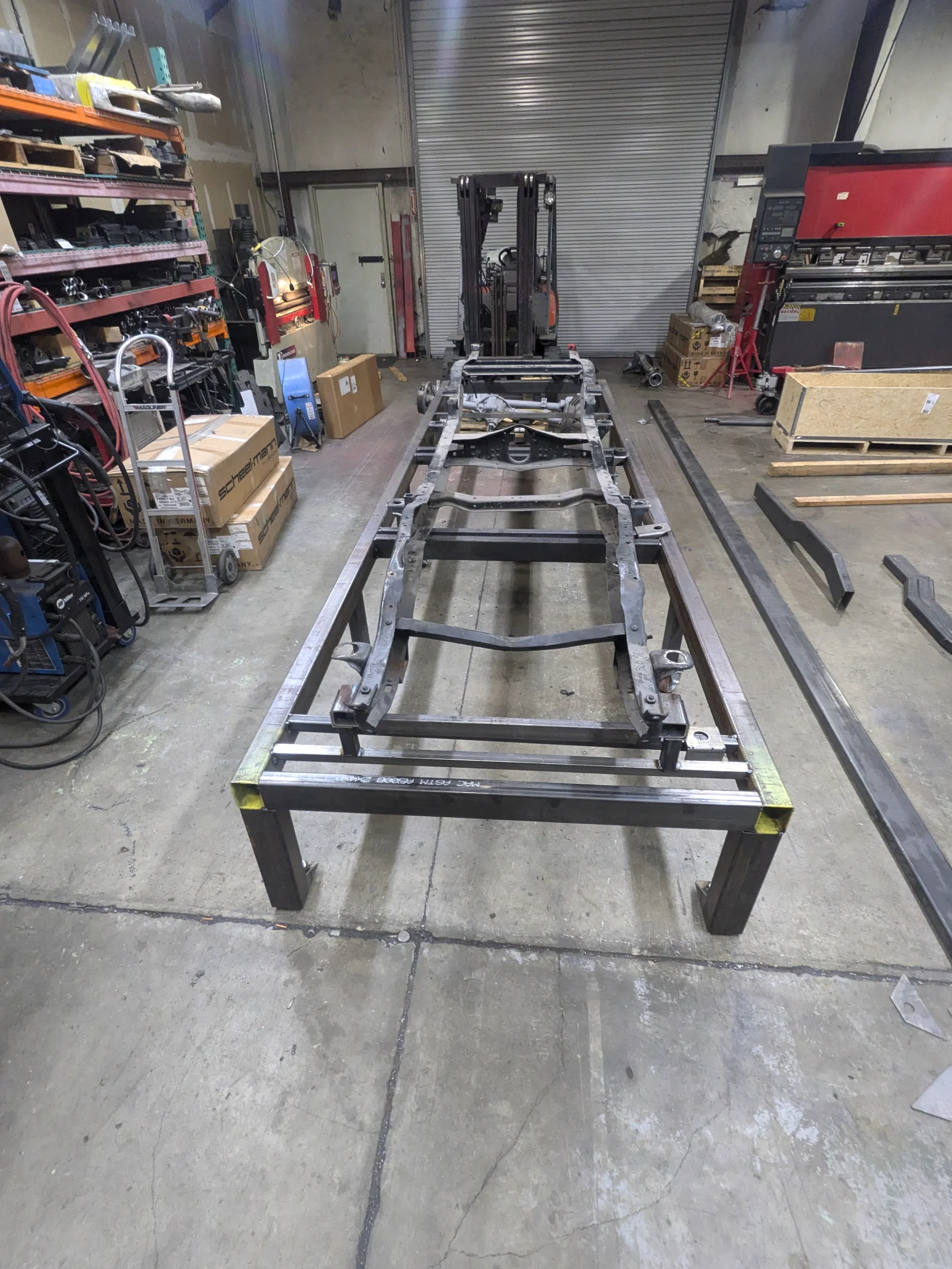

1971 Chevrolet C10 to K10 build
Will be build a custom chassis for this build. 4 Link front and rear with coilovers.

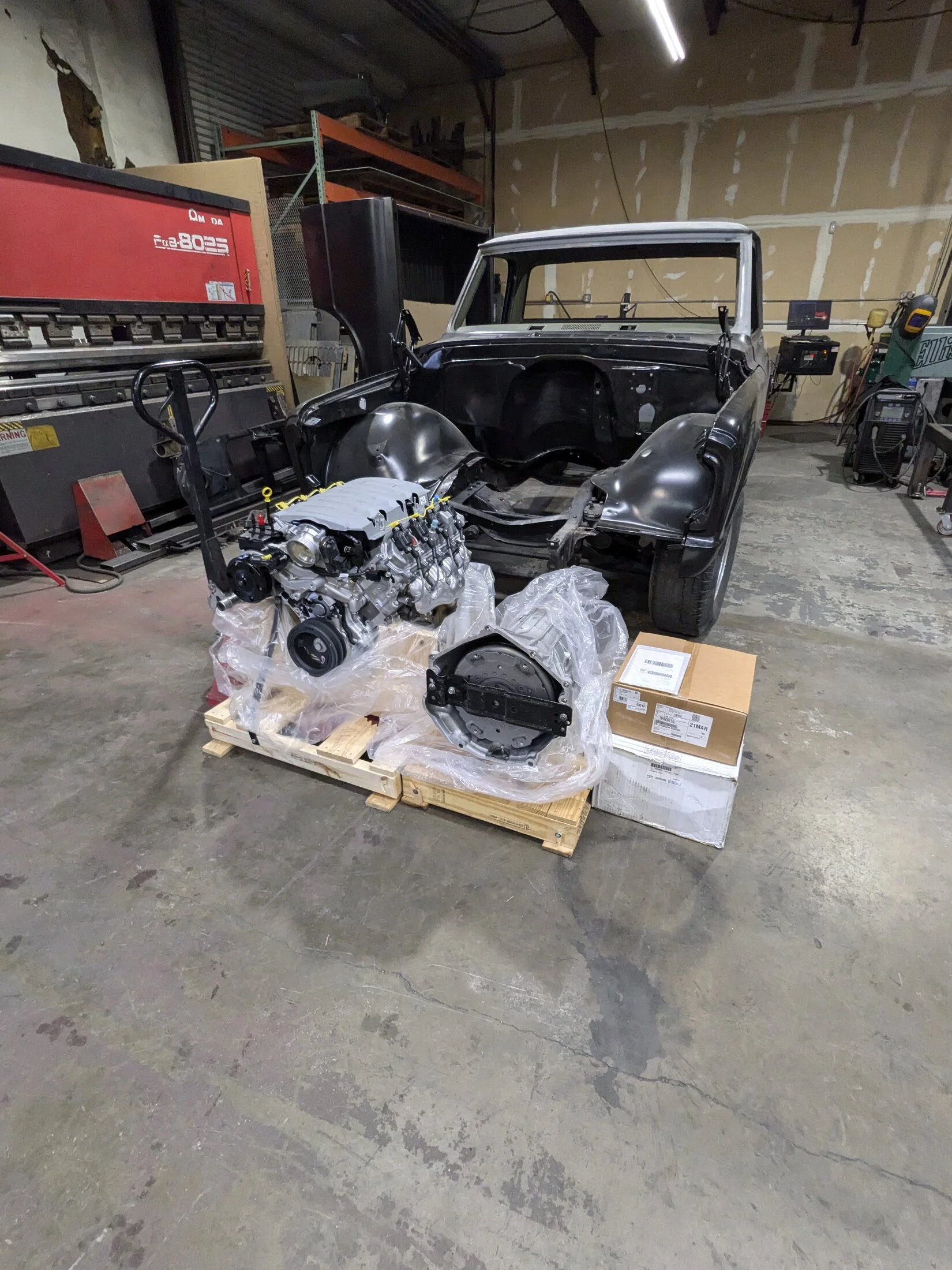

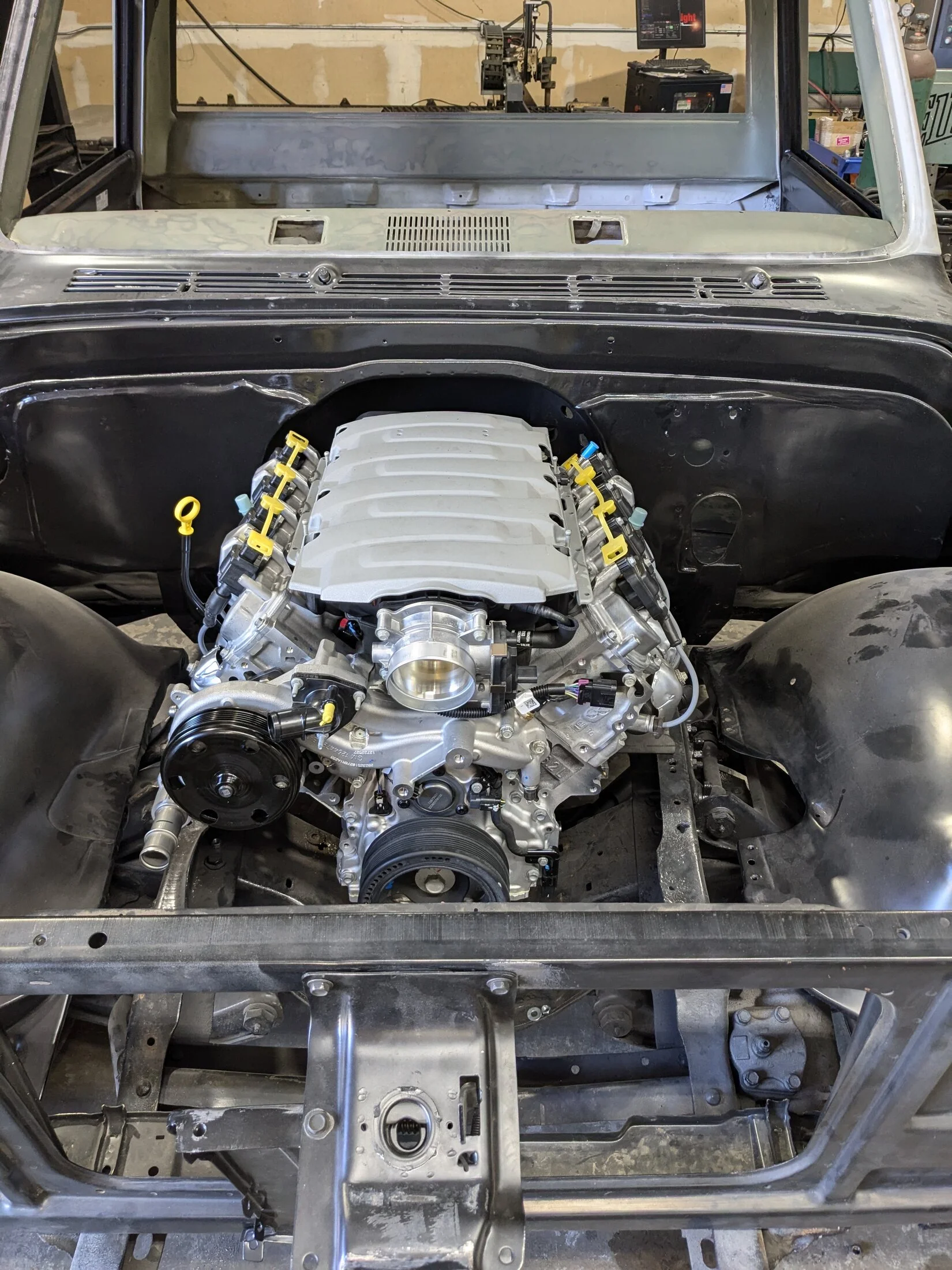

LT1, 10L90E and Atlas
Dana 44 and Dana 60 axles with 3.73 gearing
20 gallon aluminum tank
Custom color two tone paint
Plethora of mods

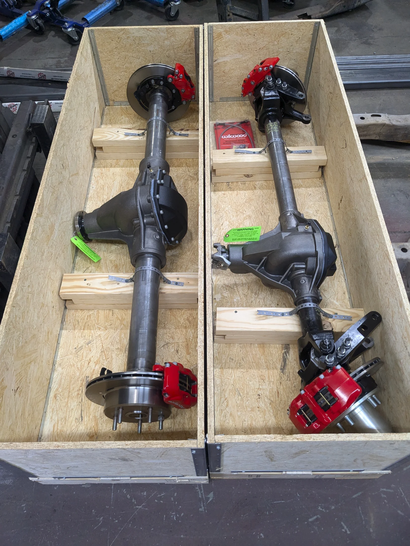

Axles are ordered from ECGS along with other parts.
Dana 44 front and Dana 60 rear, 3.73 gears Eaton TruTrac and 4340 axle shafts. Wilwood discs on all corners.
Fox 2.5" coilovers with remote resi
Atlas T-case is in production
TK1 Racing sway bars
3.0L inverted Whipple charger and secondary IC
Wegners accessory drive
Restomod AC/Heat system
Ididit column
20 gallon Boyd's aluminum tank
ALL parts are in production or enroute now.

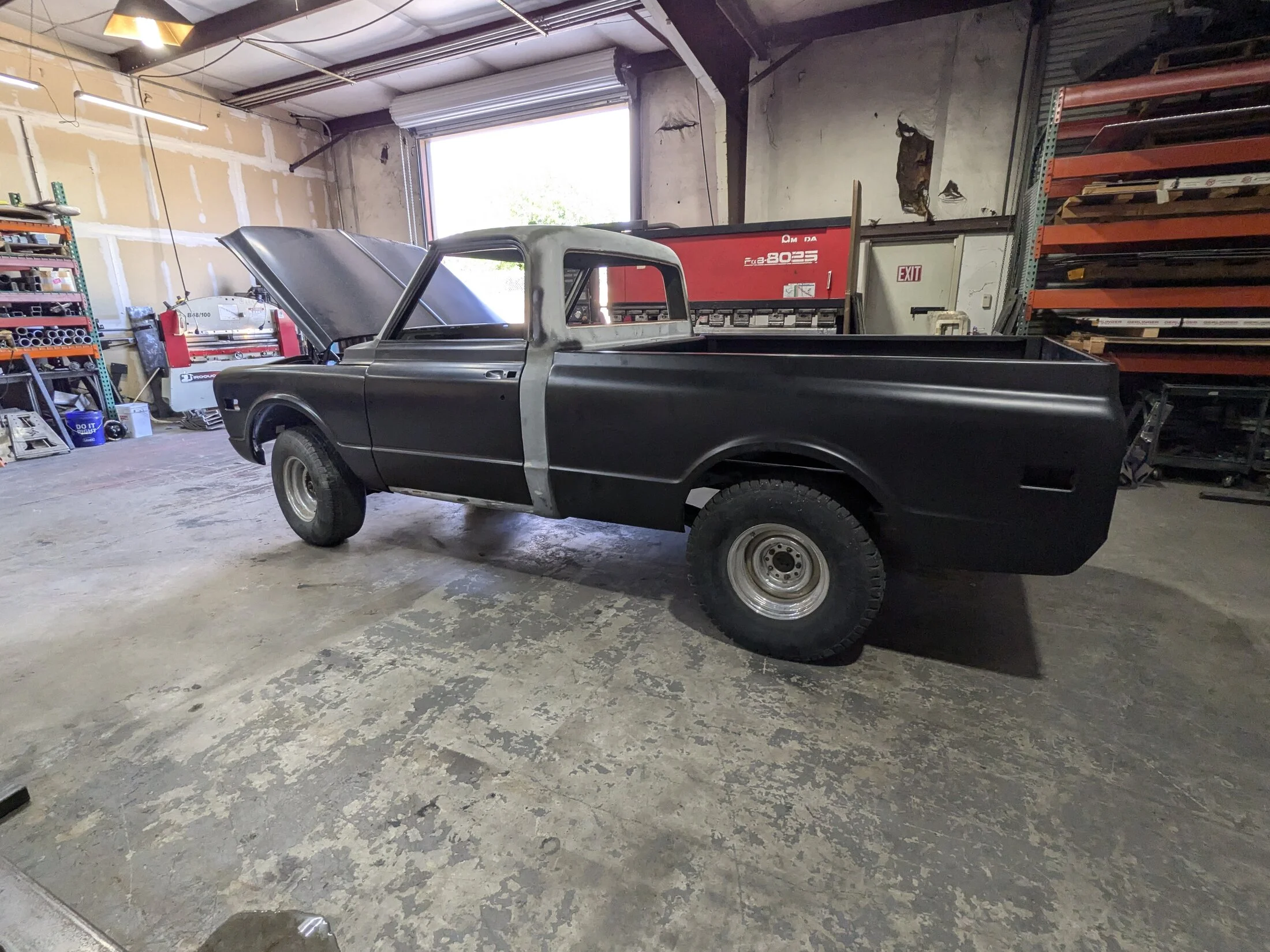

Bed is completely new aftermarket steel, but decided to go with a wood bed. Ordered the crossrails and rear sill. Wood kit is on order.
Black walnut and hidden hardware. Will finish in a gloss finish.
Will dismantle bed and start putting it back together.
Should be back on the chassis in a week or two.

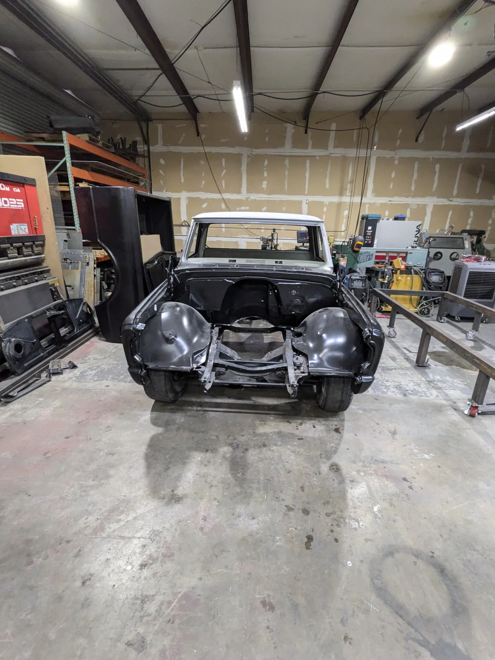

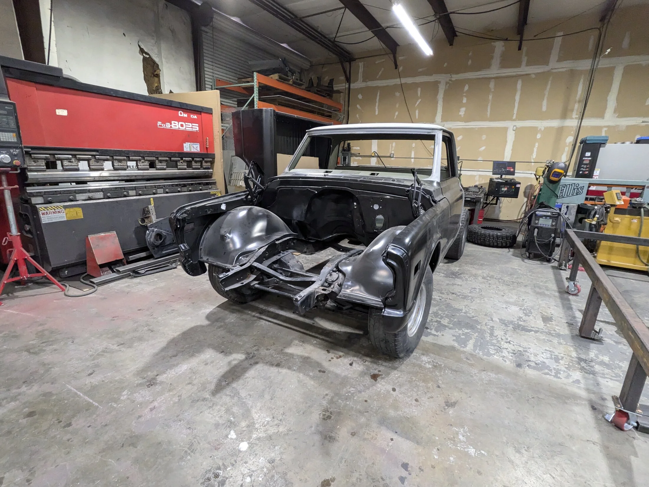

Did the roof of the cab (passenger side) have rust holes near the gutter as well? I thought I saw some in the second pic.
We have one that has lots of rust and holes top and bottom.
Yes the gutter edges were in need of rust repair as well. Small holes but we cut it all out and repaired with new metal.
