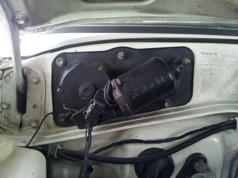

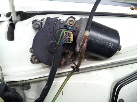

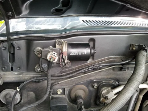

you mean these things?
60 --------------------- 70 ------------------ 80
Plus the 80 is 12V and you need a 24V
