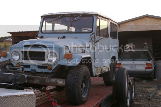

Here is what I am starting with.

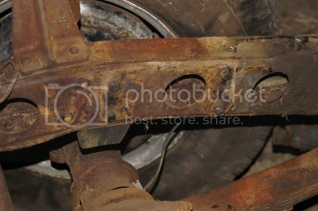

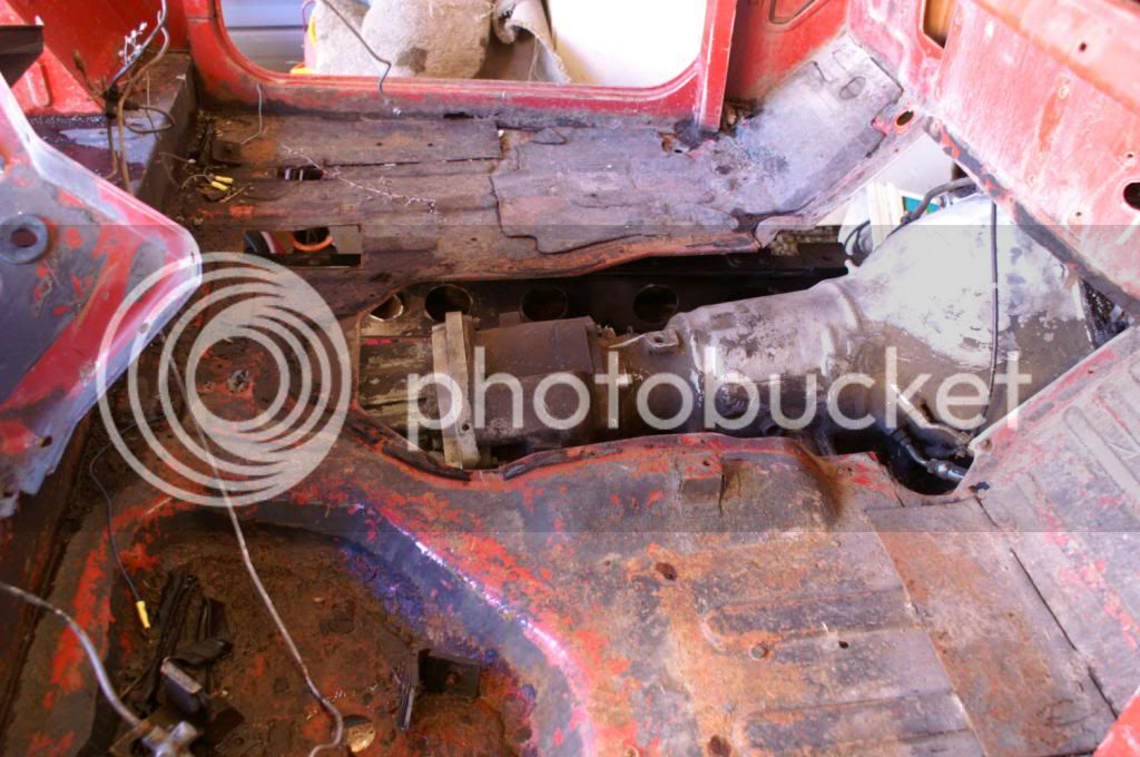

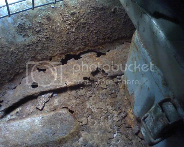

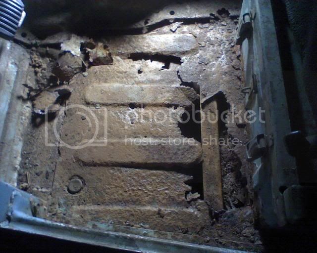

Some of the Gnarly rust .

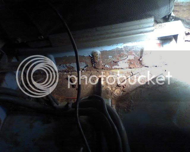

Drivers side floor
I plan on using sheet metal if I can find something left to weld to.

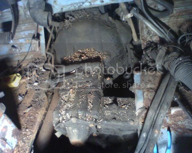

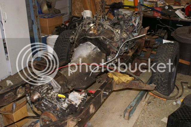

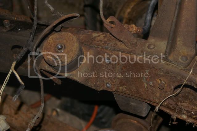

I tinkered around a little more and removed the heater so I could get the trans cover off. The water hoses were so brittle they tore with very little pressure.
I wish my jeep had this kind of access.

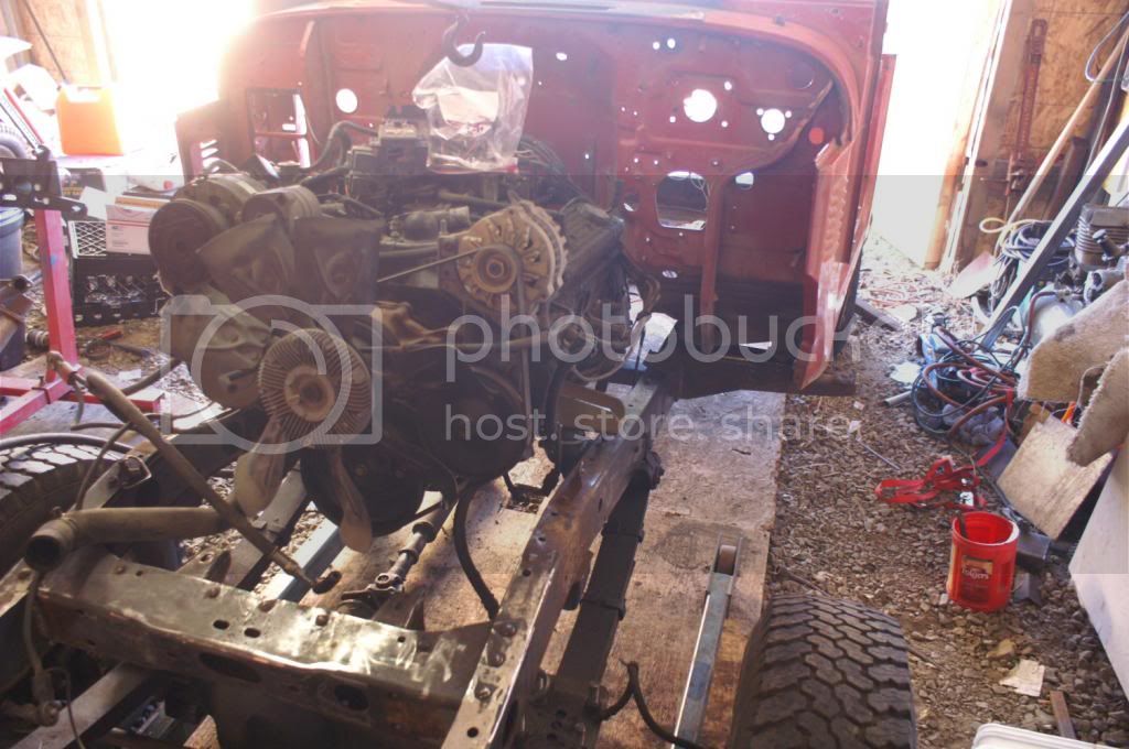

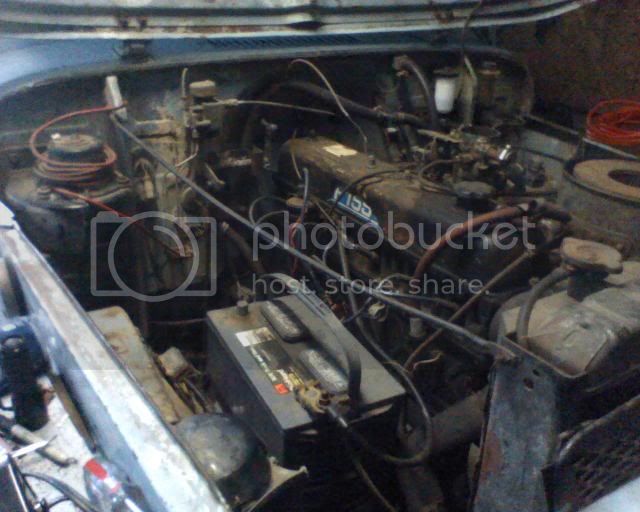

The stock engine.

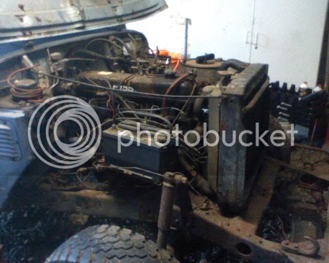

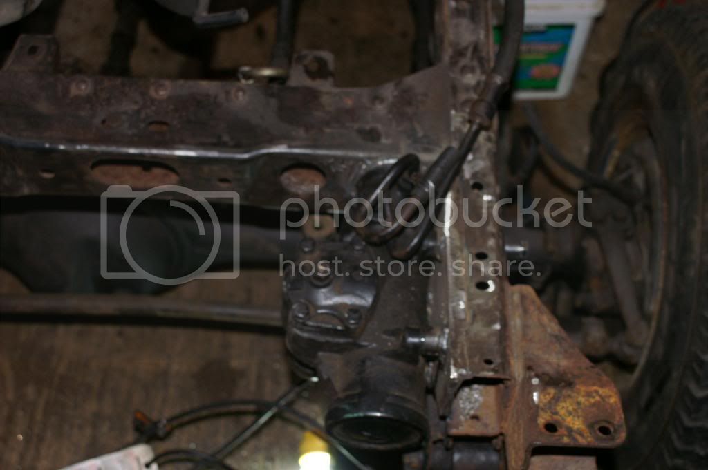

I am pulling the front clip and thus far only one bolt hasn't broke.I am going to have to get a new drill bit for the easyouts.

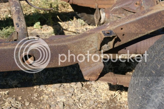

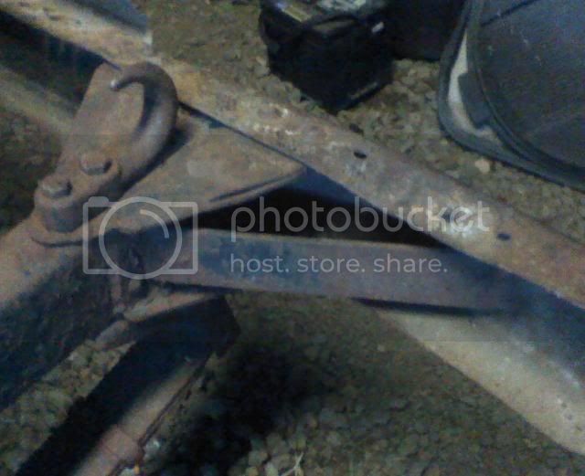

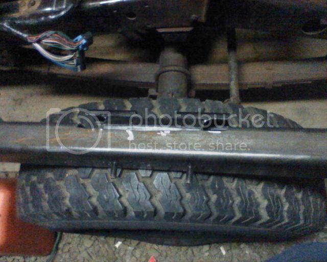

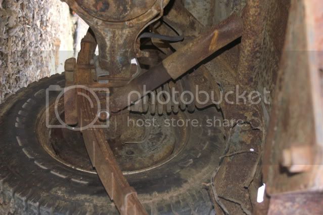

The anti wrap bar will be solid I plan on a solid mount on the axle and a shackle mnt at the trans cross member. and the springs already have the add a leaf. There is already some kind of over load coil springs under there now. I will have to take a picture of them later.
Here is a pic after I hit the front end with a hammer and all the rust fell off.

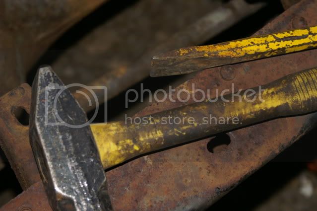

I freaking hate rivets!!!
After I chiseled the heads off.
Rivet removal tool

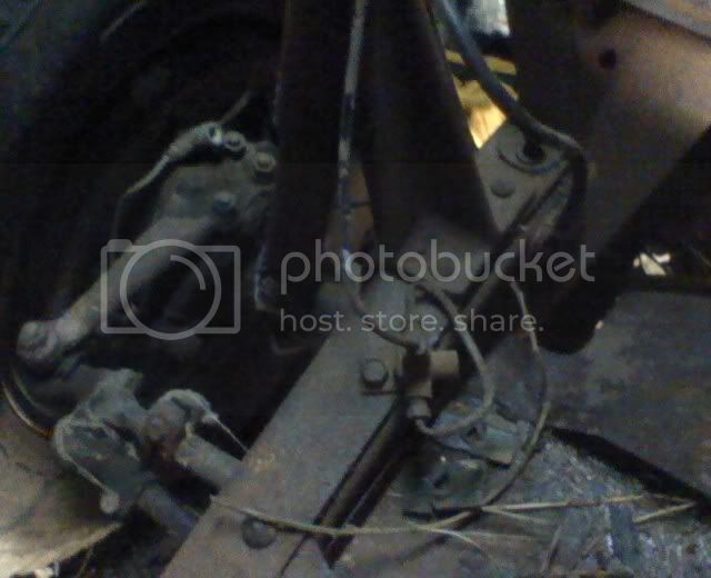

P.O.s Idea of coil suspension

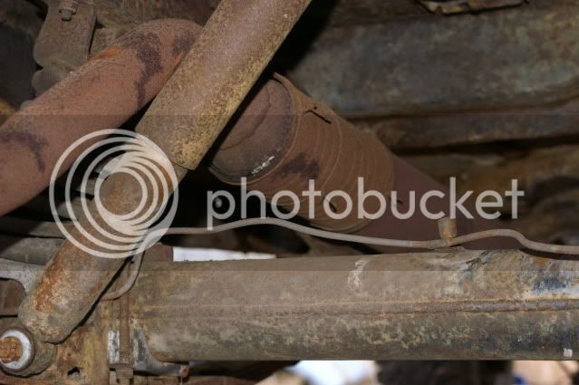

And a perfectly good muffler repair.

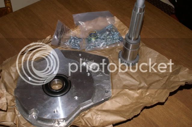

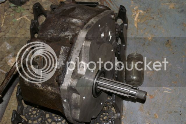

np203/Landcruiser Tcase doubler kit.

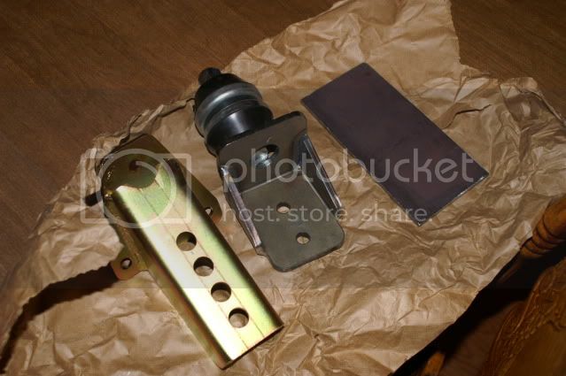

Fancy adjustable chevy engine mnts

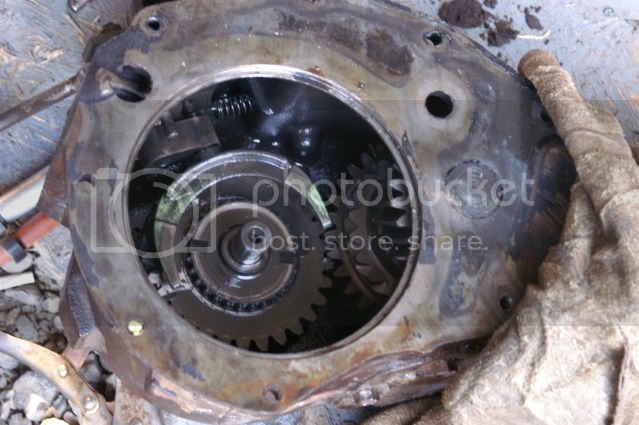

203 stripped and ready for adapter and plate.
Ready to attach Toyota Tcase

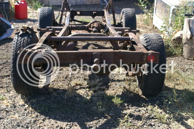

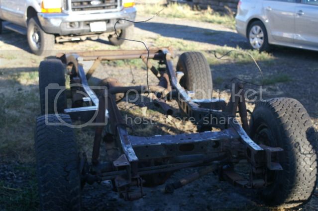

Ok I have the tub off and now its time to get down with the frame. Finally I can start building this thing instead of tearing it apart. So here is the battle plan . Clean the frame and prepare it for welding on engine and trans mounts. Mount steering and suspension probably have to stop for fall quarter after that.

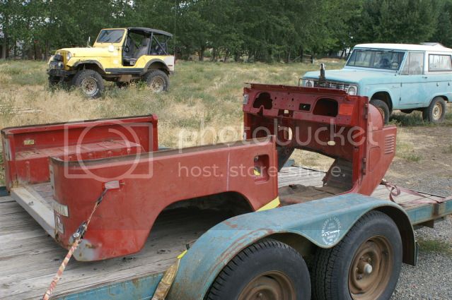

Waycrazy, you seem to building a collection! (I see a CJ-7 and a classic Bronco in your yard.)
You are making good progress with this tear-down and re-build. What are your intentions for this rig?
BTW, you are located in an *great* spot to access lots of good 4wd trails! (Naches and Rimrock.)

I do seem to have a small collection going on..LOL The Jeep is a cj5 not that it really matters to much. I love were I live . I can leave my front door and get to rimrock and never touch pavement. Something to be said for having some of the Pacific Northwest's best wheeling trails in my back yard.

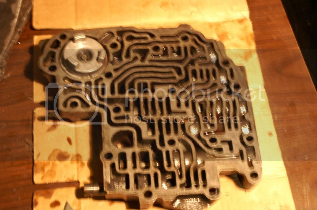

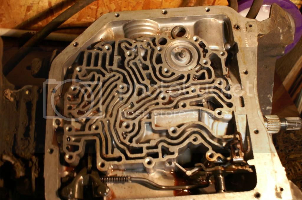

I got tired of Grinding cutting welding ect ect. So I decided to crack open the transmission and throw in a B&M Transpak.

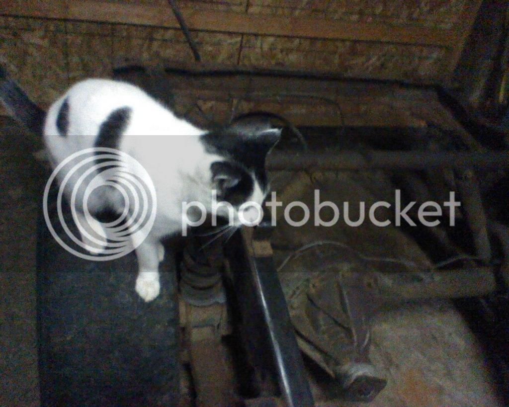

Did I mention my daughters cat loves to be a bothersome pain in the ass shop cat? He loves to be in the middle of everything and of course if there is Trans fluid hanging around he has to stick his white fir in it. He jumped up right in the middle of my open transmission

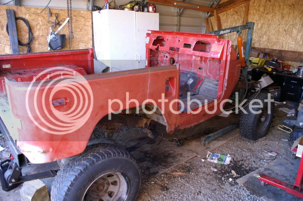

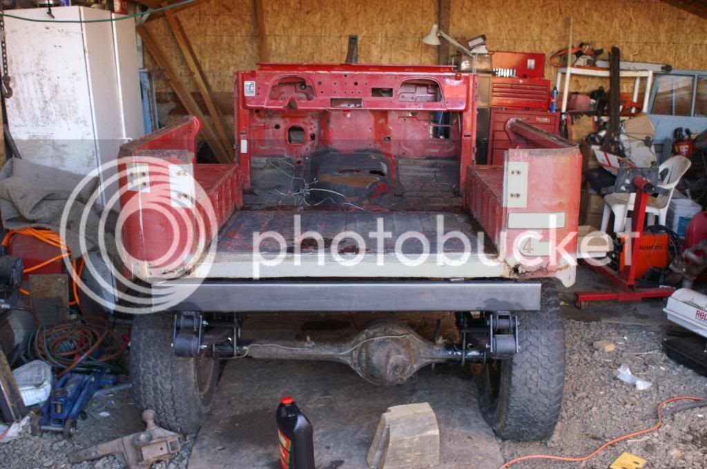

I set the body to see what needed cut and so I could mock up things like steering sliders body armor ect. Made me feel pretty good to see my rig to look like a FJ agian. But it didnt last to long when I started to mentally tally all the work that needs done. It will be my first and hopefully the last attempt at body work.:P

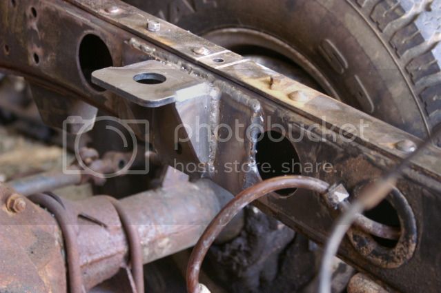

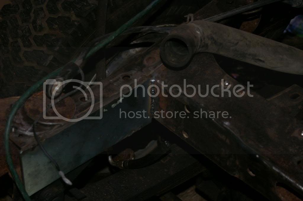

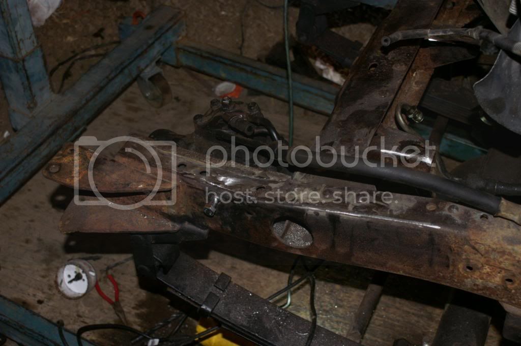

Steering box mount done!
Test fit to make sure everything lines up.
One thing I learned about steering box mounts is make sure they are strong! I played hell with the stock box mount on my CJ and I dont want to relive that nightmare. (Not much fun weaving between trees on a tight nasty trail with your steering box ratchet strapped to the frame. )
