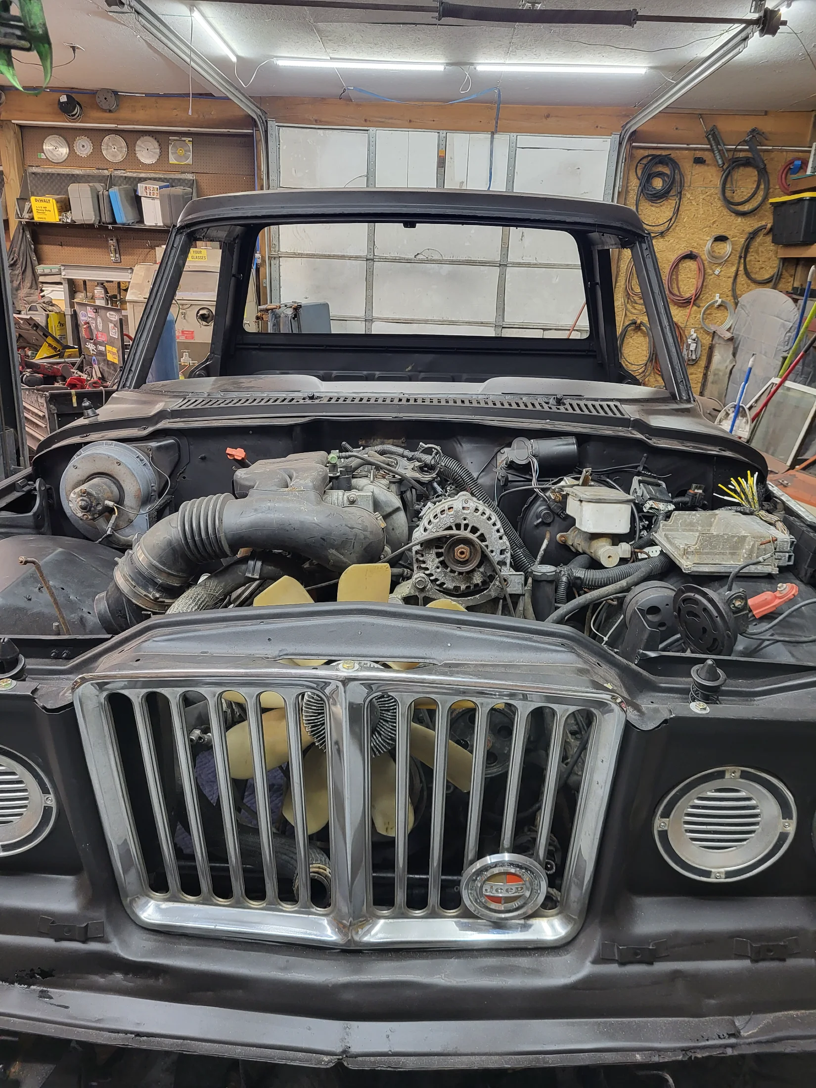

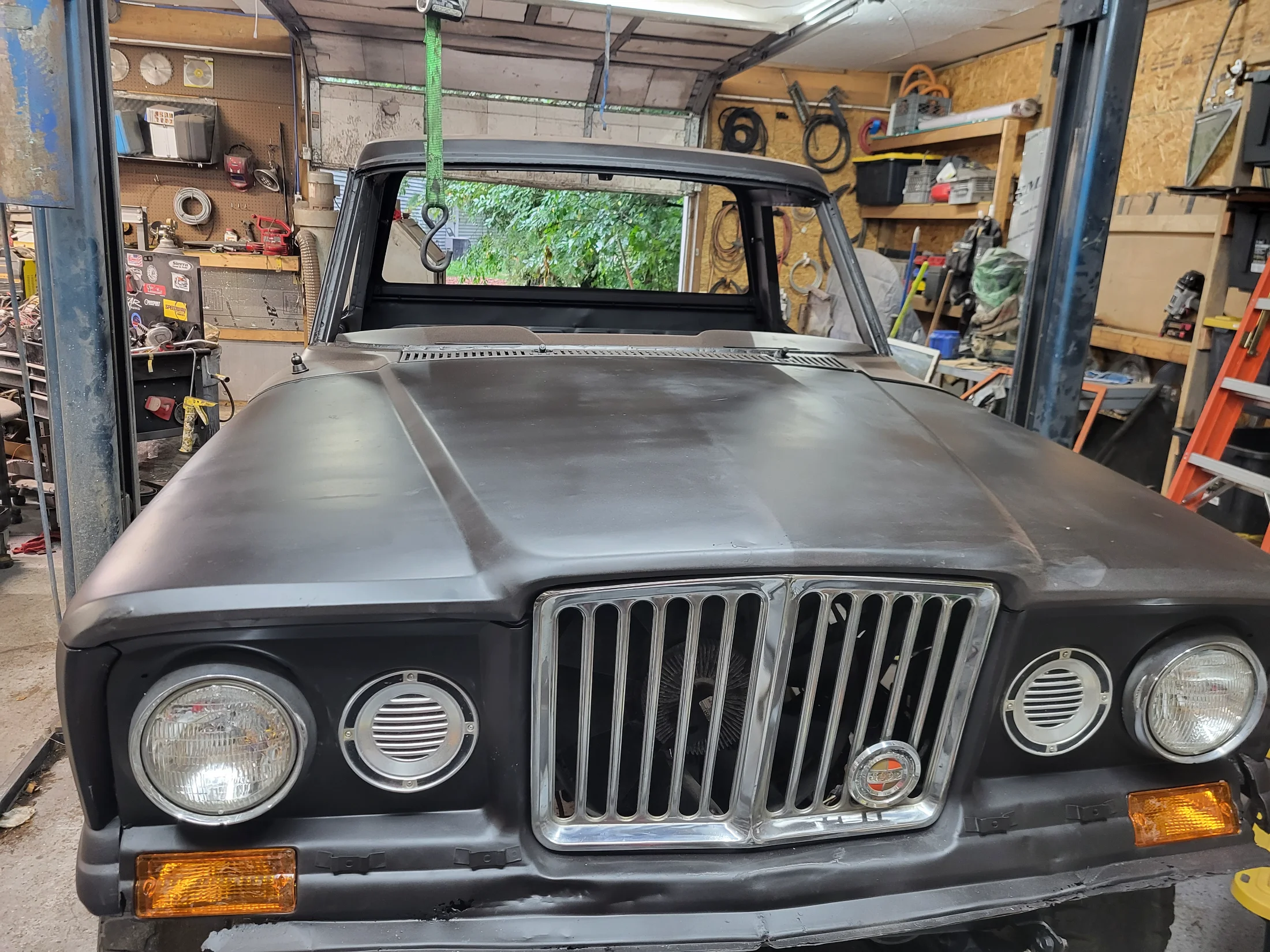

Threw the front grill together.

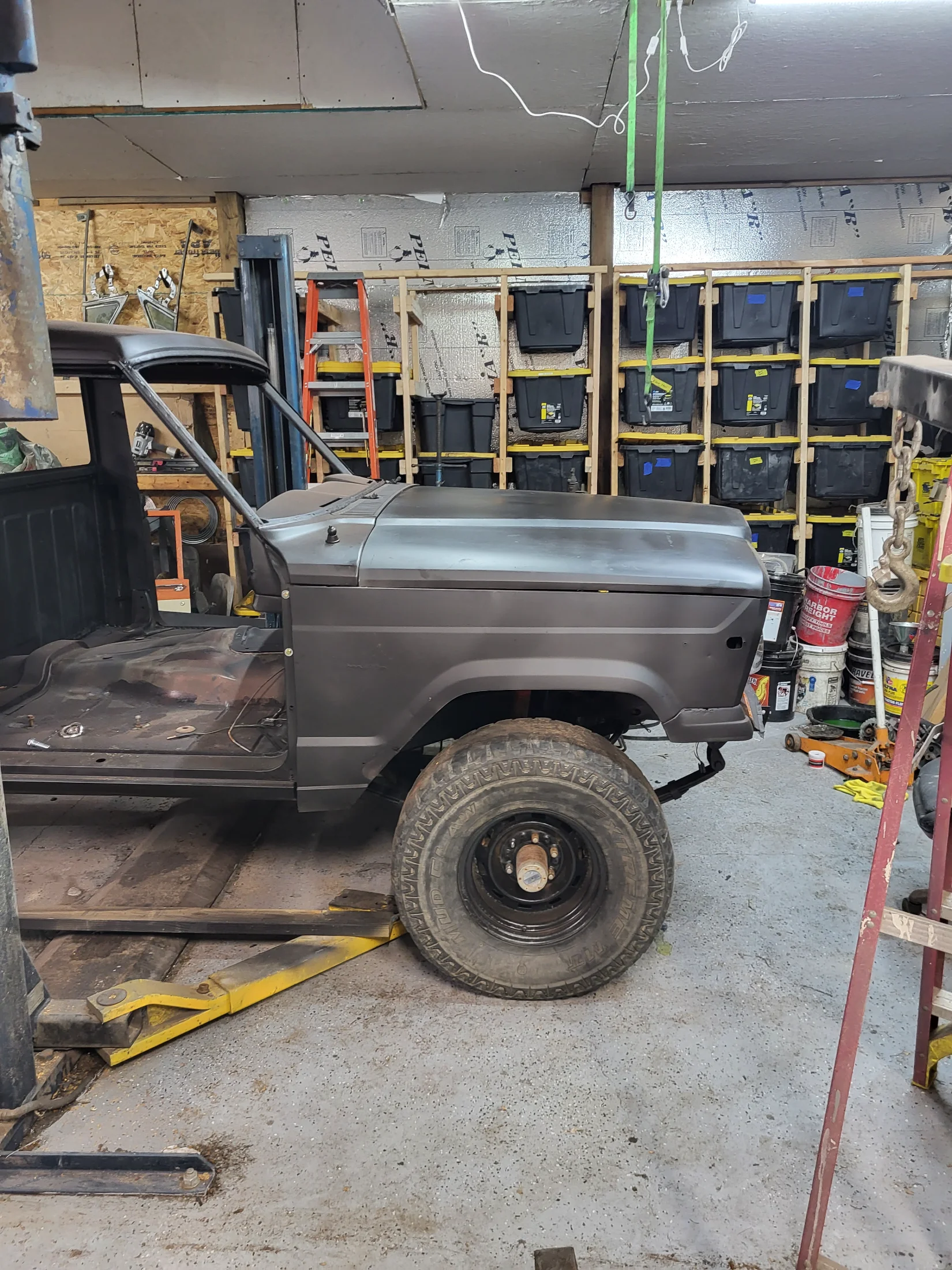

Wife helped me put the hood on for a pic.

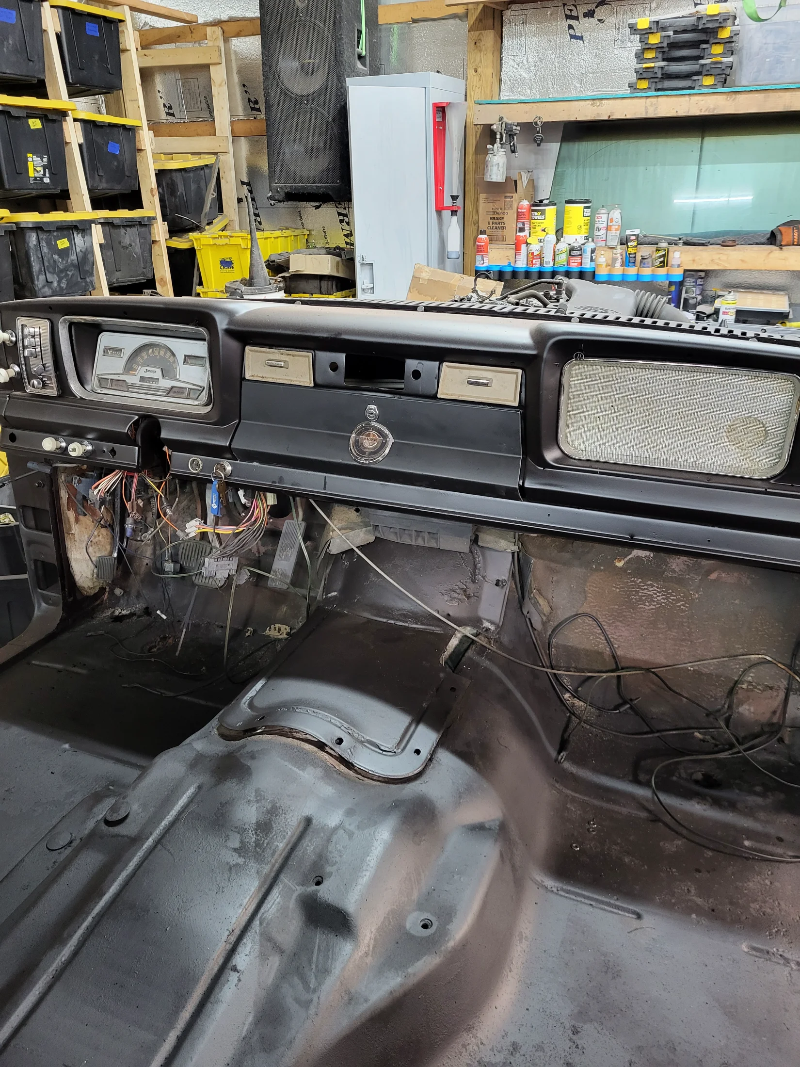

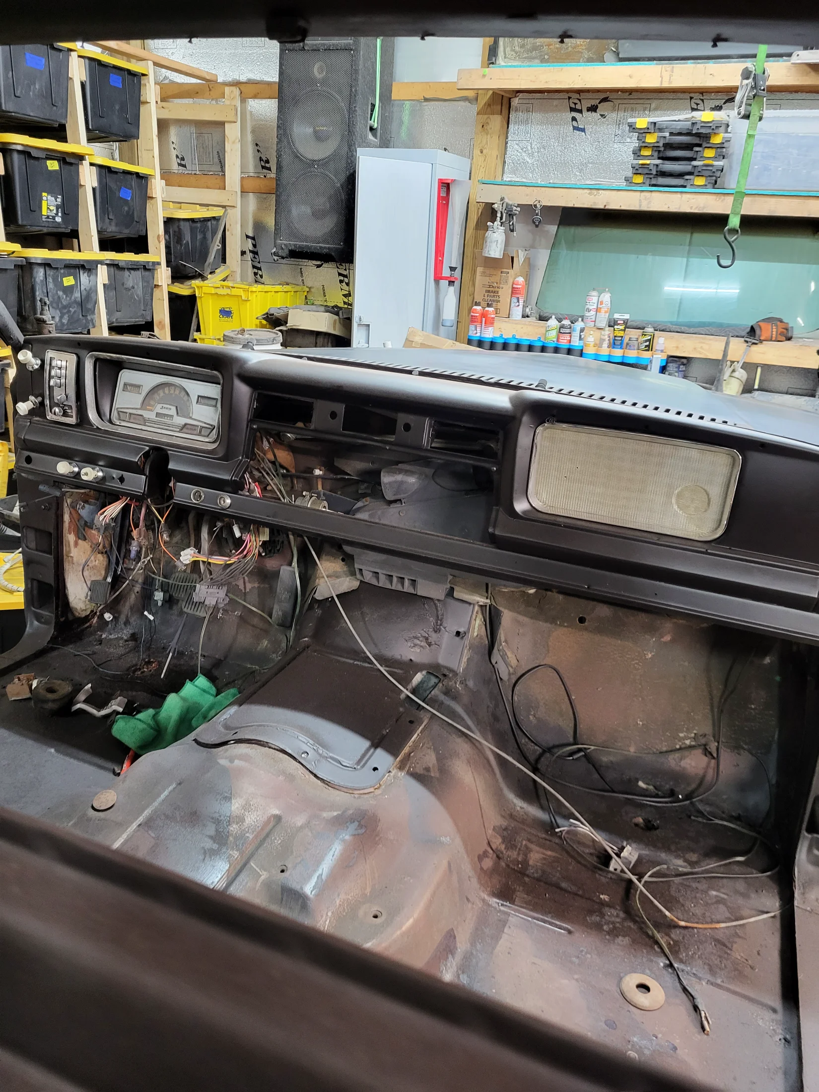

Dash is starting to come together

Got a couple of exhaust studs out. New ones went in and the the Trailblazer down pipes and cats bolted up. The motor is about hammered in. Front clip is all back on.
I don't know i should just print a radio delete plate. I have a 2 knob cassette deck, but even with the knobs all the way it, they won't fit.

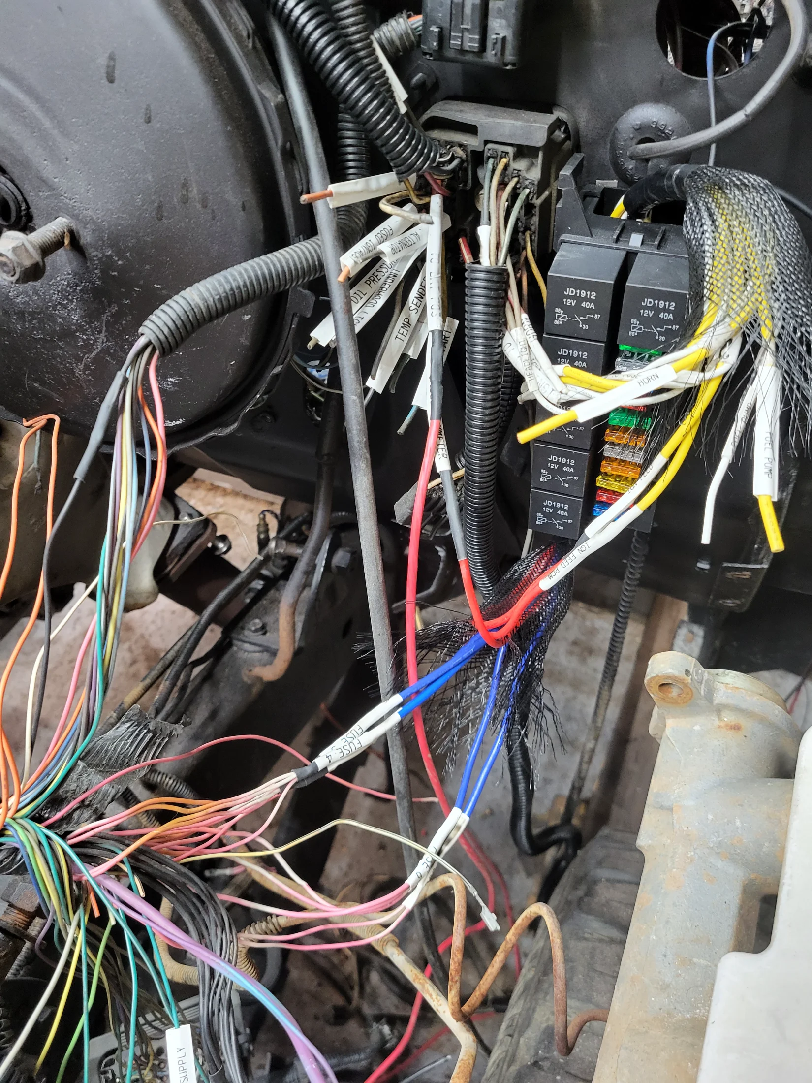

Next big step is wiring in the 81 bulkhead connector to the engine harness and light harnesses, wiring in the LS fuse/relay box, and adapting the 81 cab harness to the 68 dash.

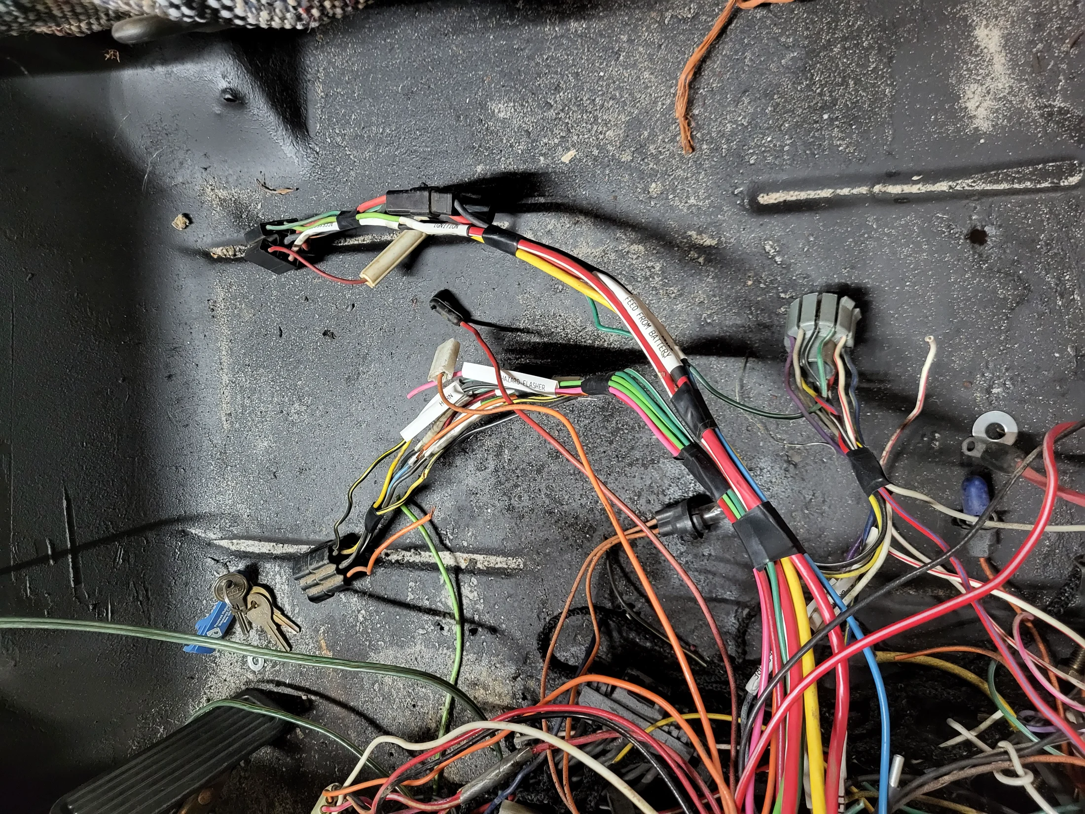

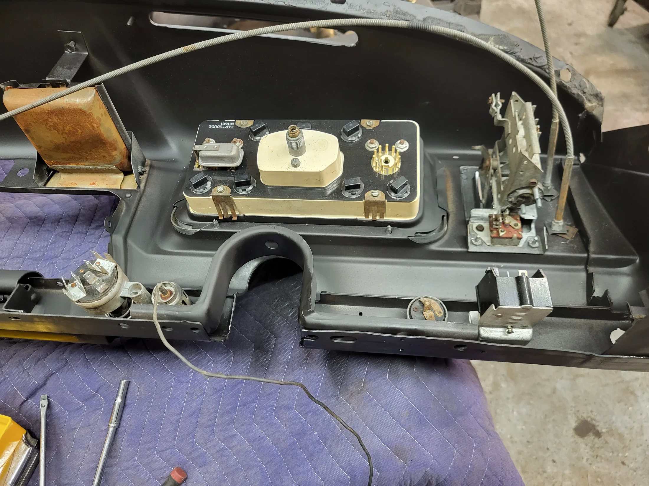

Back of the 68 dash. New PCB. The wiper switch lost a terminal. The knob and washer button are cool. 81 switch would be better and a plug in. I'll have to figure out a way to make the knob fit.

68 dash is wired except for the heater. Neither the heater or wiper are labelled as to switch position on either 68 or 81 diagrams. It'll take a minute with a meter and the power probe to see what's what. The 68 diagram doesn't even have colors.
I made spreadsheets with pinouts and splices. Printed up a ton of heat shrink labels. It looks like a mess, but I'm in good shape. Best practice seems to be adhesive shrink on the crimp and label as just a label.
Trailblazer harness is about all wired up too. Doing it dirty this time to start. All the TB harness is there. I kept all the stuff I'll disable in the PCM for now. Get it running. Make it clean later.

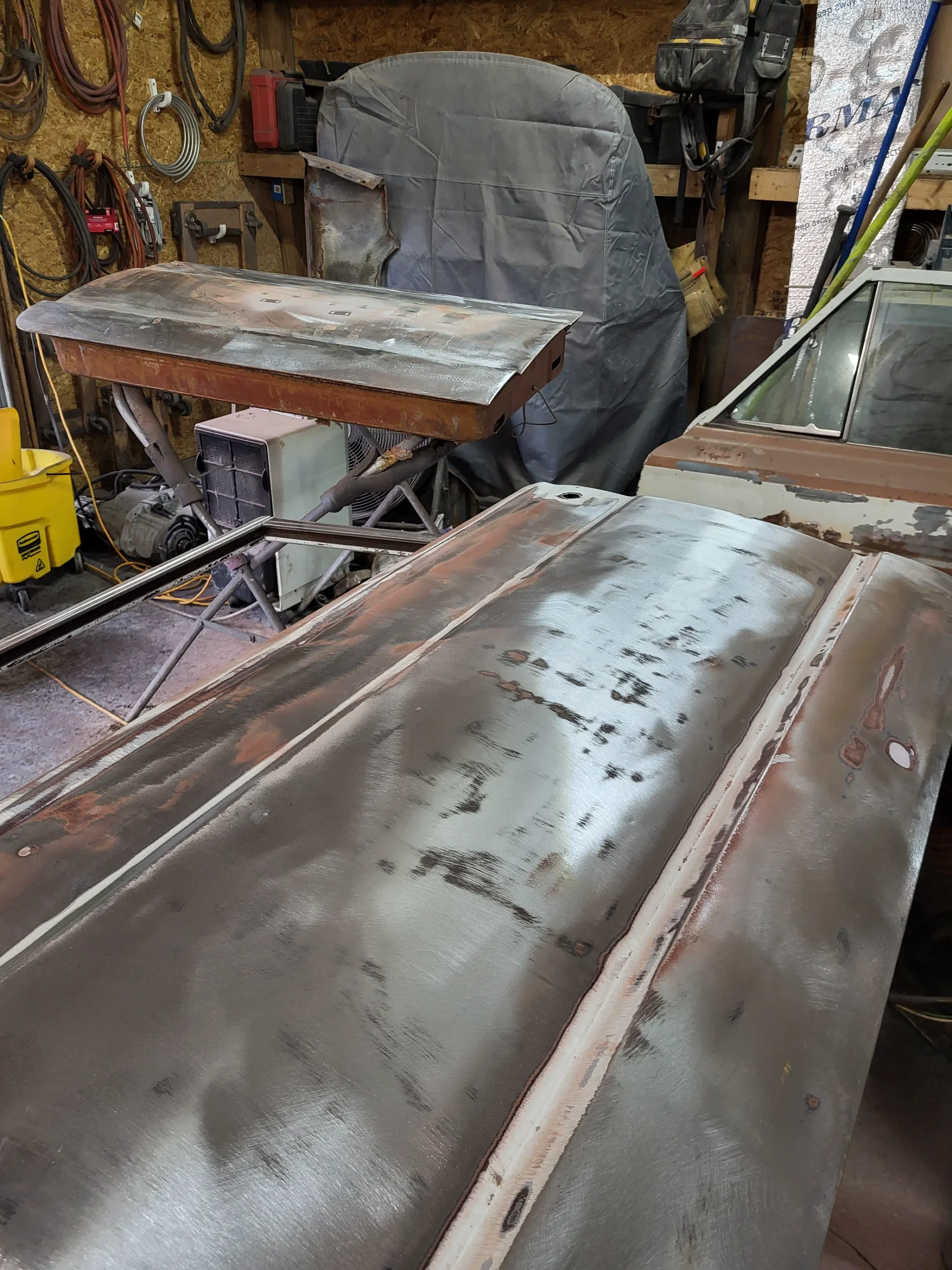

Been working on the bed. The 68 bed is 7" too long in front of the wheelwells and 5" behind. I sectioned 7" from the upper and lower bed sides. The bed floor just needed to be replaced in the corners.
Gave it a quick 80# bag of sand before it gat dark and before the weather turned. Drilled out the crossmembers, there was rot through the bed at the spot welds and they were all in the wrong place on the late frame.
One of the bed drops was bent badly. After the section the halves didn't much match. Lots of hammer work to get it smoothish and lined up.
Repaired the front sections to get some datum points back. Had to repair several layers deep. Installed the floor corner too soon. Now i have to stand up the bed to planish the upper bed weld. It's got a pretty mean valley of sin.
I did the upper bed side repair first on the other front corner. That side has a better drop and the rust is better on the corner. Less slush on the driver side to rot away the panels.
You can see how bent the wheel arches are. It took a minute to get the other side to line up.

Been working on the bed over winter break. Patches are done except for the crossmember spot welds on The bed floor. The corners of the floor are done. In front of the wheel wells is shortened 7". I started picking out dents. There's a ton of them. Clearly a wood truck that's had a lot of split wood tossed in the back.
The worst was probably this crease in a fender flare. It's getting close. Plenty close for filler, but I want so see how good I can get it with a hammer.
