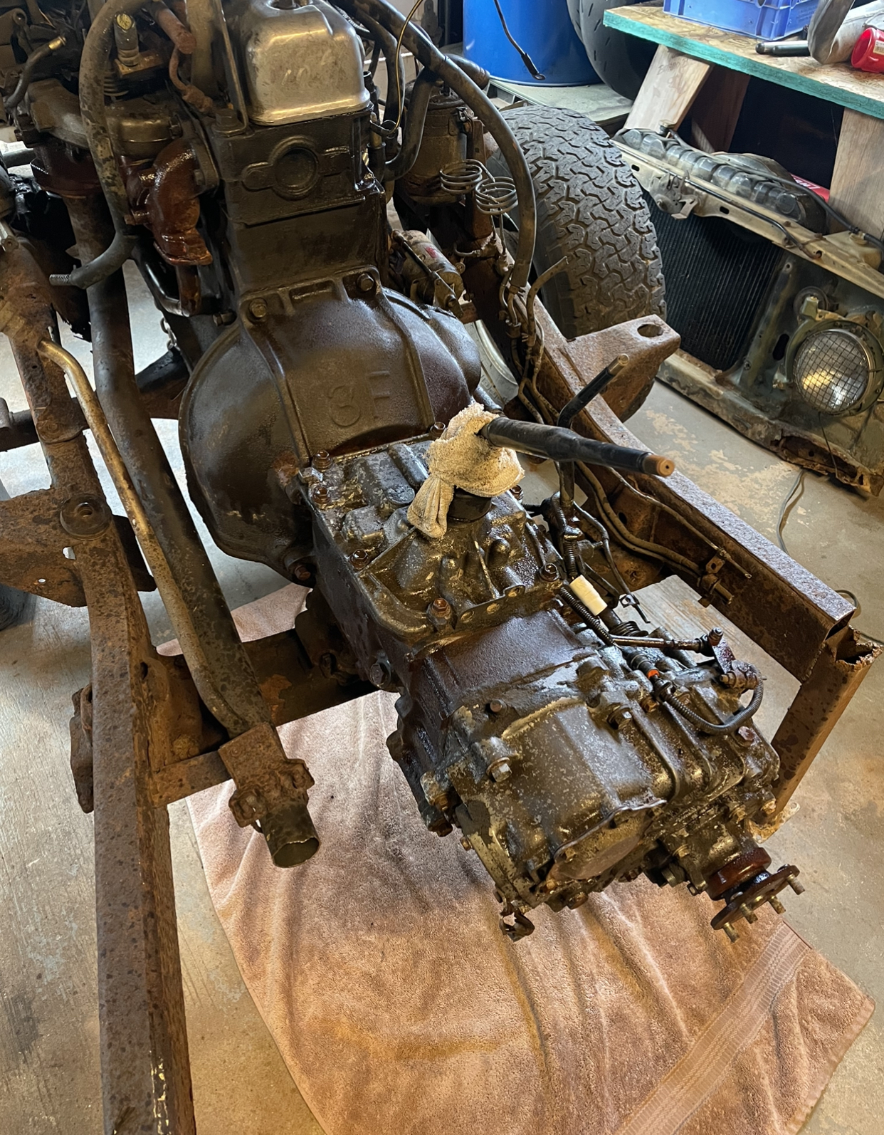

I just inherited a 62 from a friend with no engine and a bad trans. It is in great shape in all the important places and I want to take the engine install as a DYI project. I have limited experience mechanically but very skilled friends who can and are willing help out. I was able to source a low mile 3f from a 60 locally for a good price and have found an automatic trans from a 62 - any reason why I can’t couple these? Obviously the 60 was an manual, but I don’t really want to have to do that swap with limited experience. There will be plenty of fun learning involved in this process so I am happy to keep it closer to how the tuck was intended to live for now. Any major differences I am not considering beyond the EFI on the 3FE that would cause this not to work. Thanks in advance for any advice or insight anyone can offer.

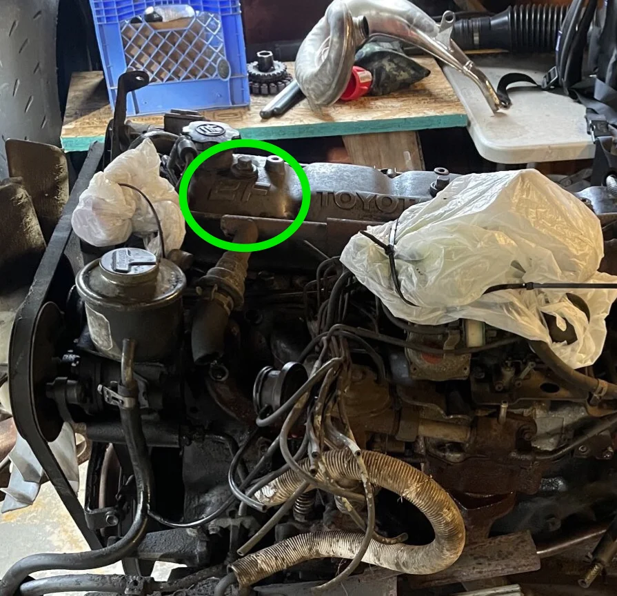

I am pretty sure it’s a 3F - I guess it’s from South America? It’s only got 125k miles on it. Currently a 4sp manual - I could try and do a conversion to manual as he has all the parts, but with al the extra fuss at this point I may just go the LS route.

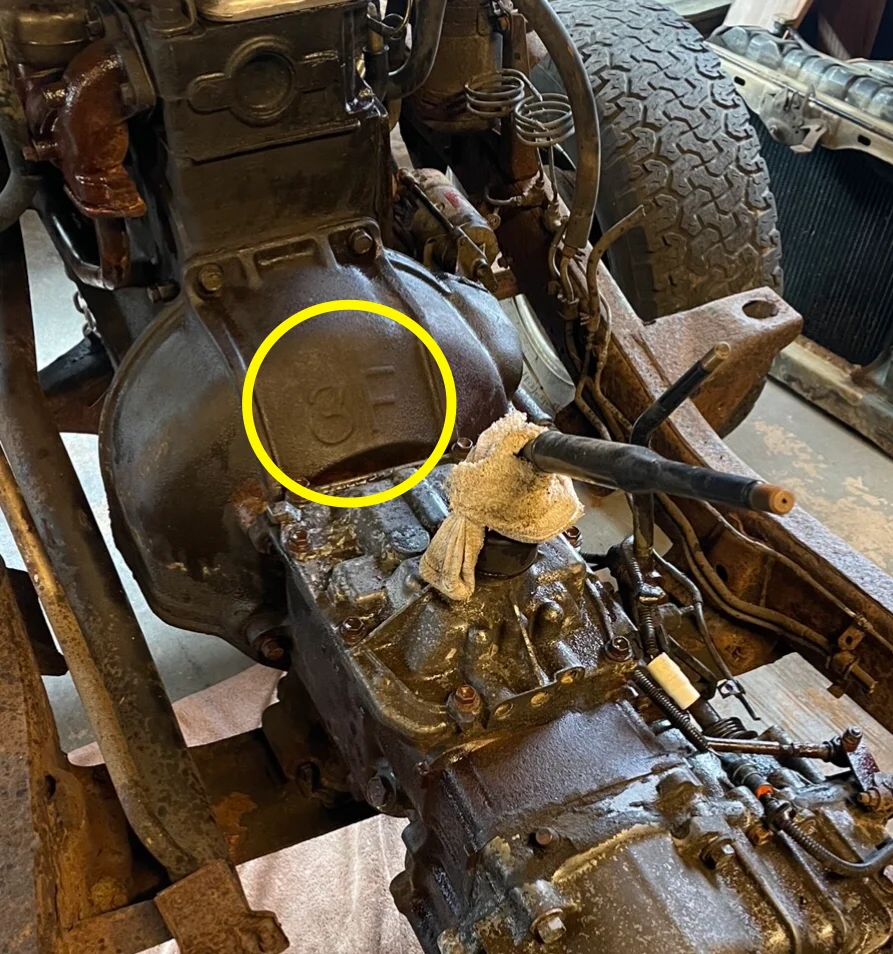

That’s a mid 1985 or later USA 2F engine that originally was in a FJ60. It’s the ‘newer’ design.
See the embossed “2F” on the aluminum valve cover. (Green circled).
The later 2F engines came with the 3F bell housing which you can see embossed on your bell housing (yellow circle).
(2F engine mated to 3F bell housing)
Ah great. I was working off the 3F on the bell housing. I appreciate the info. Thanks
