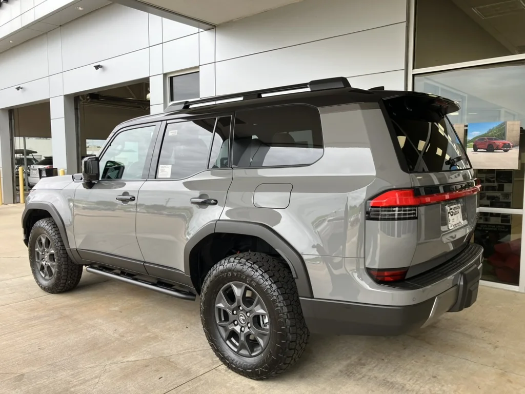

I've had my truck a little over a year and have used it both DD, Highway Travel, Offroad, Towing my 40 series 400 miles, and sofar am quite impressed with the truck. It has done everything I've asked of it quite well and haven't been disappointed.
First week of ownership and I installed the new Yokohama X-AT Tires in a 285/75R18... On my particular truck these tires only rub at full lock and barely on the body mount and nowhere else... They are labeled on the sidewall as a 35x11... I haven't measured them to see if true to size but on the Factory OT wheels they tuck well and look great on the truck.

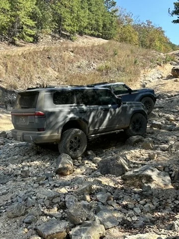

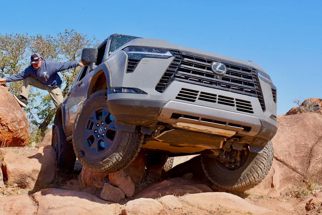

Next up I took the truck to our annual cruiser event in Hot Springs, Arkansas for Southern Cruiser Crawl hosted by Cottonland Cruisers... It's a great event and this year we celebrate our 20th anniversary coming up in October.
I took some body damage on the rear bumper which was to be expected as I wanted to push the truck a little. My other is a 470 on 37's with RCLT and honestly the 550 is nearly as capable as something I've but an additonal 30k of mods into.

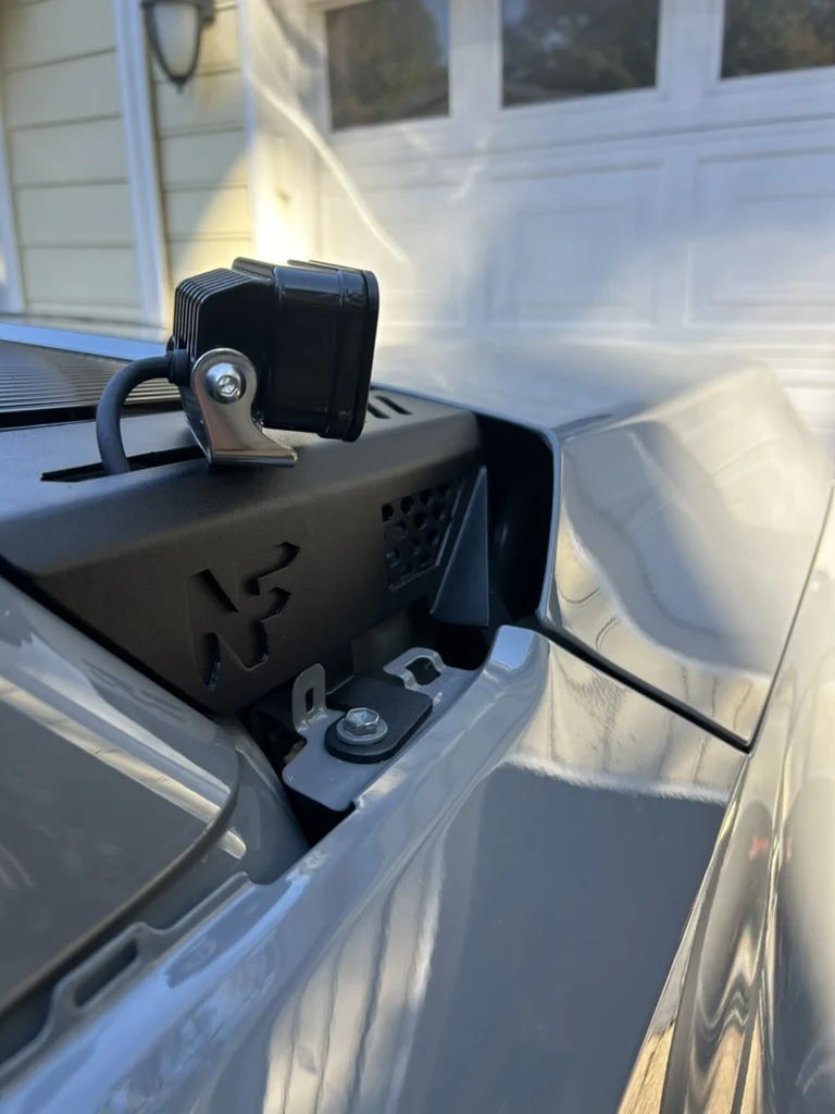

I quickly ordered a Victory rear bumper since mine was damaged and lead times were short. I also ordered some NashFabCo. Ditch light mounts witch serve the purpose but need a little tweaking in design to be perfect.

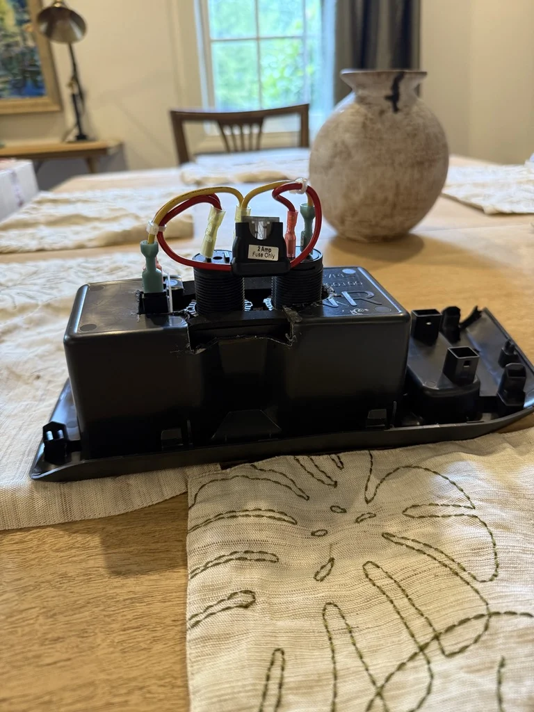

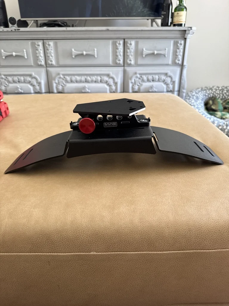

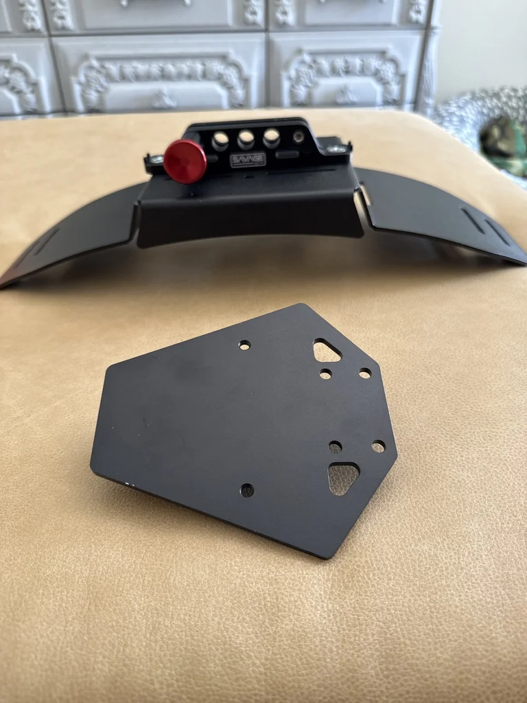

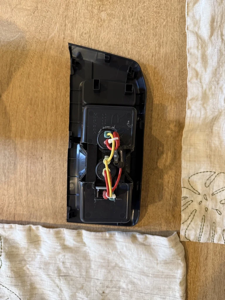

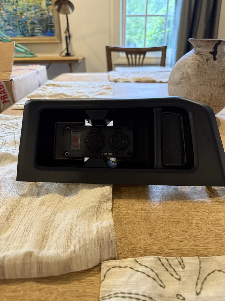

I went ahead and cut up my rear cupholder to house a Blue Sea Switch for an upcoming fridge install once my goose gear rear plate arrives and also got my starlink mini mount setup to go on a spare tire swingout. I have also ordered a full dissent bumper kit front and rear that I liked more than the victory since high clearance is my goal.

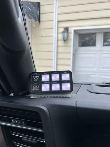

I also got the victory shelf installed to hold some of my gear that I always like having around and odered a hatch light kit from bullycruiser which is some of the best money spent. All accessories are wired to a swithpros unit which I mounted behind the battery on the firewall and run one dedicated wire through it near the steering column. Feeding up by the door trim allowed for no drilling of anything and seeing the clip on opening the door doesn't bother me.

I choose the cupholder in thoughts that if I ever wanted to take it back stock, that would be the easiest and cheapest panel to repalce on the the truck and it's protected from cargo.

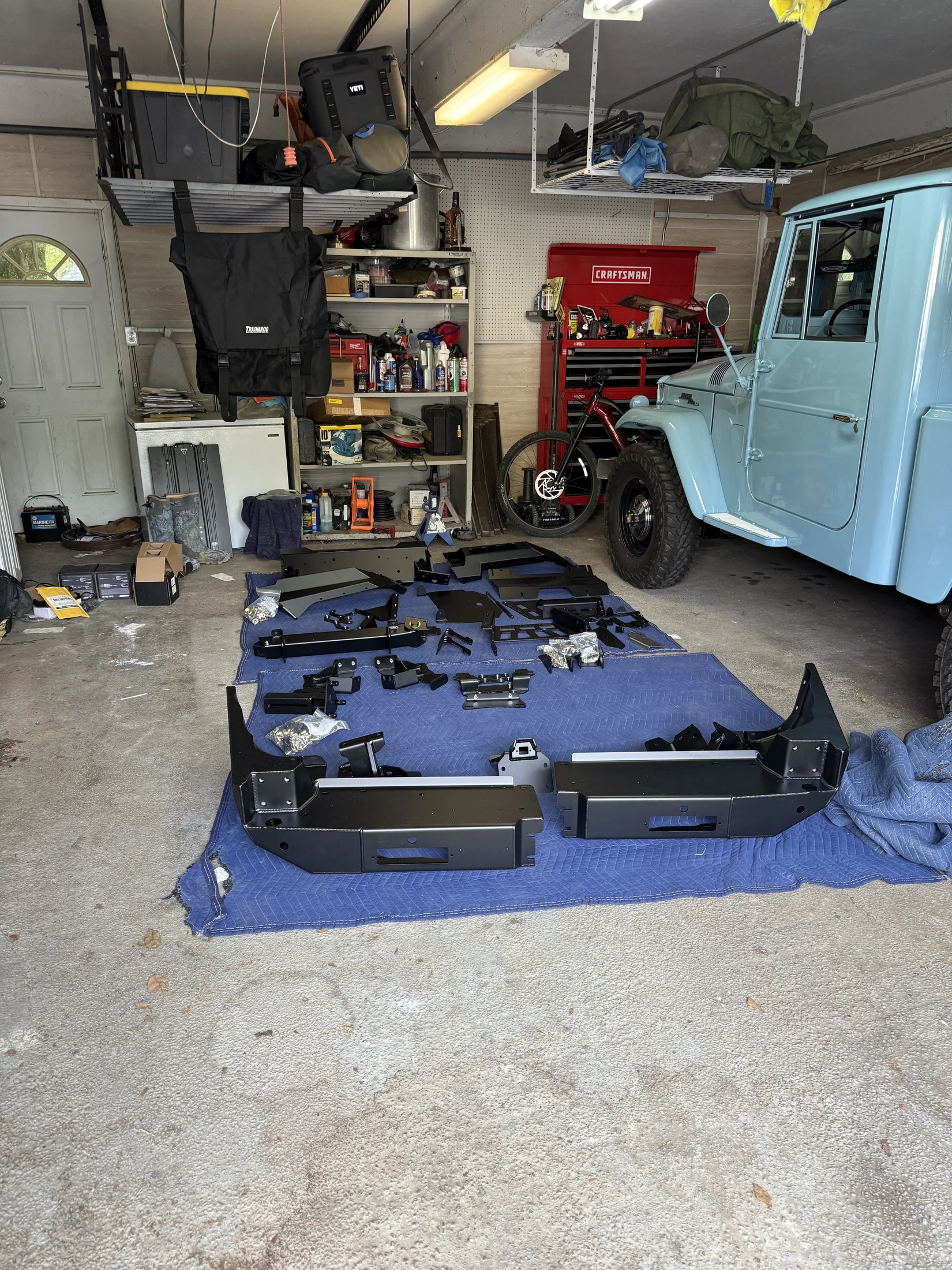

Bumpers arrive today... Still waiting on the winch to ship straight from MFG... headed out of town this week so it will be next weekend before I tackle the install.
Got the Dissent Bumpers, swingout and lights unboxed and organized, this is going to have to wait till next week. Headed to Colorado for cooler weather and great scenery.

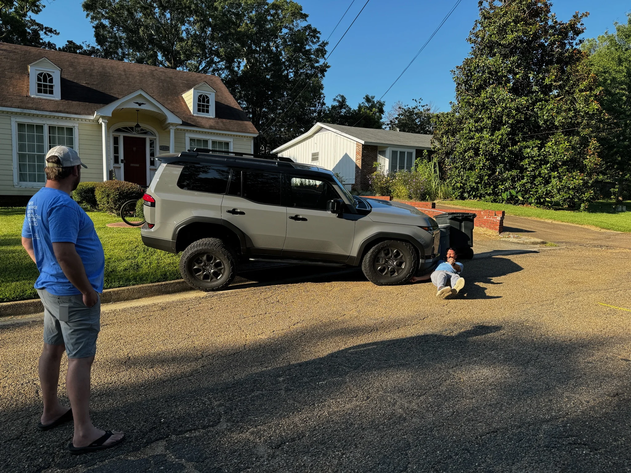

I measured them out today while taking some other height measurements before armor.
They are measuring 34” x 11” on the factory wheel and have about 20k miles on them so maybe brand new measuring 34.2 ish.
Unpacked a sorted.

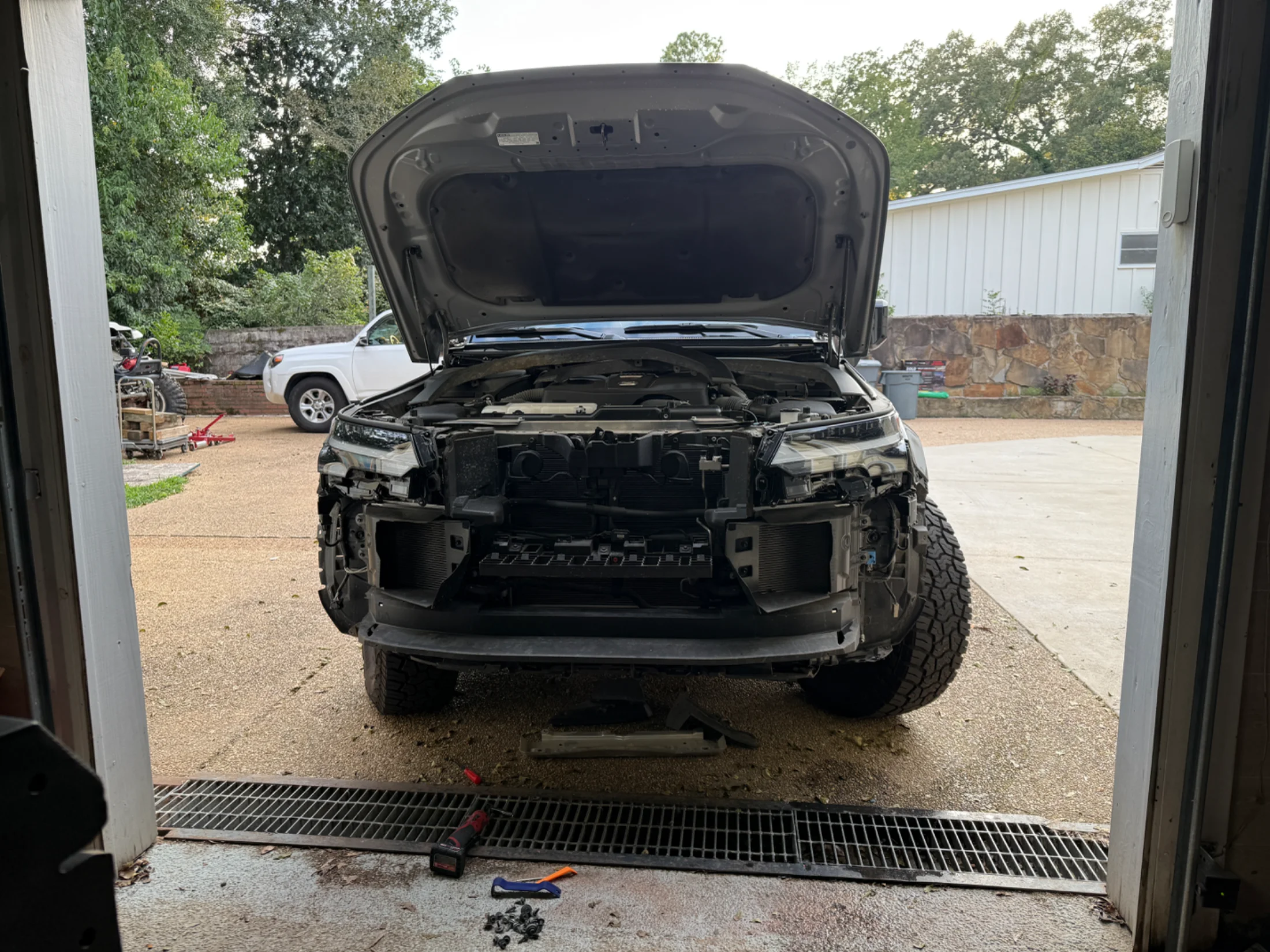

I got tbe removal prep done, headed out tomorrow to go wheel in CO. So I’ll see y’all next week with the rest of the front install and rear the following weeklong.

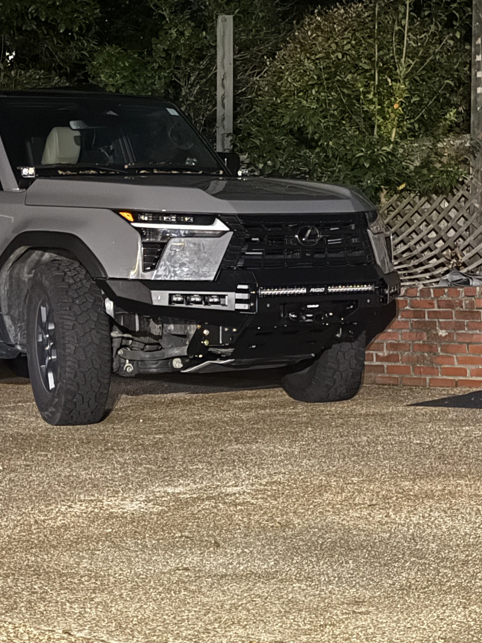

It’s a 2 full day install but I’m glad to have the front done. It looks so much better.
I’ll tackle the rear and goose gear this weekend.
Dissents video lacks a few steps but I’ve installed their bumpers on other platforms, so I was able to deduce given some missing steps and extra parts 😂
For reference, after installing the bumper I lost 3/8” from ground to fender on ride height with weight of winch, bumper and lights.

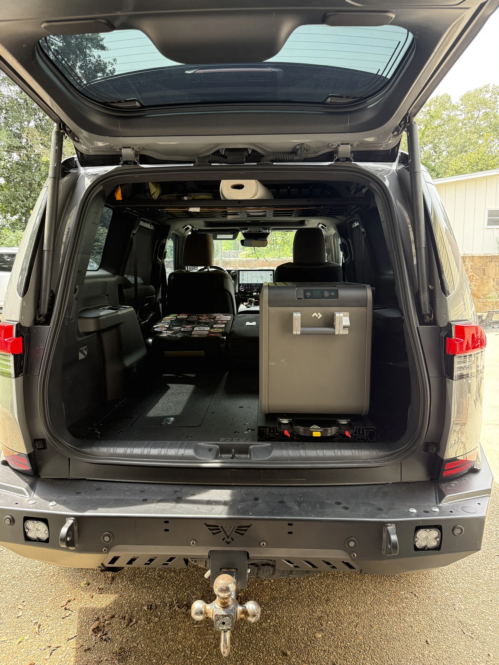

The rear hatch light kit from land bully is about the best $25 you can spend if you plan on camping and using your truck with the hat hatch open.
The goose gents rear tray is about the easiest install I’ve ever done. It really increases the available storage underneath and is a great product.

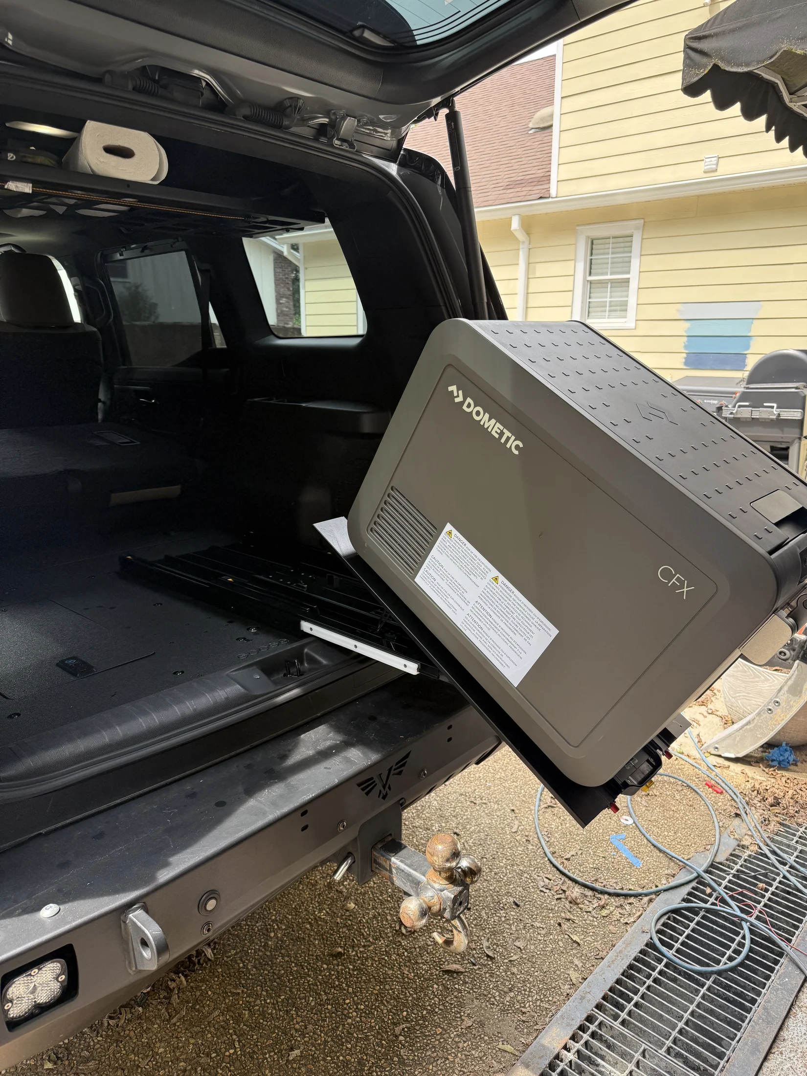

Got the engle tilting fridge slide and Dometic 45 mounted in the truck.
I love the engle slide as it takes up the smallest footprint and has quick release feet for taking the fridge in and out of the truck as needed.
