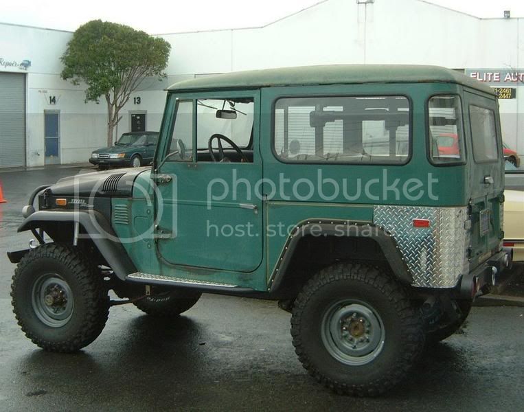

rear fj55 2 1/2" lift springs x4
let me know if you want any more :D

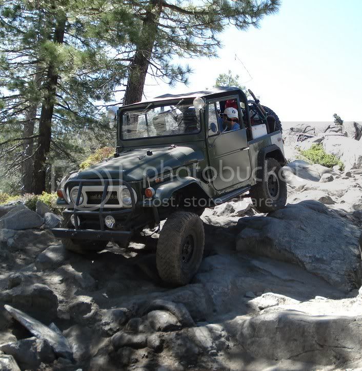

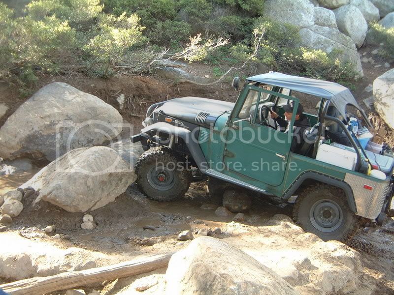

old rancho/55 combo:
You know that section of your daily commute that you avoid...no longer an issue :D
I'm not sure if it was the increased WB or the improved rear shackle-angle, but the combination was a definite improvement.
After a while, I started looking at my front shackle-angle...pretty much straight up-and-down.
Adding another set of rear fj55 springs took care of that :D

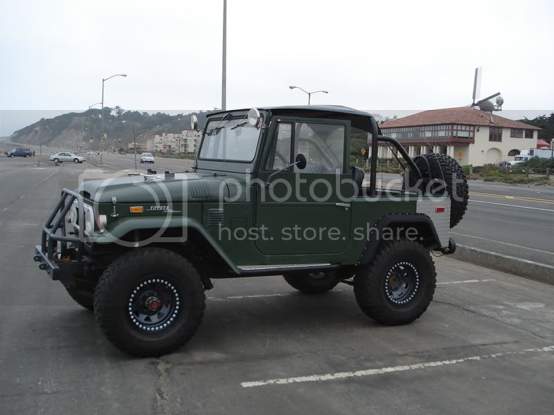

gatekeeper RIP:
