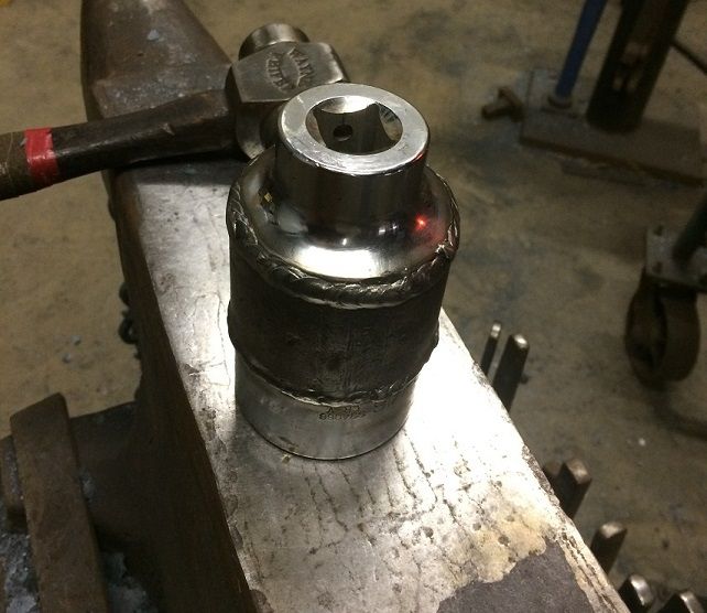

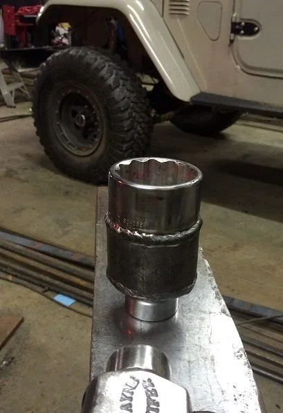

Bang, Though I'm a blacksmith (www.irontonforge.com) and forge most of my tools... I cheated on the socket. I cut the new Napa 2 1/16" socket near the top and spliced a 2" piece of 2 3/8" pipe on to it. Great for removing spindle nuts!

Adaptive thinking I like it :cheers: and I checked out your website you do some awesome work. I'm going to share it with my folks they have a log cabin in Tennessee and they'd really appreciate your work especially those light fixtures.
The sign of a great craftsman with true skill is that even the things he makes for himself, that no one will ever see, have great welds and look like a production piece.
