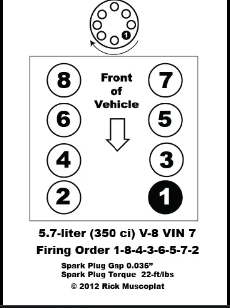

I can't find the firing order for my 2013 200 in the FSM. I believe it is this:
Can someone confirm?
Just for the record, the above diagram is correct for cylinder numbering. I didn't verify the firing order. The gap and plug torque #s are wrong. Gap is 0.44 (Denso plugs are pregapped so you shouldn't need to actually gap them and the tip is very fragile so be careful checking) and plug torque is 15 ft-lb for LC.
I was under the impression that the gap Should be .43 or .44. Is not correct? My original plugs were at .43 when I replaced them with new densos they were also .43 out of the box
correct. I think the spec is 0.44 but they come pregapped so really, don't mess with them. I fixed my post above.
The above diagram is for a small block Chevy
could be. it was really just meant to show the cylinder numbering, which when I originally posted, I wasn't sure how Toyota numbered them.
