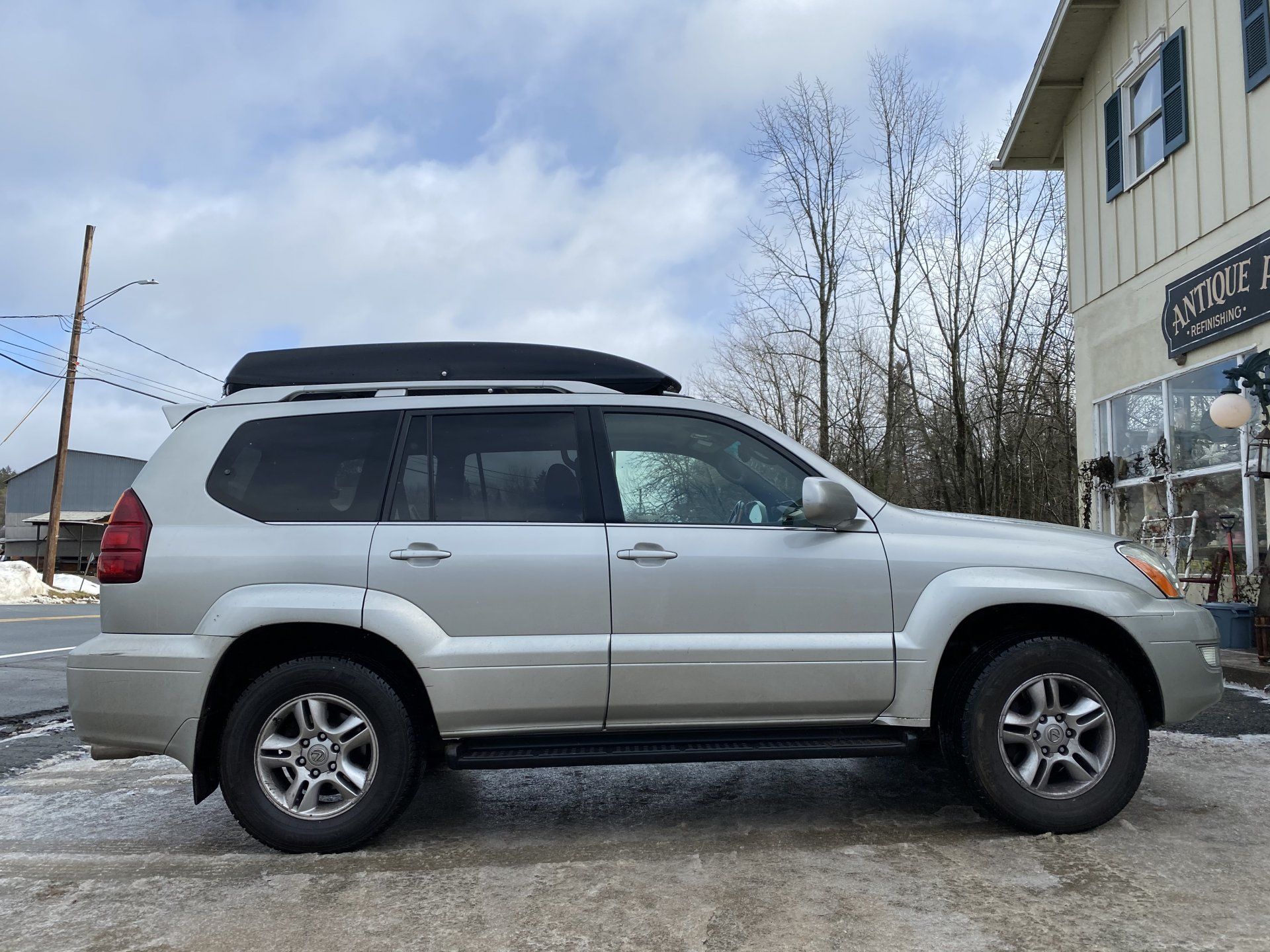

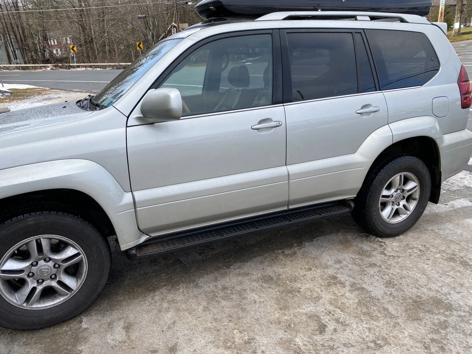

I installed them yesterday and I’m pleased.
Will you guys post some pictures of the 4runner steps installed? Maybe a side profile picture, thanks
