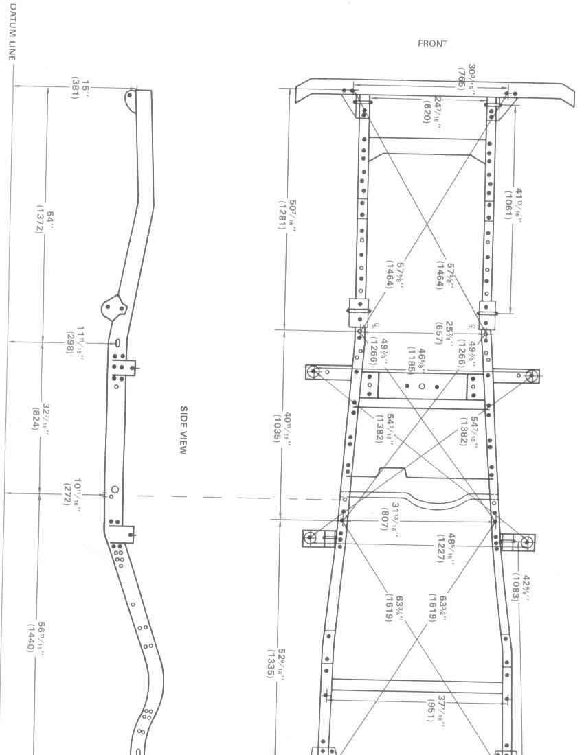

Hi,
Have another question on the HJ47 frames.
I found the dimensions for wheelbase and overall length to be the same on the FJ45 LWB and the HJ47 Troopy according to brifield.com.
Since I am still looking for a Troopy and want to get a frame in the meantime to start a resto, I want to make sure a 45 LWB will work as i doubt there is a 47 troopy frame laying around.
I found a realy cool frame page for the 40,
http://www.ih8mud.com/tech/framedims/cruiser_frame.pdf
and this one too:
So my question is weather anyone has such specs for the 45 / 47 frame.
Thanks,
Kent
Kent,
The only difference i know between a troopie and a pickup frame, are the body mounts and the rearmost crossmember. The rest should be the same.
I can e-mail you some detailed pics of my frame, because the body is off anyway. Let me know.
HTH
Mark

Thanks Troopie, emailed ya
