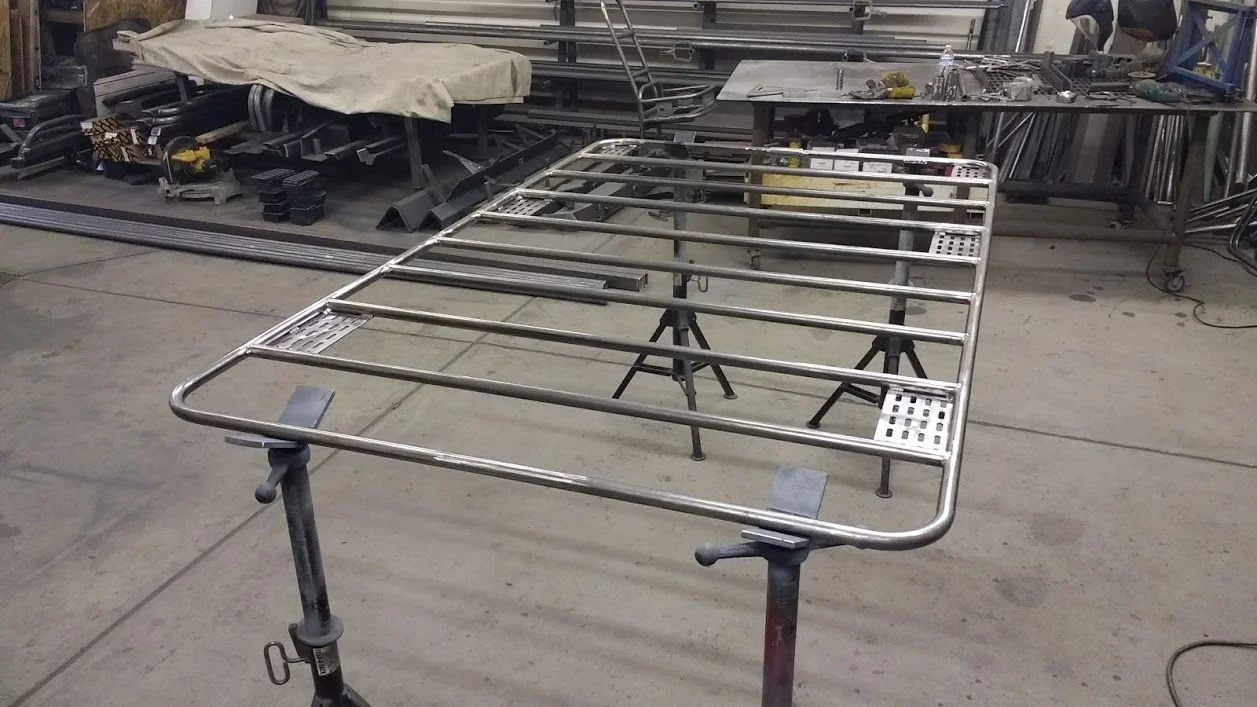

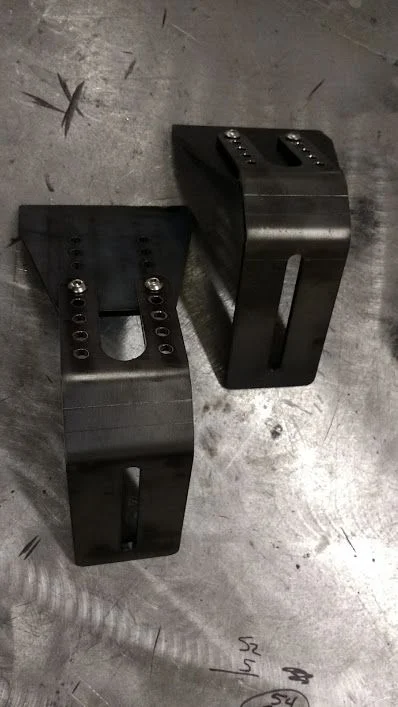

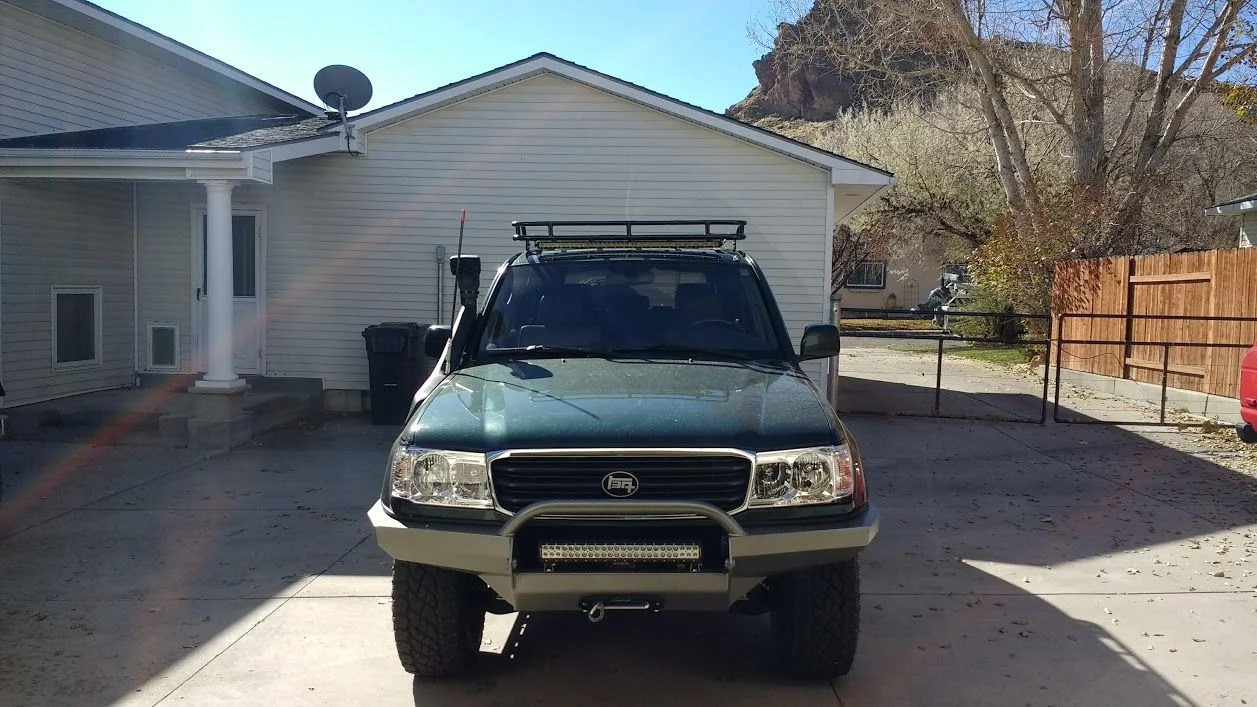

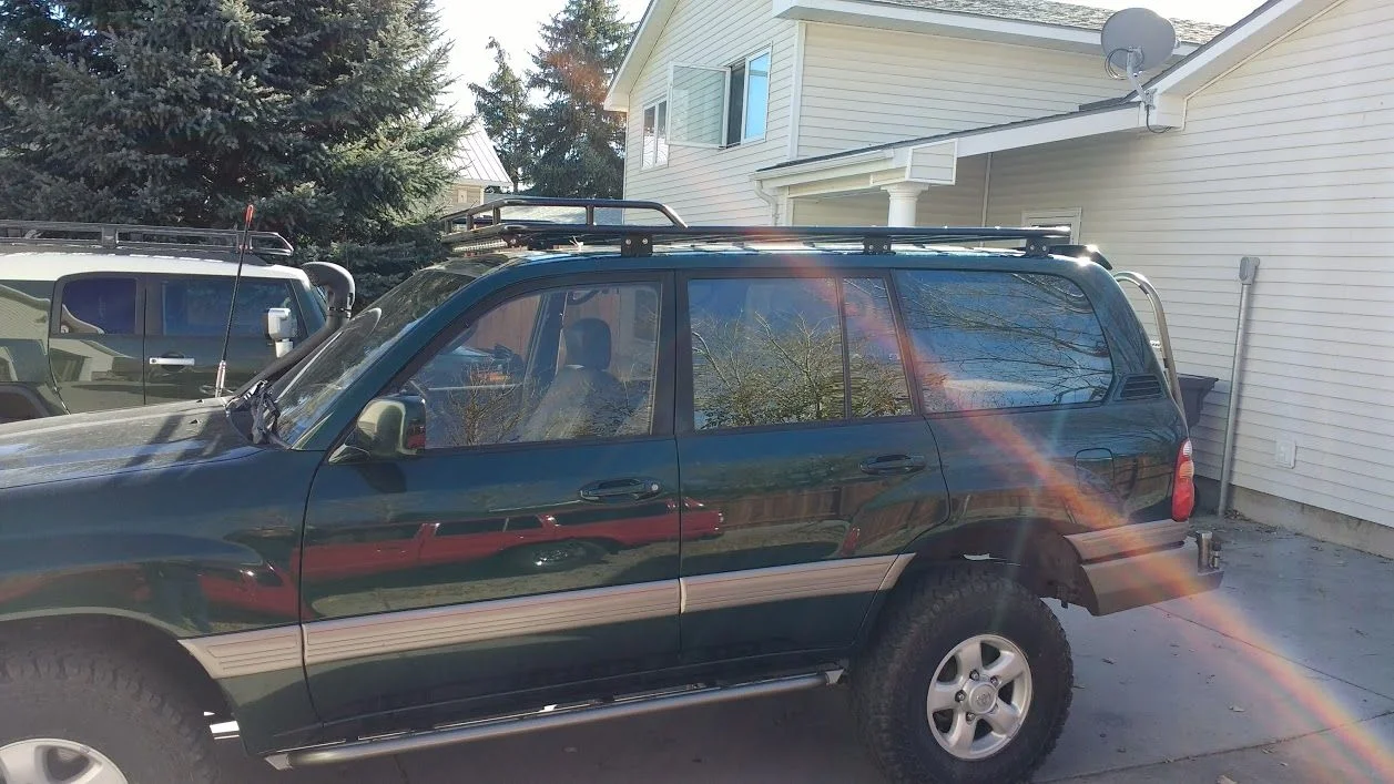

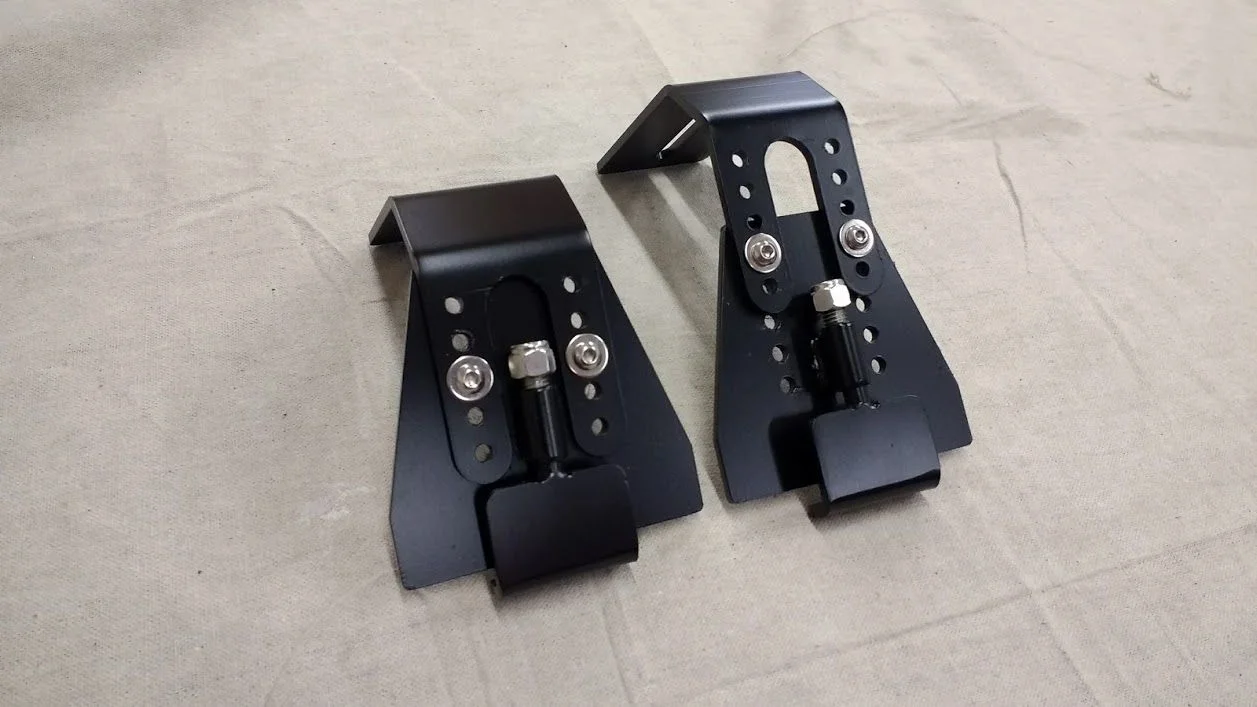

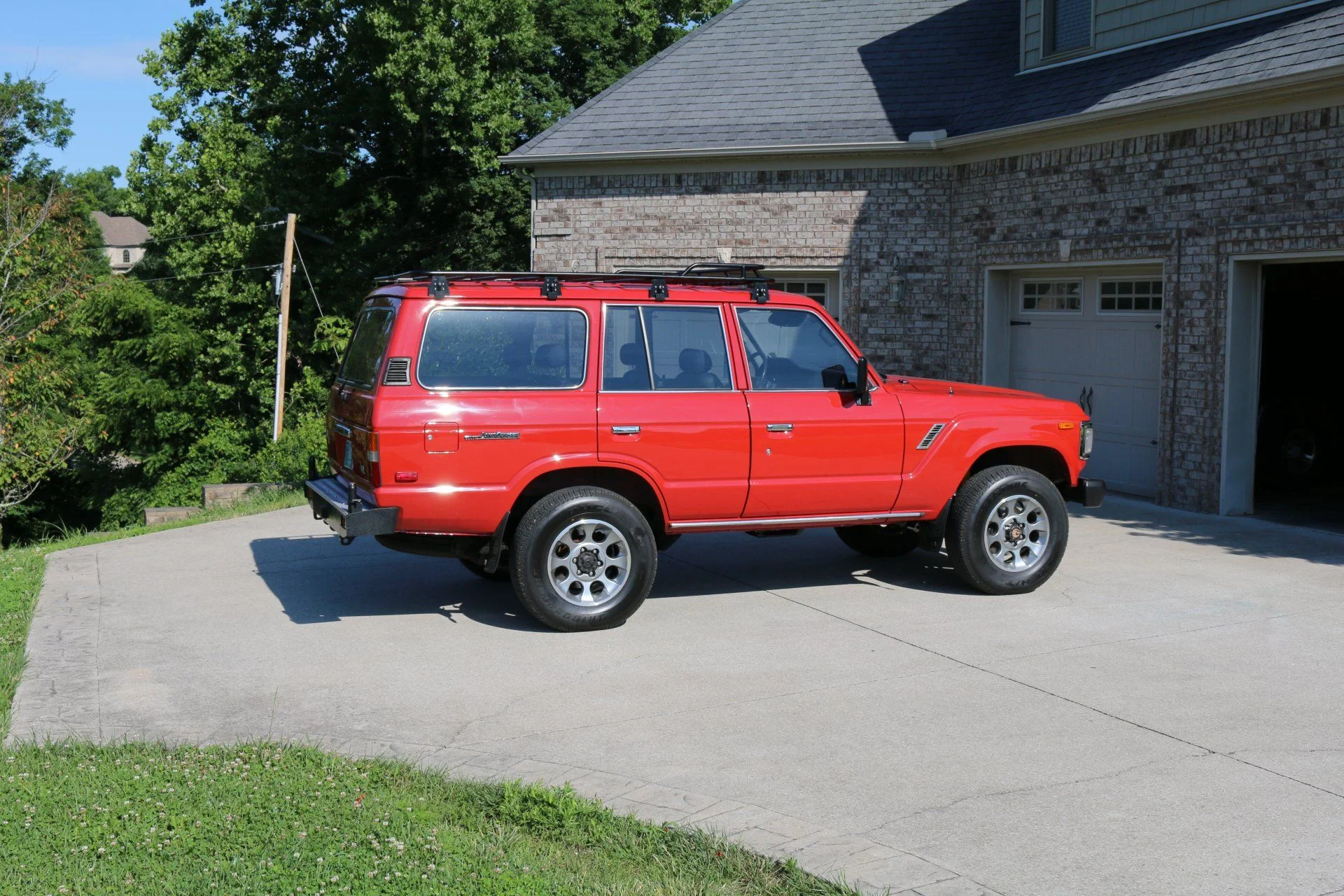

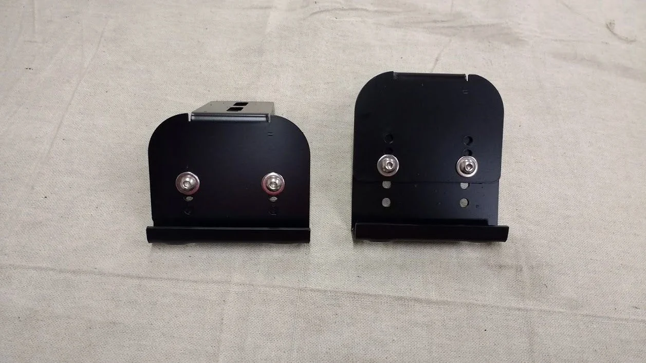

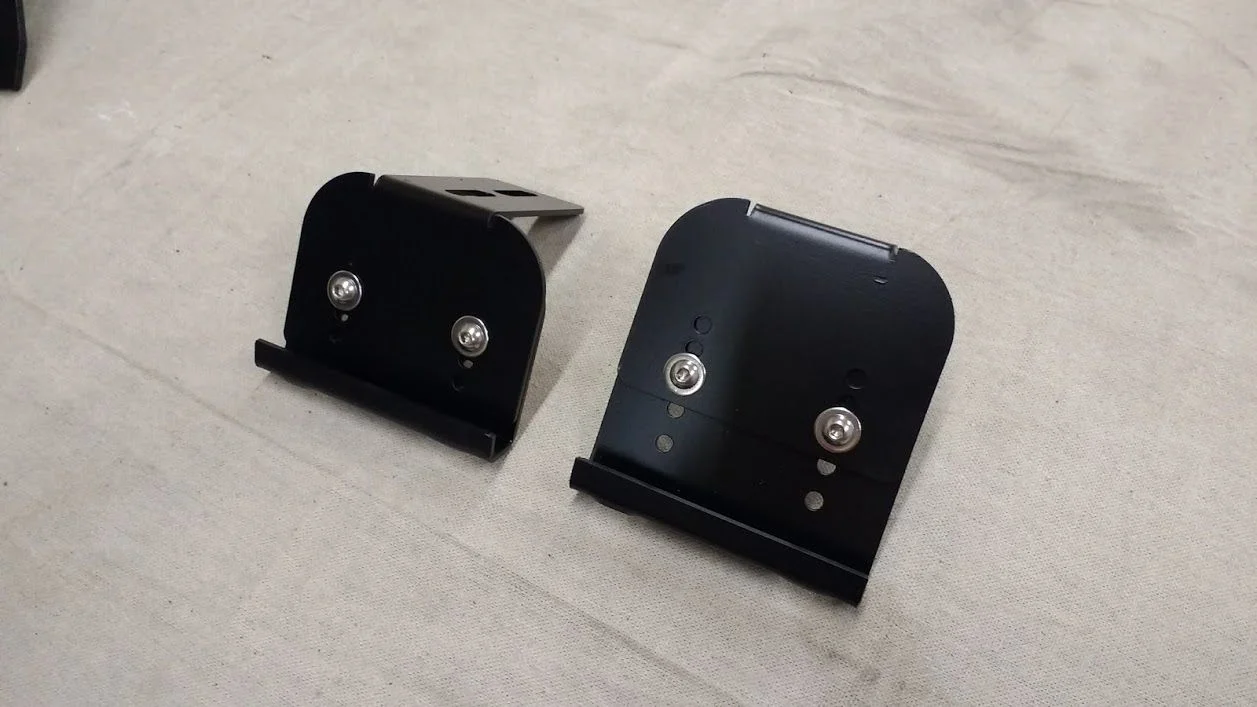

New Lo-Pro 100 rack is installed!!!
Extremely happy with the new mounts and the low profile. Approx. 5/8" off the highest ridge. I weigh 260# and standing on the center of that crossbar I still have 1/2" of clearance. I can live with 1/8" of deflection over a 50" span on 1" tube all day long. The front light bar is about 3/8" off the roof.
Still need to do all my wiring and add the rear rack lights as well.
