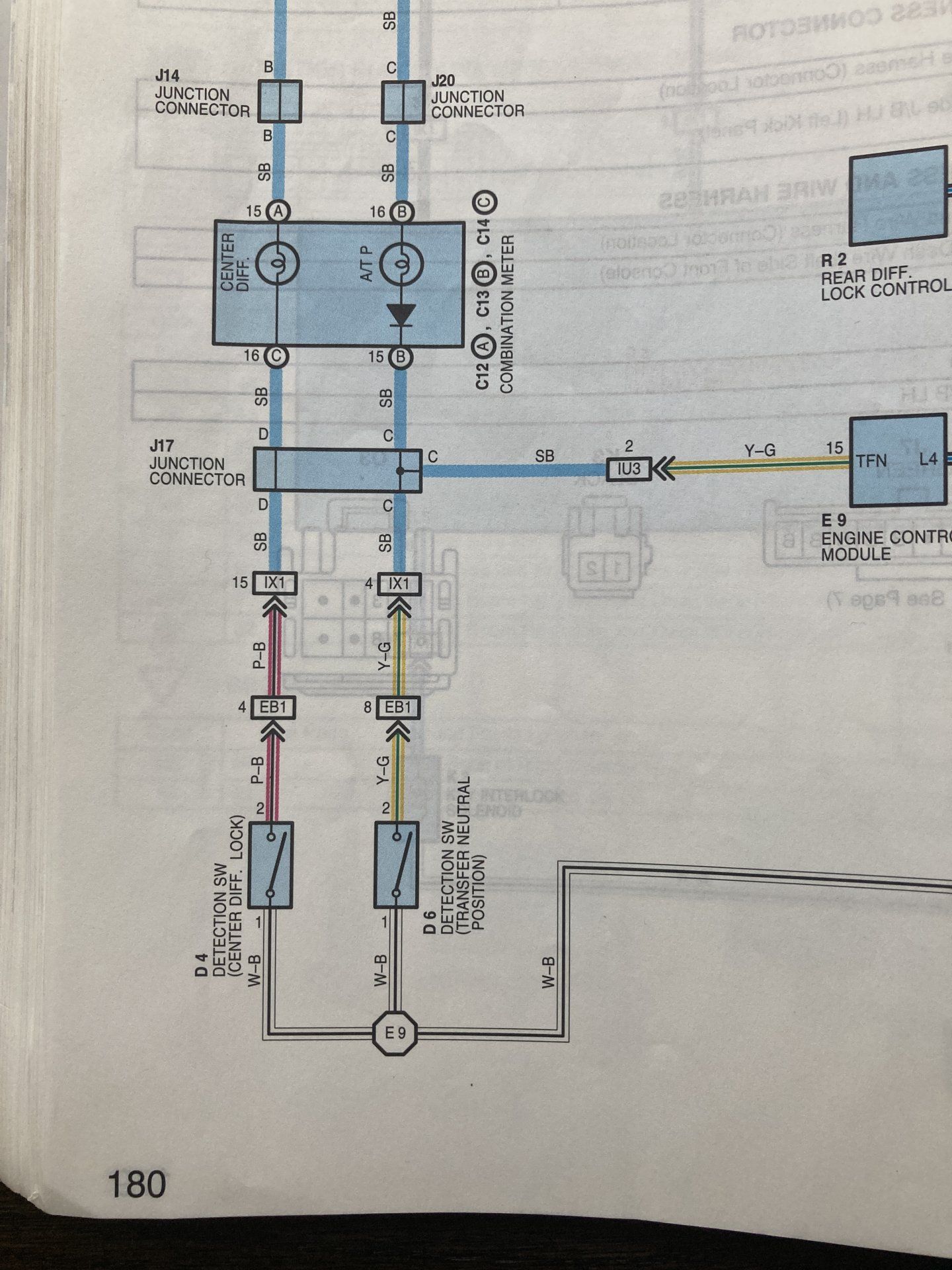

I thought the switch issue only presented symptoms of the lights not appearing on the dash indicating that the CDL was engaged or not. Not that it was responsible for keeping the CDL locked.
I was having trouble with mine sticking. I could get it to disengage, but it took alot of forward reverse neutral. Once I changed the diff fluid, it engages and disengages like a dream. Might want to give that a try if you can't remember when it's been done. Takes about 20 minutes under the truck. There's a "how to" in the FAQ's.
The ecu needs the switch input in order to engage/disengage the cdl. 99 times out of 100 that switch is the issue.
This is incorrect. The detector switch does not provide input to the ECU. The switch only illuminates the dash light.
Correct.
Ya you guys are wrong but whatever. Good luck.
The wiring diagram does not lie.

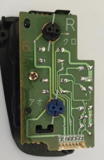

Ok, it sounds like your CDL dash button is faulty. And it’s not just a simple button, it has circuitry on it to electrically “latch” on or off (see pic below). This circuitry may be toast and not telling the ECU that the button is “out”.
To test this you’d need to unplug the CDL (and hazard) switch module and short two other wires together on a connector behind the climate control panel. I just went through this when relocating my CDL and Hazard switches.
