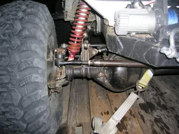

Going back to the pic 1 in the original post. Just gonna run the panhard from the passenger side frame rail to the ds of the axle. Going to have to work the 3rd link mount so that it attatches to the spring pad on the axle. Will probably tie it to a plate bolted and welded to the 2 threaded holes just above and to the ds of the pad.

I have the panhard mounted from PS frame to DS axle on my 40 & am going the same route on my :pig: I did have problems turning, bound up in the rocks, but that may be associated w/ lack of hydro-assist. But now that you mention it :hhmm: it maybe what you're saying is true :confused: Can you elaborate as to why the panhard has an effect on steering as I din't think it would?
A panhard basicaly defines an arc that the axle will travel in from side to side. The longer the panhard, the "bigger" the arc. Bigger is better. There will be less movement of the axle as it droops.
The draglink does exactly the same thing. It defines an arc as well. In a leaf spring setup, when the axle droops it goes straight down (simplified but...). If you were to keep the steering wheel in one orientation the wheels would end up turning to the DS because the Draglink would essentially be "shorter".
Most front link suspension guidelines tell you to make the panhard bar and the draglink as close to parallel and about the same length. If you did both of these things perfectly, then there would be no bump steer. That is pretty tough tho.
Say the draglink is mounted on the DS frame and the Panhard bar is mounted on the PS frame. As the axle drops something has to give. The panhard is hard mounted to the axle and frame. The Draglink is mobile (wheel turning) and will have to move to match up to the axle movement.
When the axle drops it will want to move towards the passenger side because the panhard bar forces it to. If you hold the wheel straight, the tires will turn to the DS because you are moving the axle away from the dS of the truck.
If the articulation is significant enough, and the orientation of the PH and DL are far enough off.. It is possible to lock the wheels to the DS and not be able to turn them.
