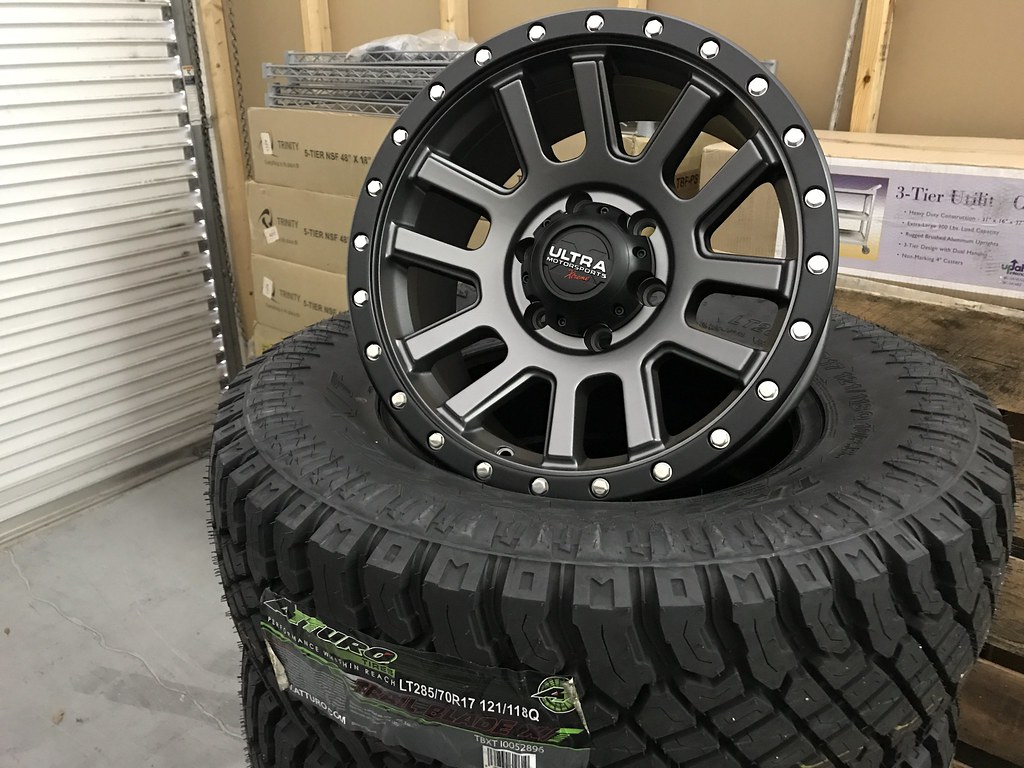

Atturo Tires Trail Blade XT LT285/70-17
Ultra Racing 107 Extreme 17x8.5 1 offset

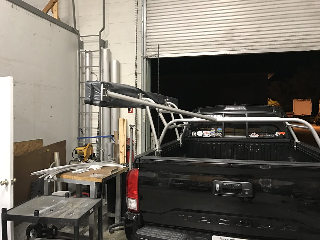

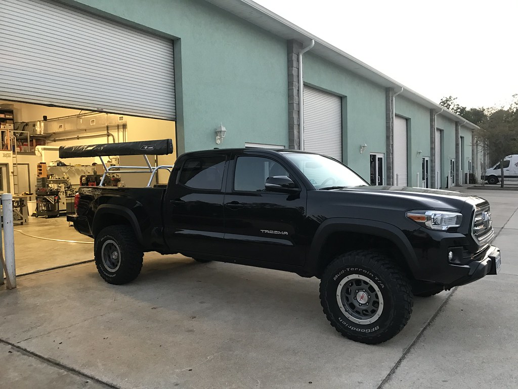

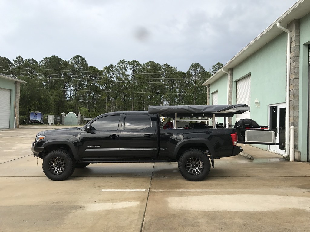

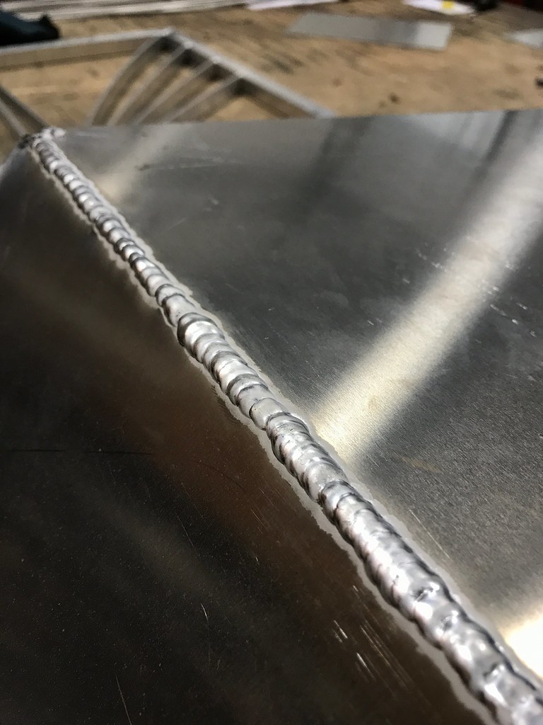

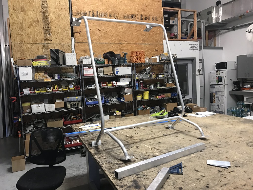

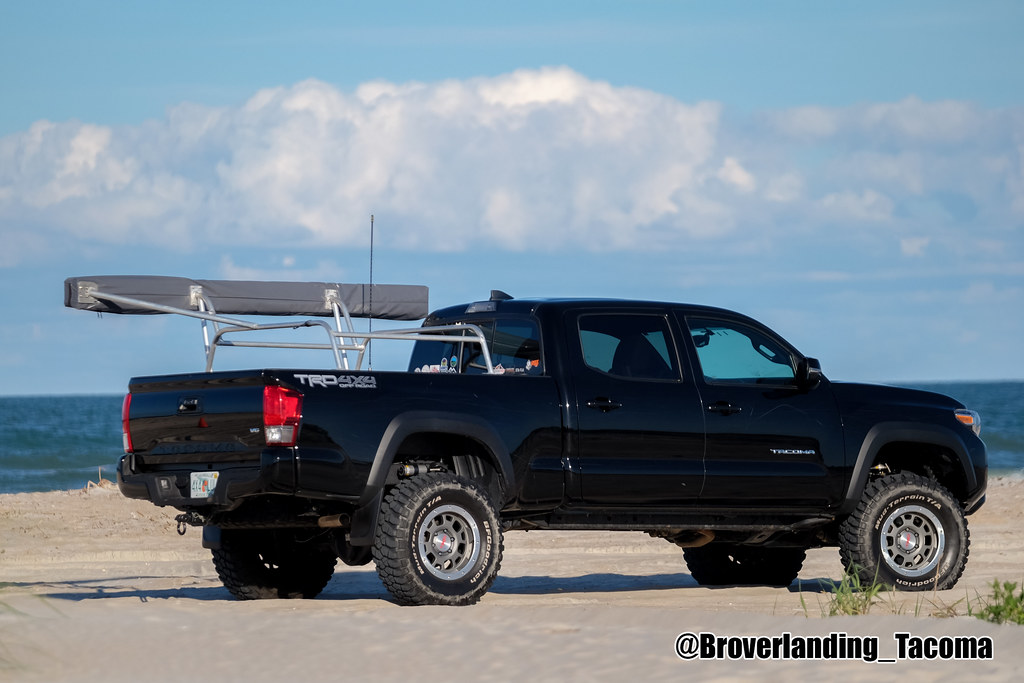

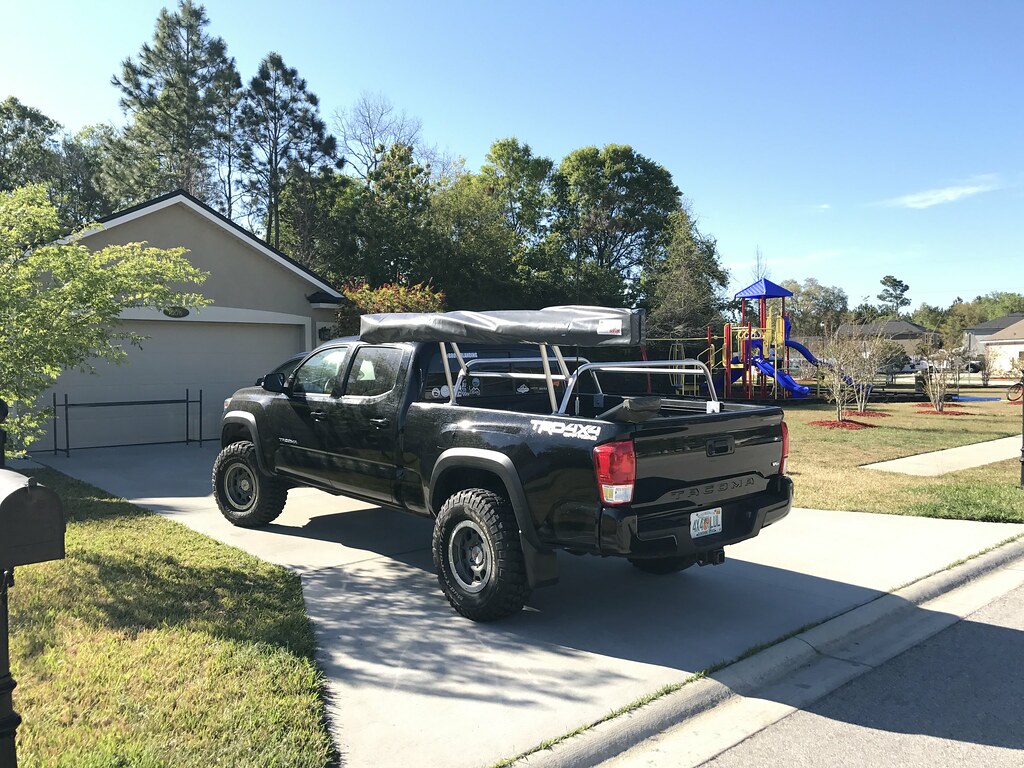

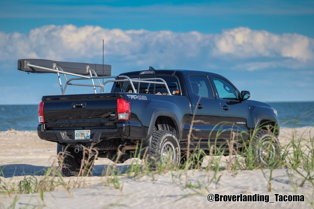

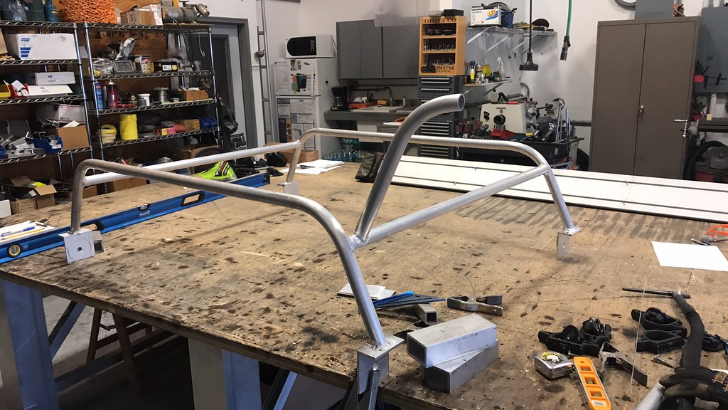

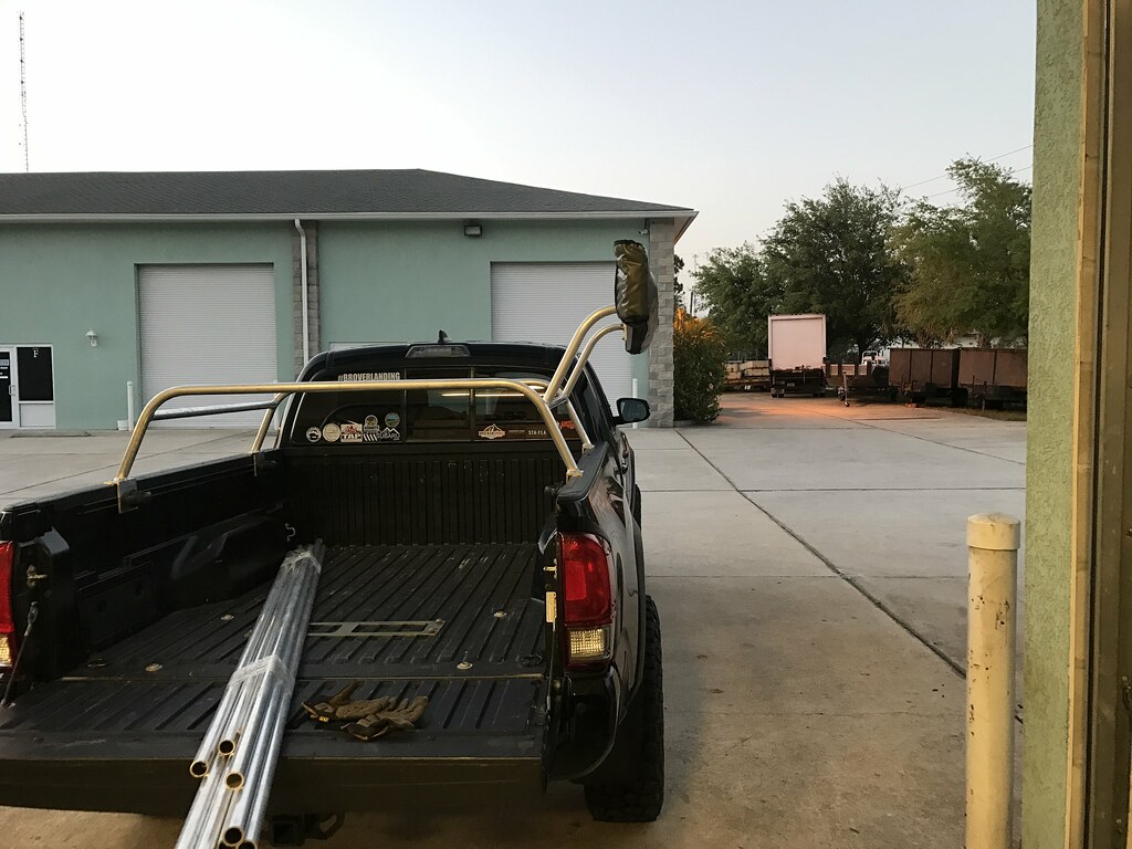

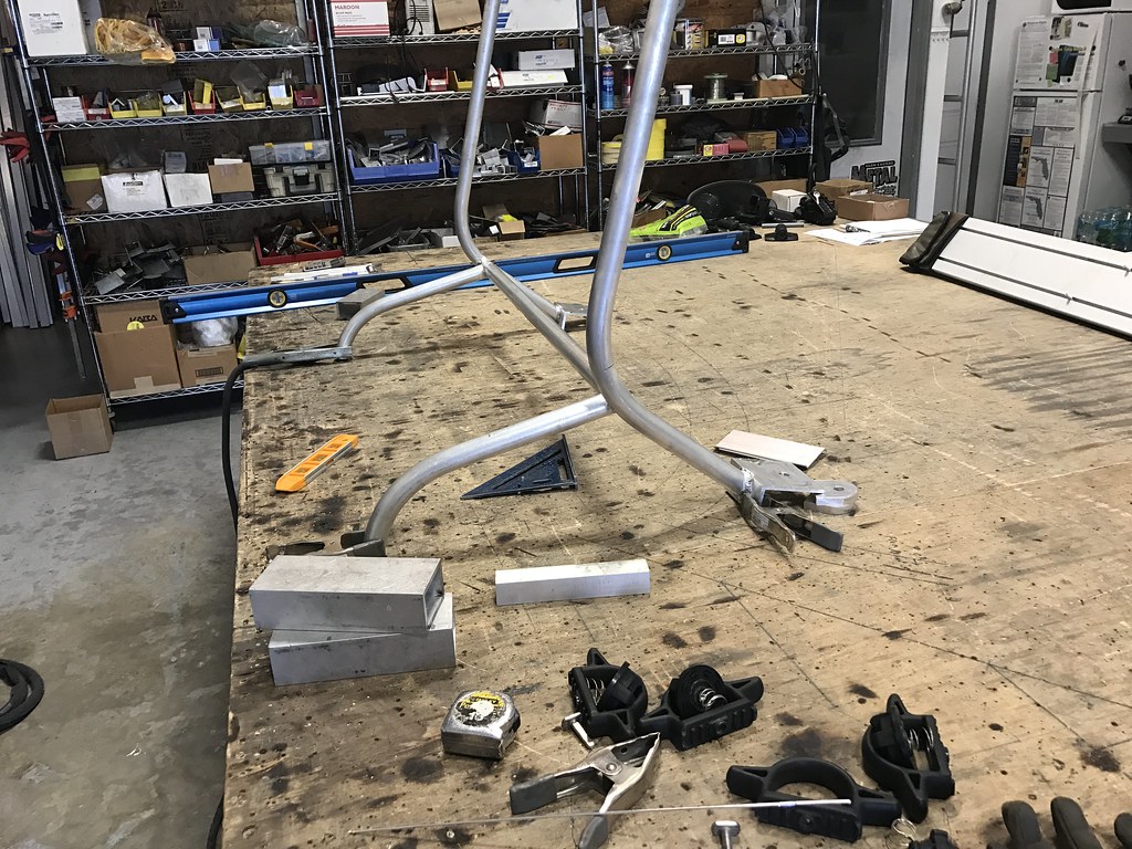

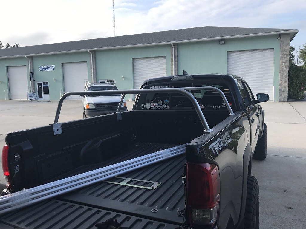

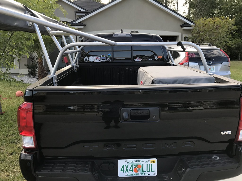

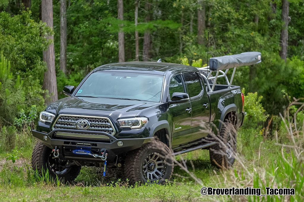

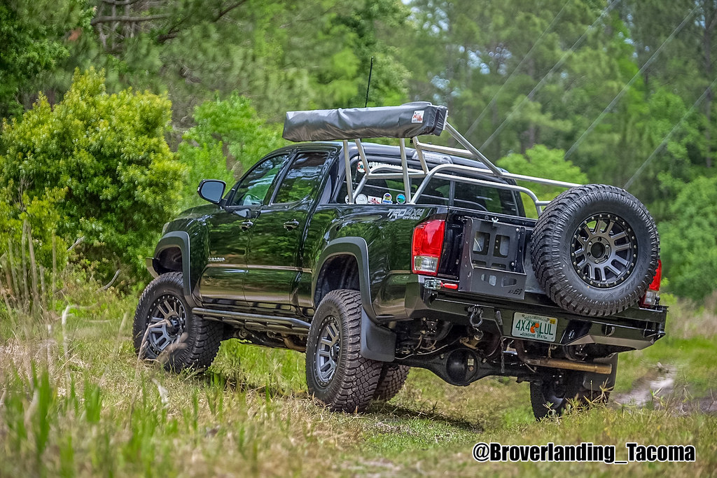

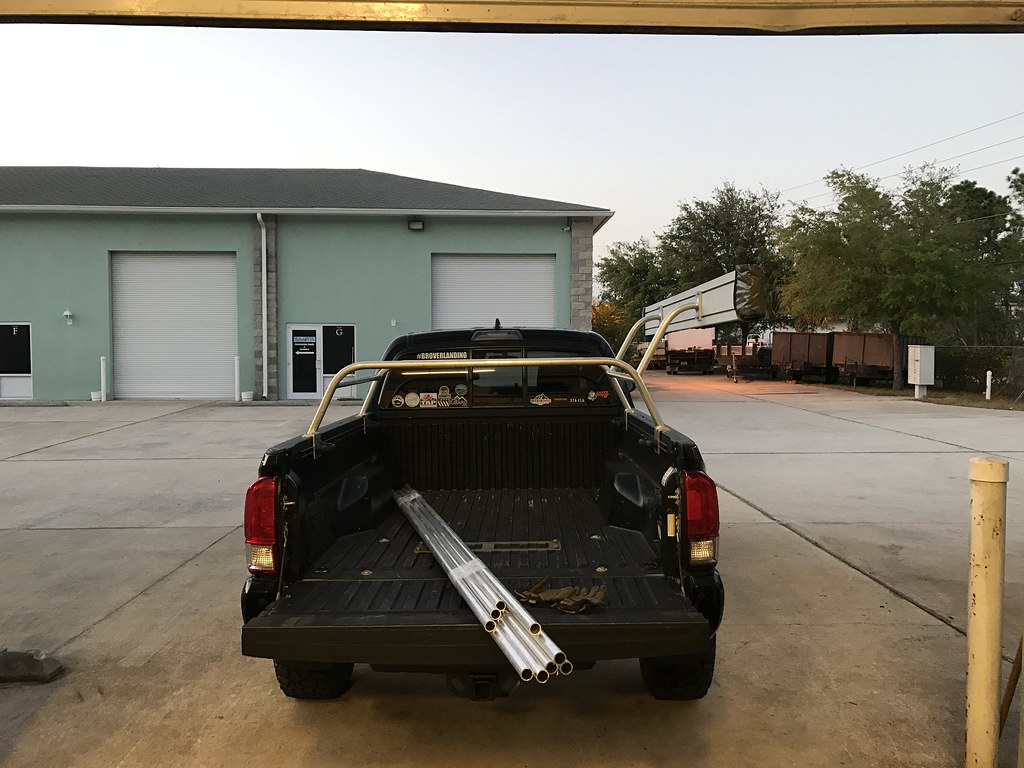

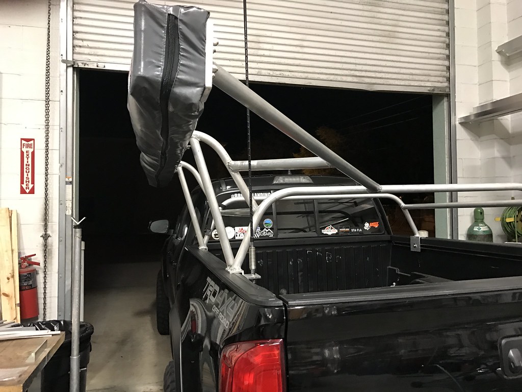

Decided I wanted to mount my FoxWing awning from my trailer.
I had some aluminum tube around, and some other ****, so i made a rack and awning mount. Not sure why noone offers this as an option. I may suck the awning in about 1.5-2" but at this point, its the same exact height as an awning mounted to a roof rack, clears the door and fits the bed perfect to wrap around
Untitled by Grant Wilson, on Flickr

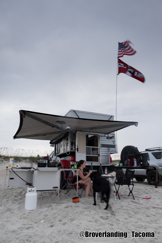

Decided to hit up the beach before i put the camper back in the garage. Love me some beach mornings! mid 80s and no wind. amazing

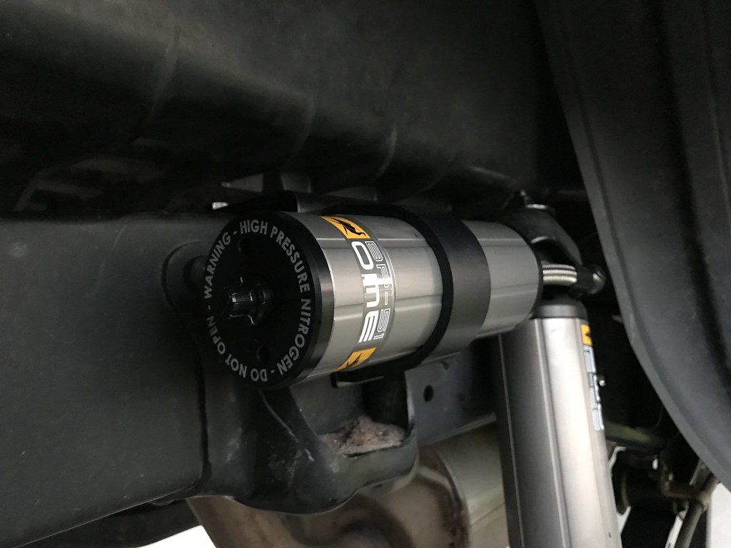

bp51 install by Grant Wilson, on Flickr

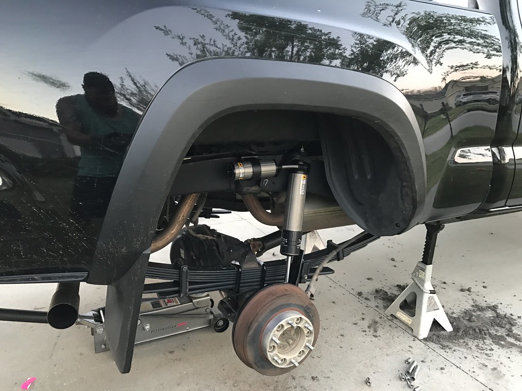

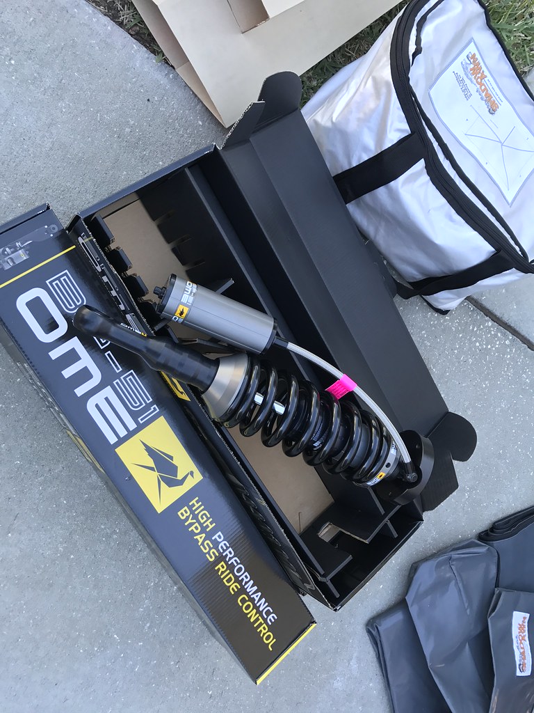

after loading the pallet in the truck, i got home and ripped into my new box from OK4wd.
BP51, Alucab walls, and an awning cover were among the package contents.

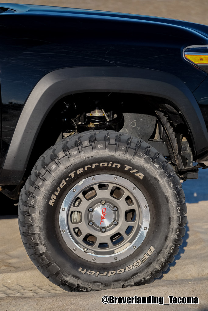

Wasted no time. Rears are in and done, fronts will go in tomorrow after work and an alignment appt on sat morning
took it for a spin around and down a little trail.
This is night and day. YOu can literally feel the difference front to back (5100 in the front). No adjustments yet, but something as little as exiting the driveway (we have a pretty big drop thing at the end) and its like it isn't there now. Insanity
All is done and put together!
BP51s on and SPC UCA on as well. Can't be happier. Smoothed out so much stuff and overall a great ride. Once i get the bumpers on, im sure it will soften up a bit with some weight on it. Gonna be great!
2015 Toyota Tacoma by Grant Wilson, on Flickr
BP51 by Grant Wilson, on Flickr

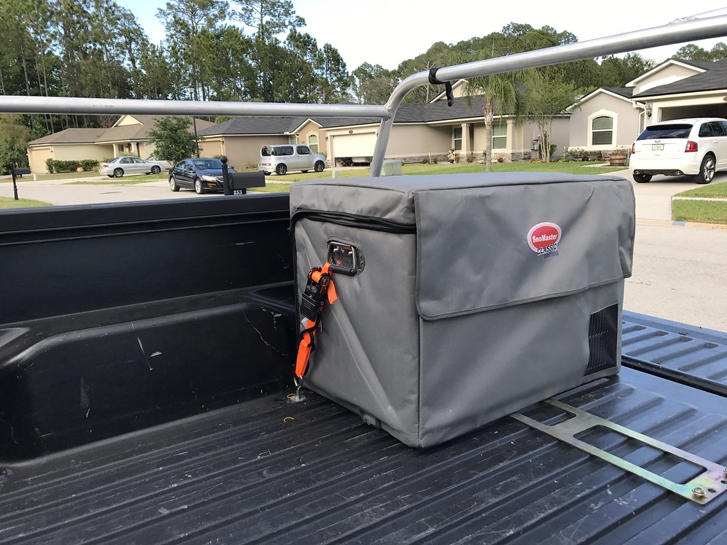

Got my Snomaster 60D in!
Will fit well in the camper as well (they use a national luna 6o in there now!)
KNOW I am ready for the weekends
Snomaster Fridge by Grant Wilson, on Flickr

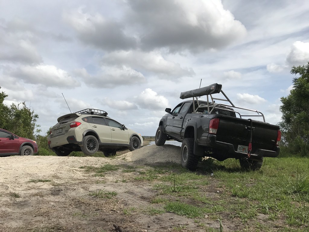

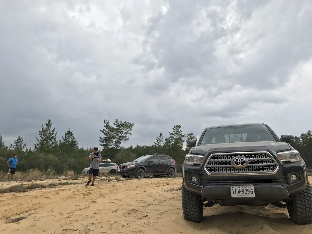

Went out to Ocala National Forest and had some fun with some Subie friends. Alot of hard parking and sunbathing (well under the awning)
But i did get to test out the BP51 pretty aggressively

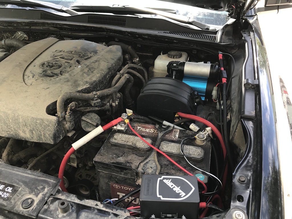

installed the ARB Compressor under the hood, just behind the fuse box (Insert photo when i get off the couch)

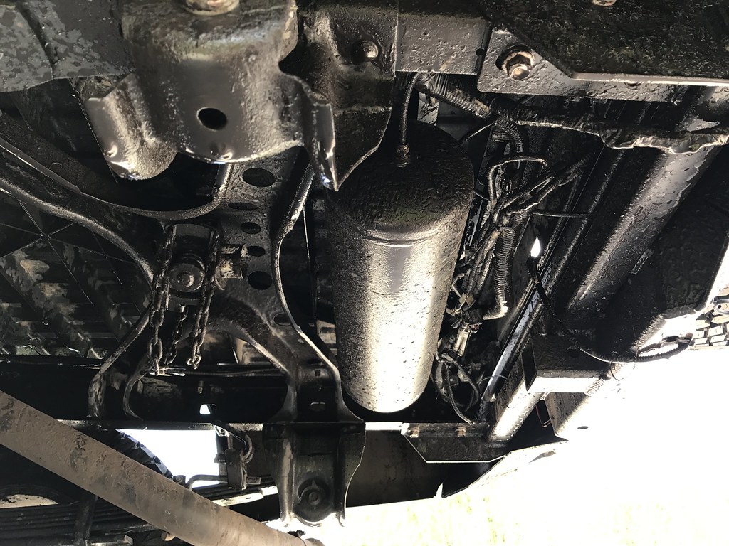

Put the air tank under the bed at the back

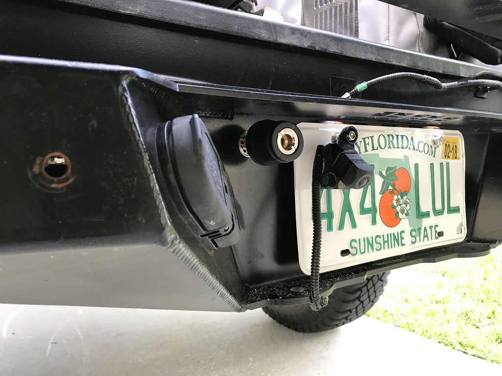

Air chuck in the rear bumper
Bumper Air Chuck by Grant Wilson, on Flickr

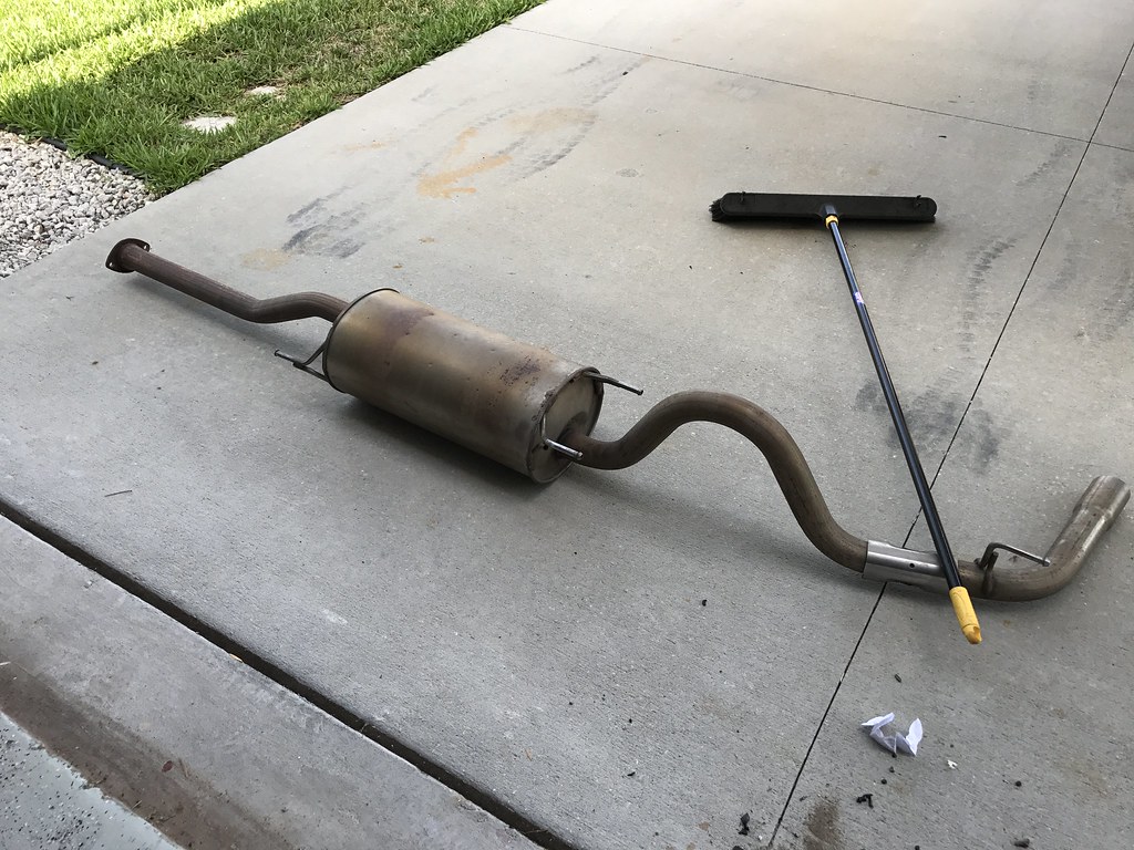

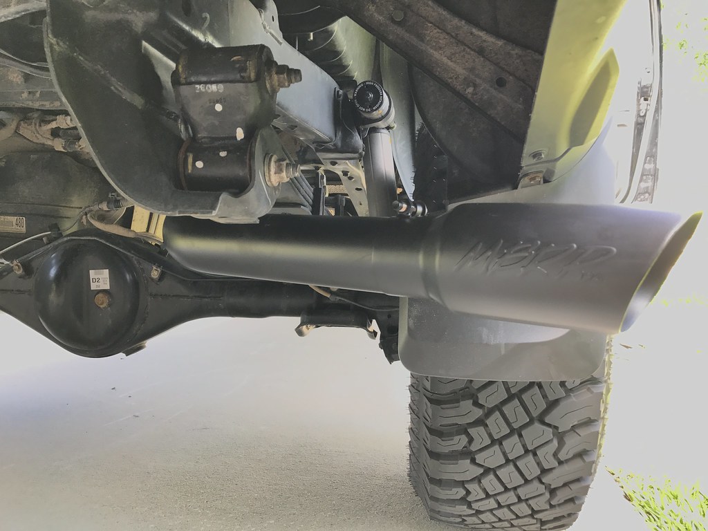

Removed the stock exhaust
Old Stock by Grant Wilson, on Flickr
and put on the MBRP Stainless Black exhaust
MBRP exhaust by Grant Wilson, on Flickr
Sound is mild, not really annoying at all. I will be doing a video once it breaks in.

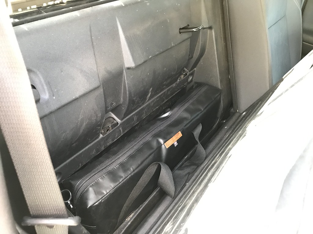

Got me some Go Treads and a Blue Ridge Overland Gear Bag for them as well as some other bags that ill throw out in another post update about all the bags i carry and whats in them.
Go Treads by Grant Wilson, on Flickr
The best part. They fit perfect behind the passenger rear seat!
BROG Bag by Grant Wilson, on Flickr

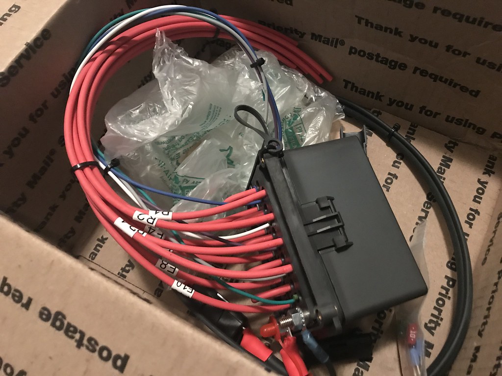

OK. Some people asked for some air picture ****.
Here you go
Iggycorp electical box by Grant Wilson, on Flickr
IMG_5028 by Grant Wilson, on Flickr
You can see the new Iggy Corp relay box, and the compressor up there.
The wiring can now get cleaned up. Winch power wire shortened, Northstar battery ordered, And everything wired through the IggyCorp System! I hate a bundle of wires.

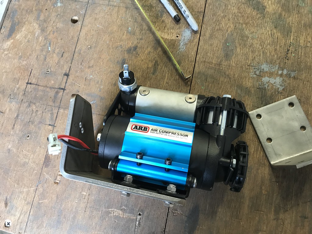

Had to make a mounting bracket.
Started with some crap channel i had laying around
cut a side off, sanded all the edges round, and cleaned it up
Notched for ground wire, and holes for mounting
bracket installed
drilled two small holes and used 8-32 screws with rubber washers for vibration and locknuts.
Everything i use is either aluminum or stainless steel. No corrosion issues here!
Air compressor by Grant Wilson, on Flickr
Built the compressor bracket from 1/4" stainless as well.

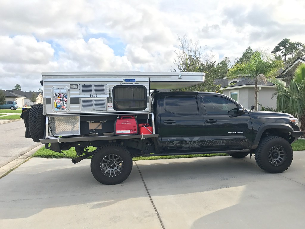

Also, a deal came up on a Fleet Four Wheel Camper I cannot pass up. Heading up to PA on the 19th to grab it. That wil turn into a 5 day roadtrip hitting Philly for a cheesesteak, onwards to DC for some museum love, and im going to try to do some exploring in VA on the way back. WE will see
The weekend after we get back will be going to Amelia Island to camp, then the weekend after that Ocala with a weekend camping in Disney sometime soon after that.
Tons of fun!

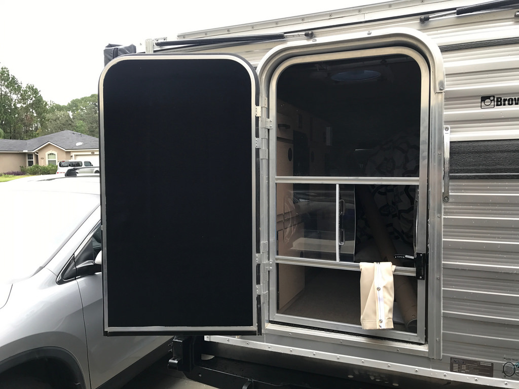

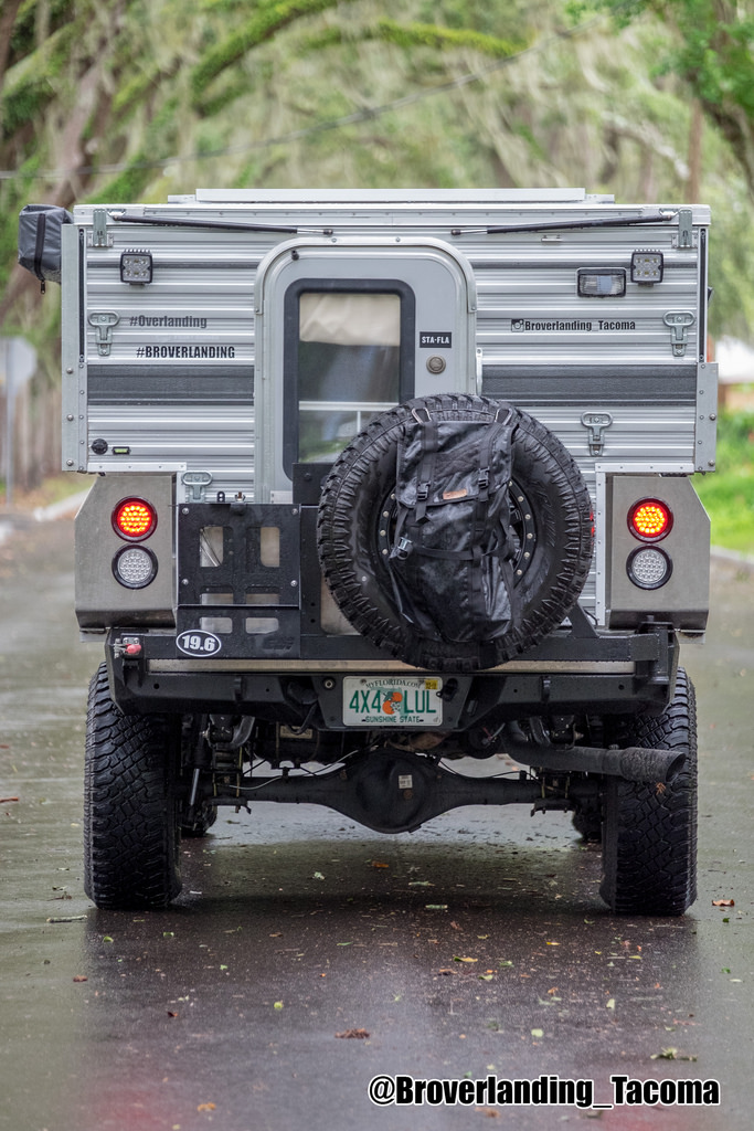

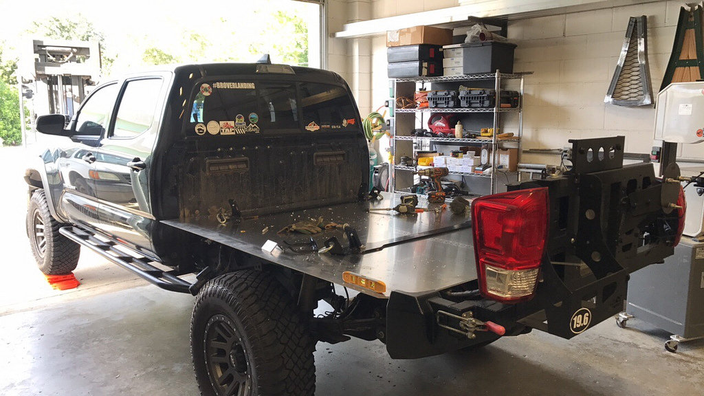

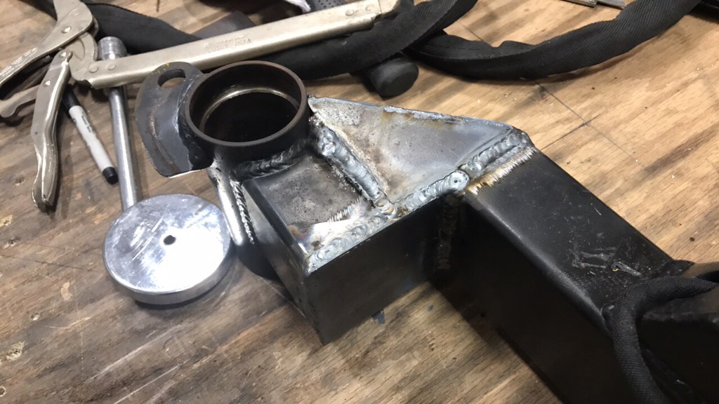

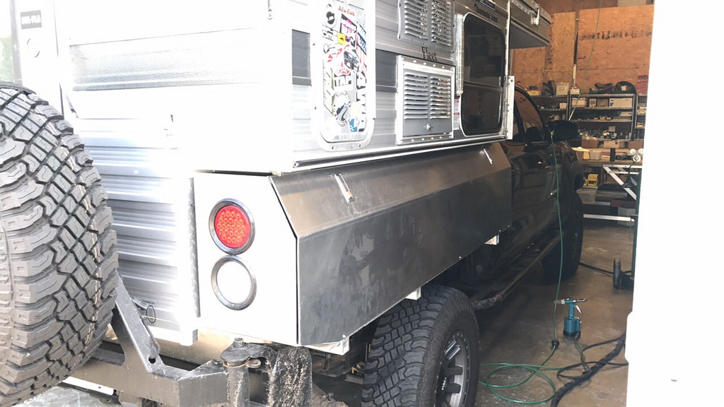

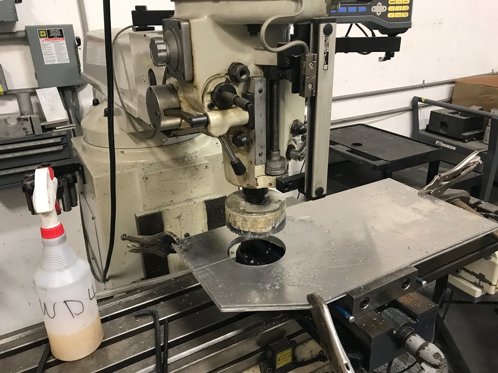

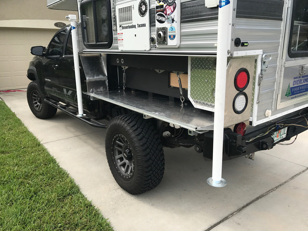

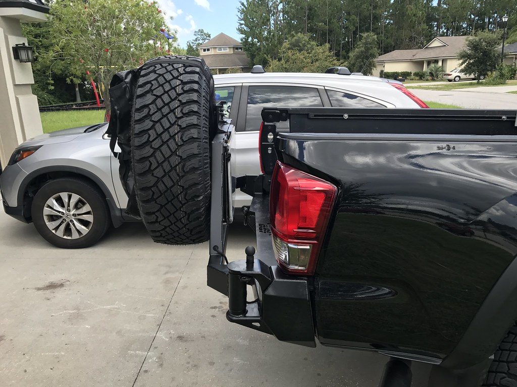

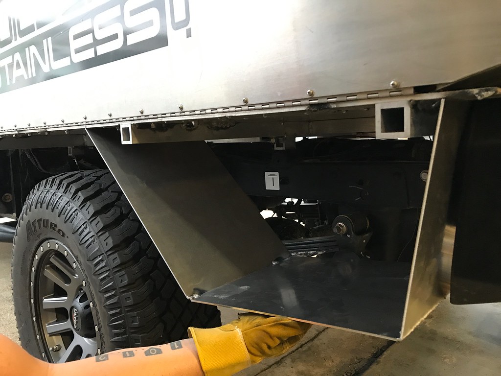

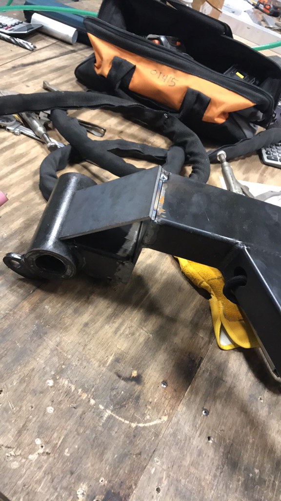

had to modify the CBI swingout to fit the camper
Pretty damn satisfied!

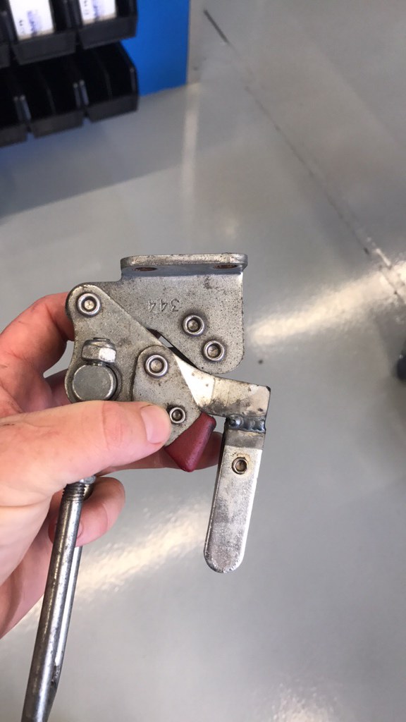

And its all back together
an inch and a half to spare for the 81" i need for the Four wheel camper
Also messed up with not thinking about the latch. Fixed it tho.

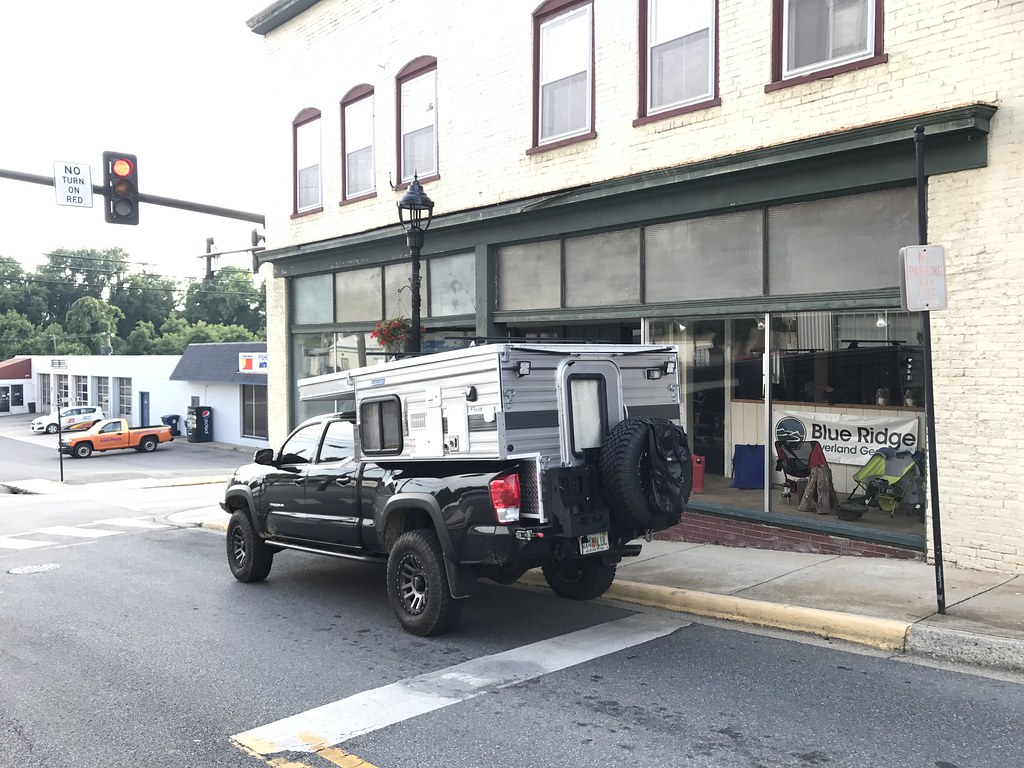

Made the two hour trip to Mainline Overland through some pretty awesome roads where we got the Fleet Slide In camper installed!

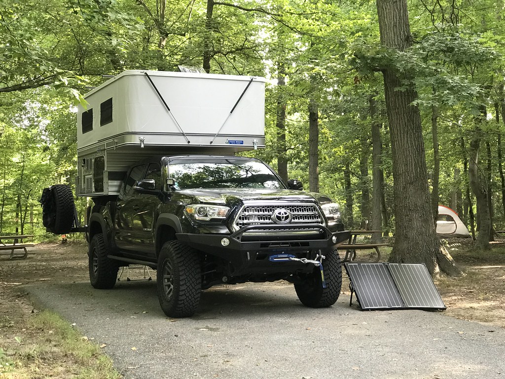

From there we hit our camp spot for the night just outside of DC
Broverlanding_Tacoma by Grant Wilson, on Flickr

Last stop was a quick tour of the Blue Ridge Overland gear shop. These guys are an amazing company. Quality products all made in house with awesome people. Reaffirms why I love their stuff, and use a ton of it.

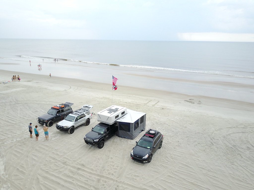

This weekend decided to go Beach camping (yeah, its a recurring theme around here)
We started the day out in Historic Fernandina Beach downtown area and grabbed some lunch and walked around. Cool little place we havent been before.
Wife had a Lobster Corn Dog. Said it was Heavenly.
Gratuitous beach pictures from here on out
The newly adapted Renogy solar suitcase, mounted with some aluminum angle to the tracks

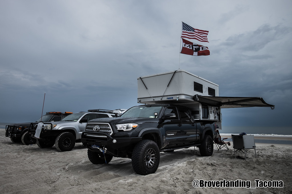

Storm started rolling in unfortunately
Amelia Island by Grant Wilson, on Flickr
The rain was off and on through the afternoon, but we couldn't just turn back with the awesome mid 70s weather.
Made some dinner on the trail kitchen setup
And some propane campfire time in as well with peoples

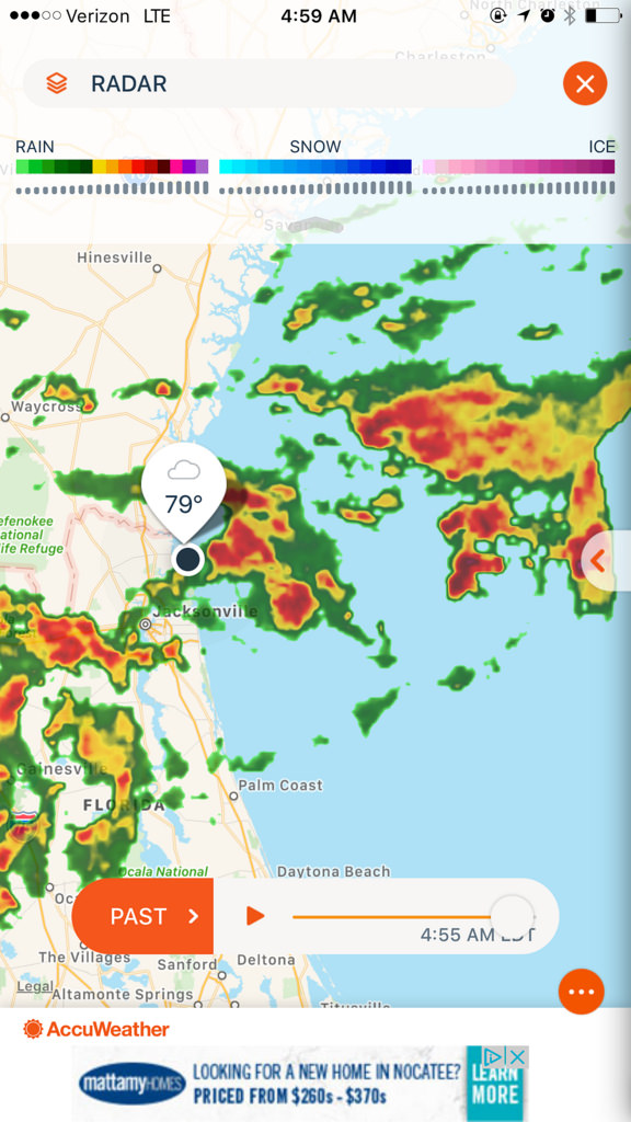

The storm got much much worse over the night. 40+mph sustained winds based on the local airport 1.5 miles away inland. Lots of rain.
Other than the sound of the rain on the rooftop, you would have never known. No wind noise, no real issues through the night other than some rain through the fans. Gotta find some covers or something else to do with it.
this was everything that rolled through from west to east. this shows it just passing.
this video was about 9 am

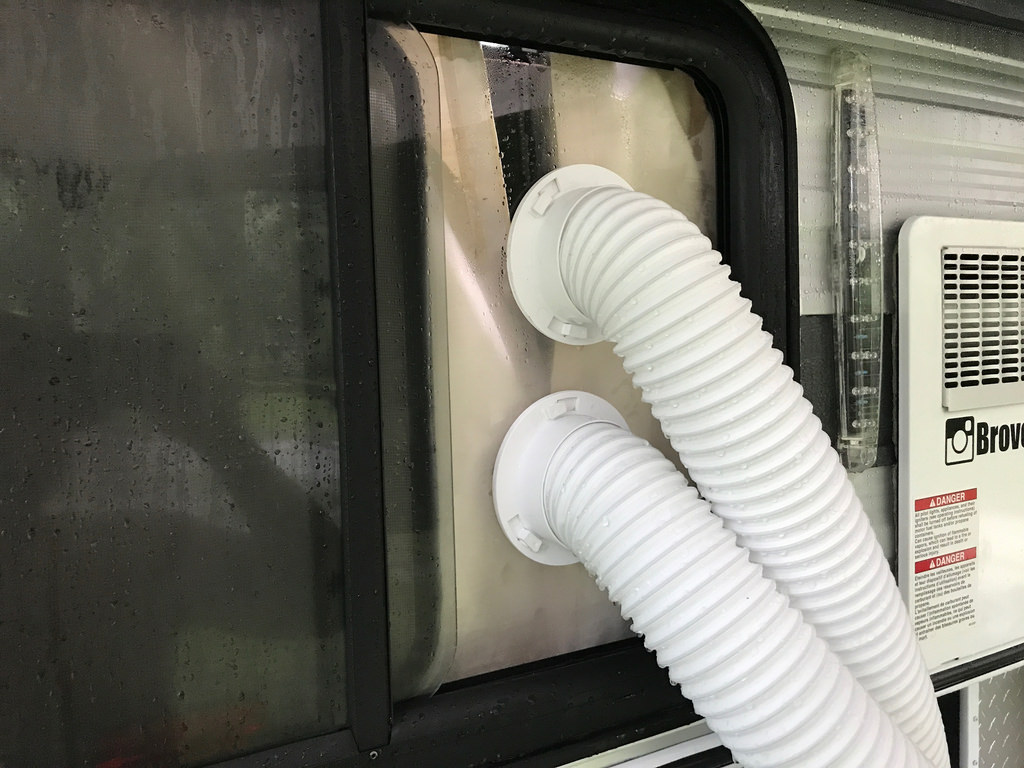

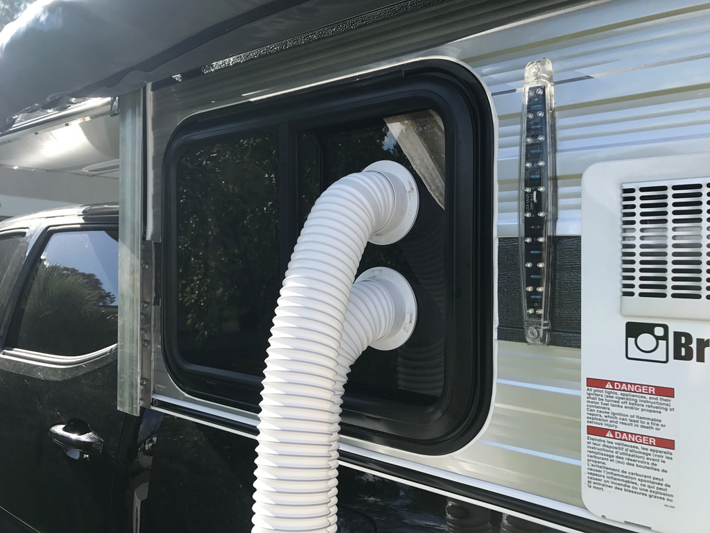

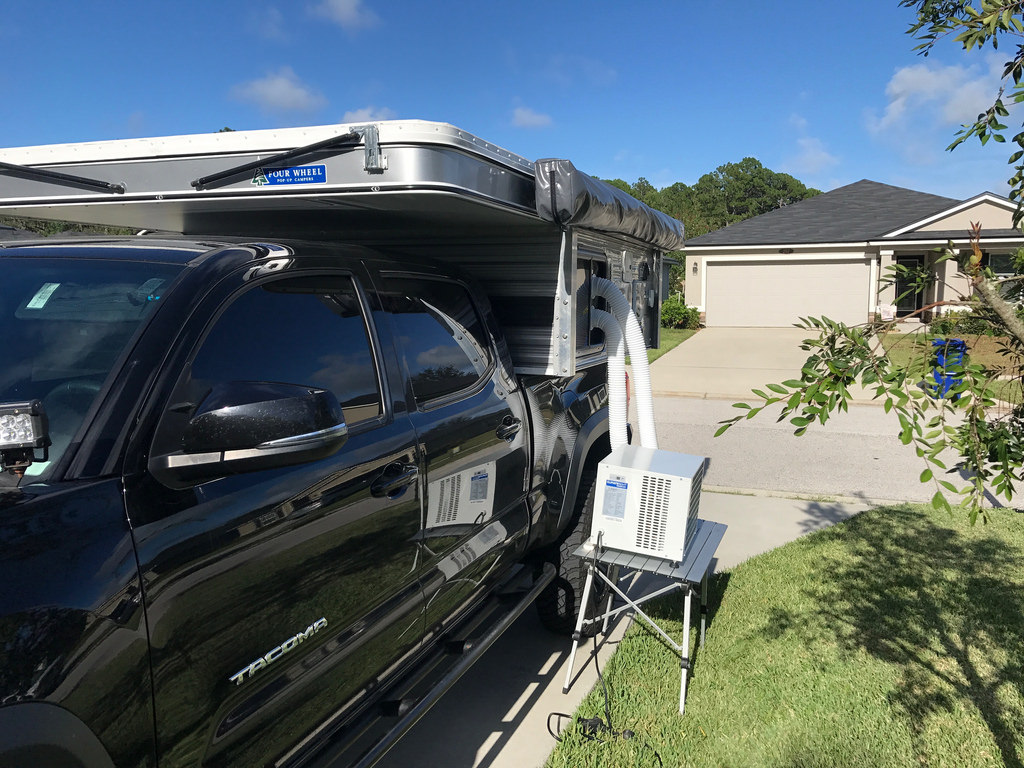

Wife wanted an AC unit, so i gave her an AC unit
Climate right 2500 is what i used in my teardrop, so i got another one for this.

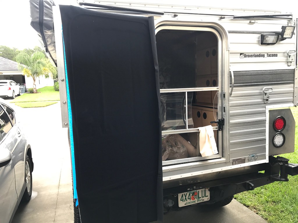

I built a plexi window insert that fastens via velcro to the inside of the window frame. Brought it down to 72 degrees in a 90 degree day, and removed all the humidity. Win!

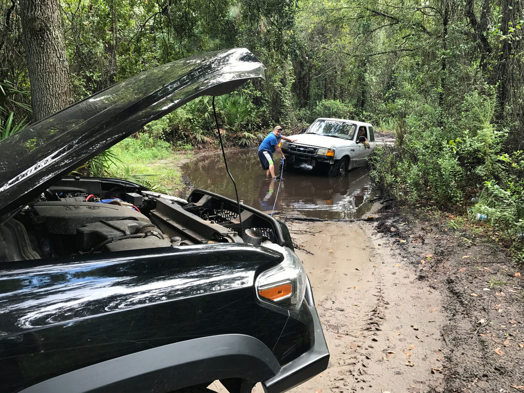

But first, at the intersection of I95 and i4, i saw this lil guy off across the ditch, and could have sworn i saw someone in there. Turned around in the grass and checked it out. College aged gent that couldn't get a tow truck to help. So i figured i would.
He hooked a strap to his wheel and i janked him out off the other bank, through the ditch and back up to the main grass.
He was able to pull the fender liner out and continue on his way. I assume with little to no issue. Got him out of the rain and back on his way. Happy days

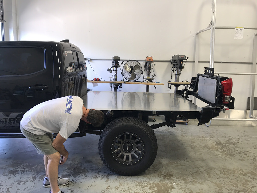

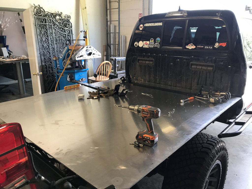

We took a bet to see if a sheet of 1/4 aluminum would work without any additional bracing for a flatbed and the FWC. I wasn't very convinced it would, coworker said it would.
Spoiler, it doesnt.

countersunk the hardware for the air tank so it stays smooth
Threw the camper on and it works.
I don't like how the mounts are there, so I will put in some stainless eye bolts to clamp the camper down and save about 4 inches of storage space

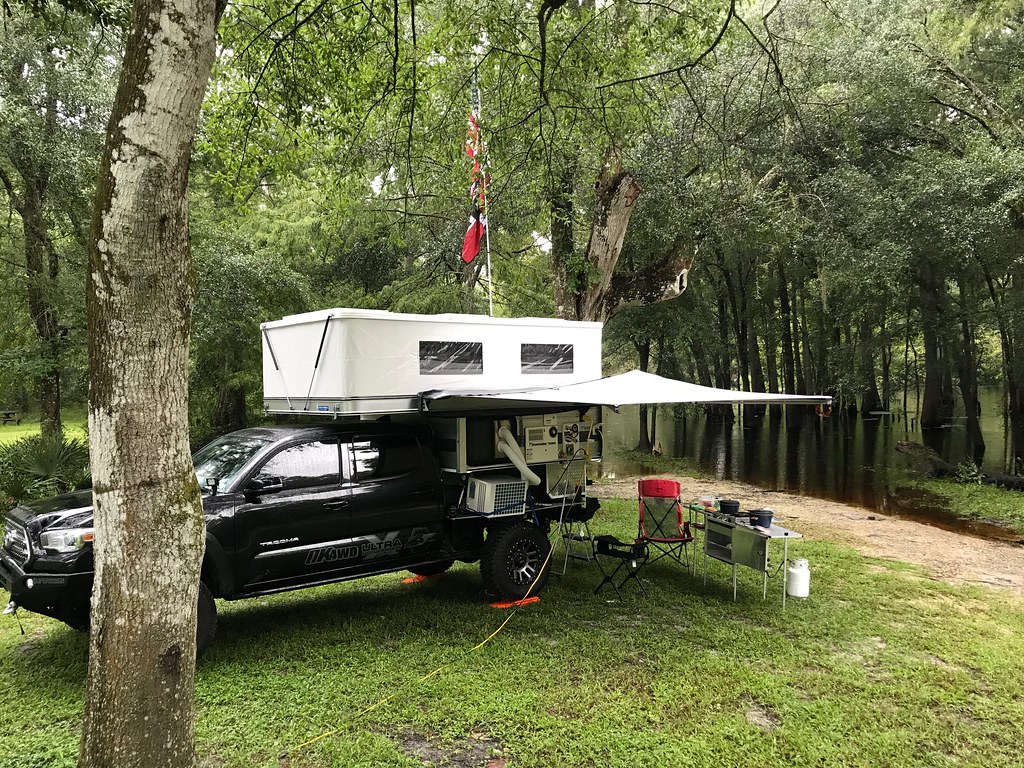

Set up at our campsite for the weekend near the Withacoochie river (i think its actually withlacoocihe or something). We went to see the mermaids at Weeki Wachee and grabbed some food as well

I have already pulled the camper again, and working on the substructure of the flatbed. Side boxes and rear plates with tail lights should be mostly done by the end of the weekend.

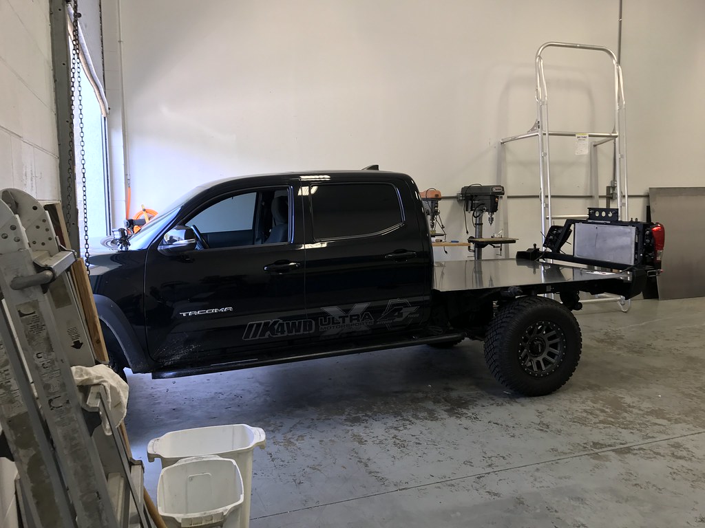

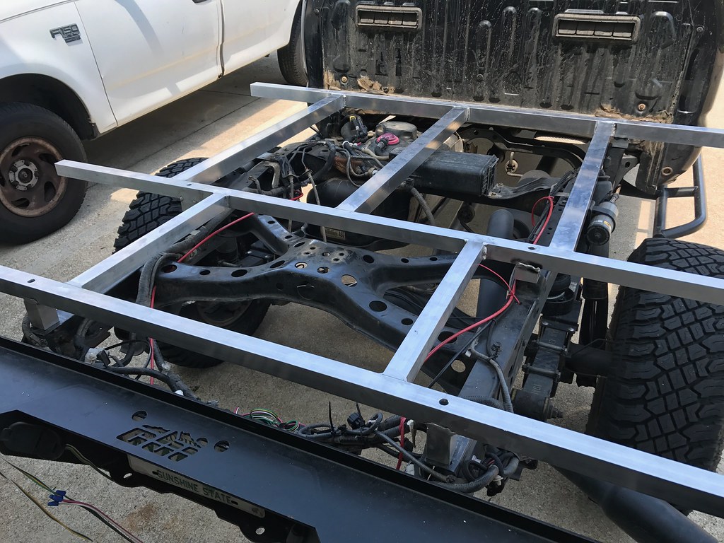

Ive been a little lax in updating this, but alot of stuff has happened.

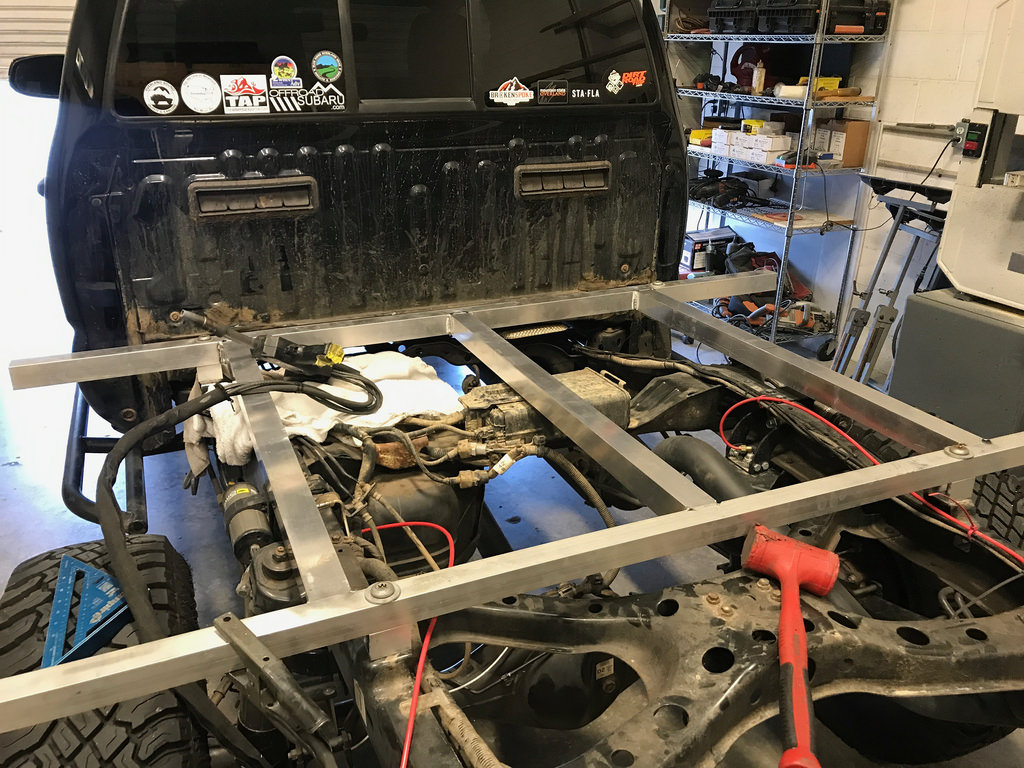

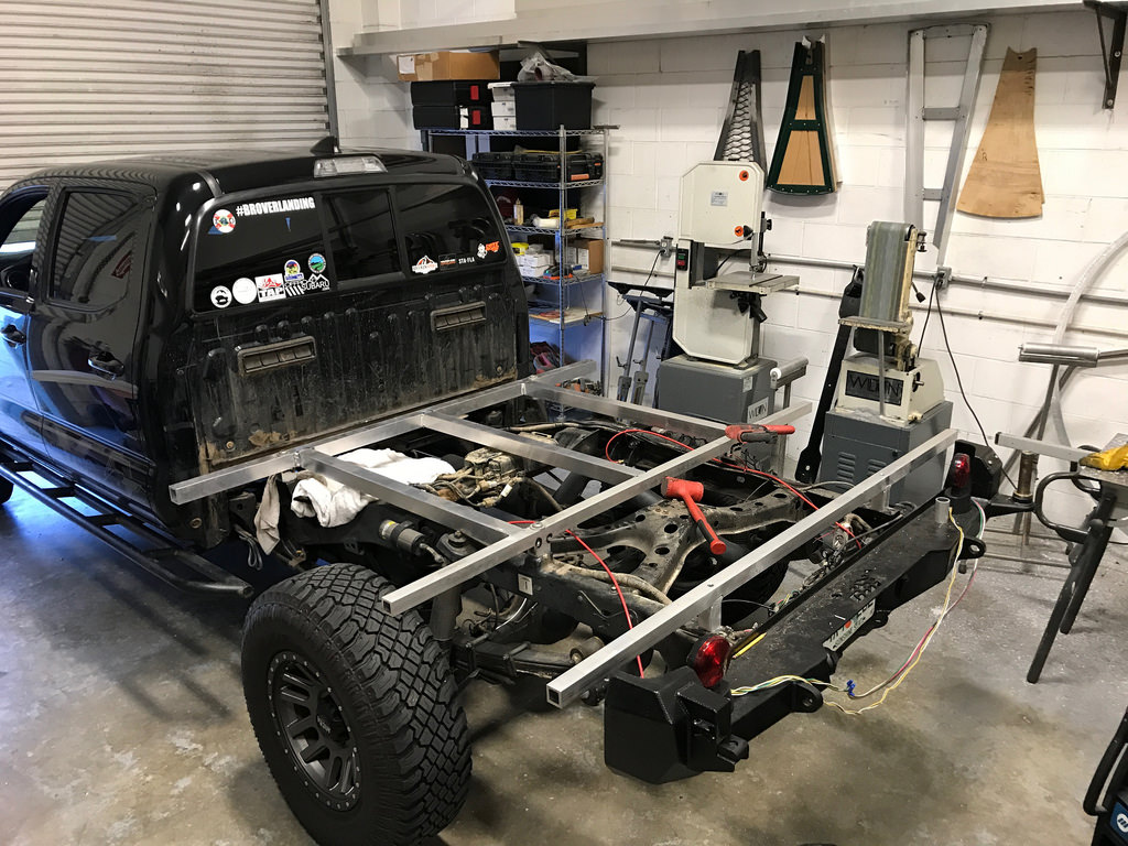

Old bed setup was just bolted to the frame. no structure. No bueno

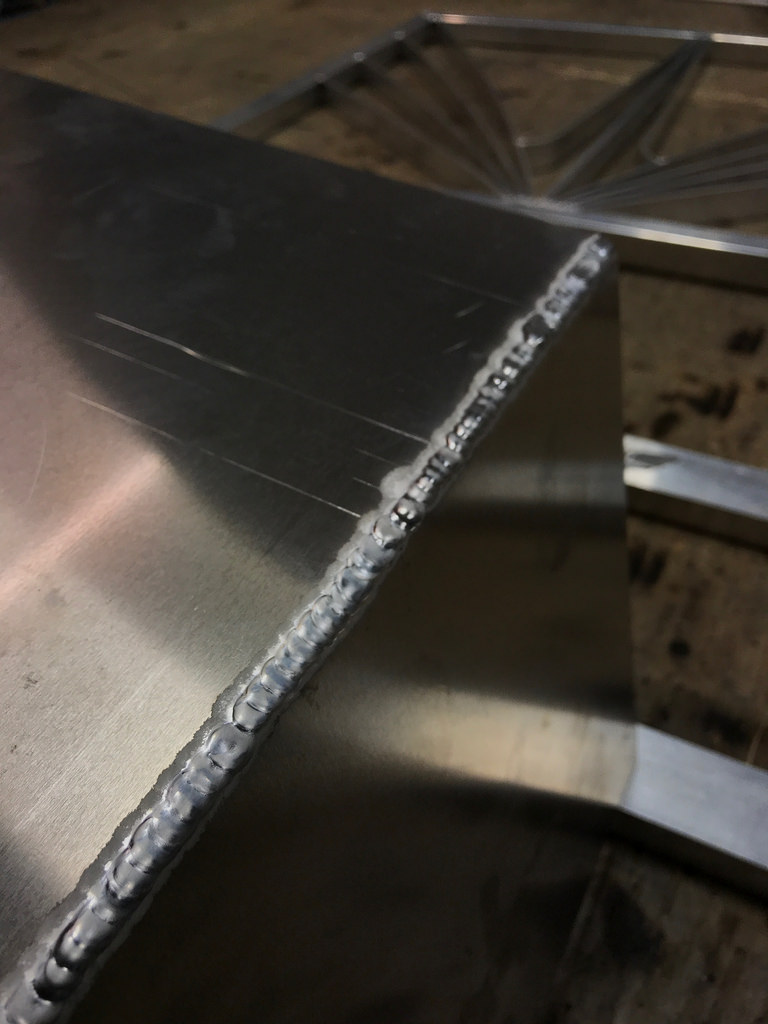

I built a frame for the flatbed consisting of three lateral bars and a few ladder bars to stiffen it all up

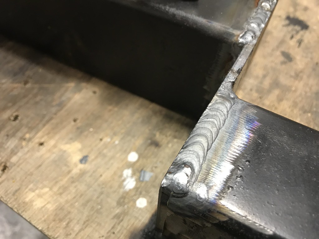

Used 2 x 2 x 1/4" 6061 and 1.5 x 1.5 x 1/4 6061 to build the frame out. appropriate spacers for levelness.

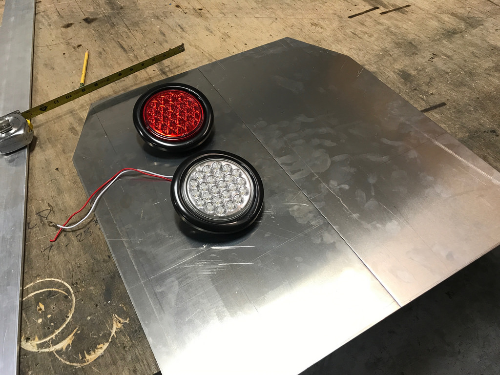

Laying out tailights

bent the panels to make the rear tailight panels as well.

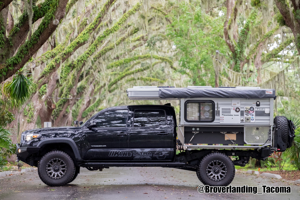

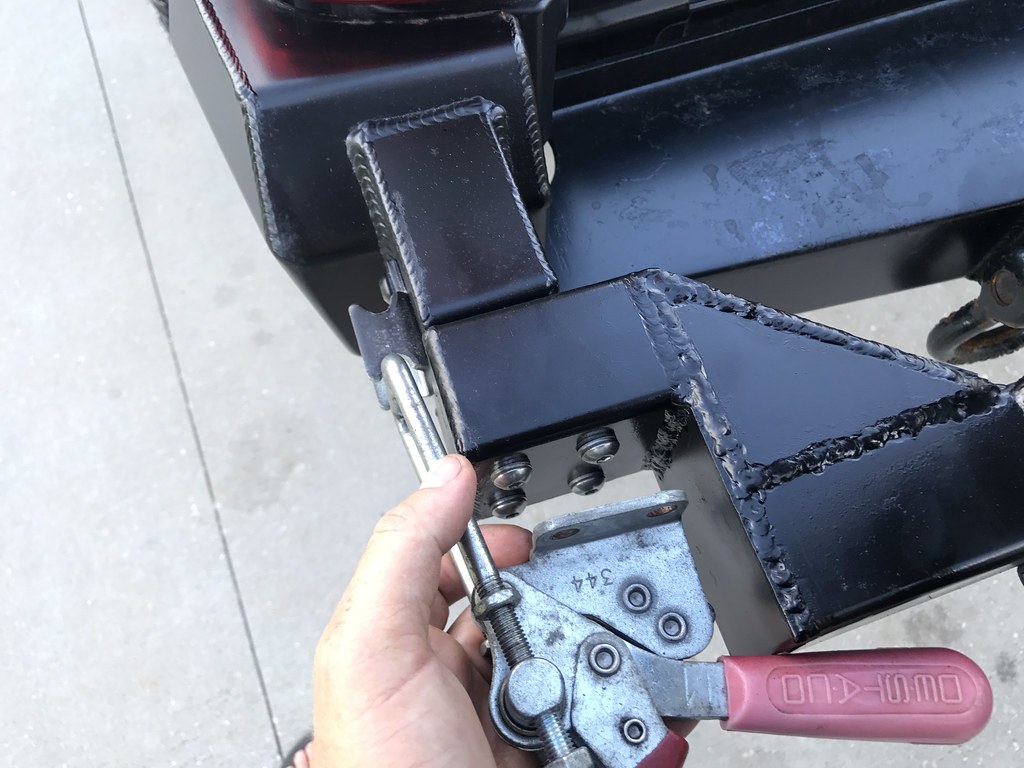

finished up the side doors and latches. 1/8 6061 aluminum with a nice bend in it so i can use the downward shooting lights on the camper. [/COLOR][/FONT]
