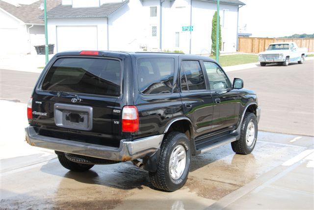

I like the way they look over 4th and 5th gen 4runners. I have been looking for a 4th gen and found this 99 for a decent deal so I bought it.
I sometimes wonder what a 4th gen is going to be like to repair or fix down the road after 100,000 miles. I take my 96 through creeks and down dry rocky creek beds and it just keeps going and it doesn't squeek and rattle. I somehow think a 4th gen would not be so accomodating. Way way more stuff to go wrong I'm thinking.
A 3rd gen 4runner or similar Taco still turns my head where the newer styling just doesn't do it for me. I like round wheel wells and not the crazy big fender flares like what's on my 05 Tundra. The 99 and 00 having the most clearance are great as well. Other vehicles you had to install a lift kit to get the clearance and look that these come with stock.
The other thing locally is that I think a 3rd gen 4Runner is a bargain. Locally there are plenty of clean units with 110,000 miles on them and they are only 2/3rds the price of a Tacoma with say 140,000 miles on them. I have a small utility trailer for anything much that i need a truck for so these 4Runners are just darn handy. We load up gear for 4, throw in a dog and a canoe on top and head off for the weekend. It goes about anywhere I want it to go 12 months a year with reasonable gas mileage and yet still small enough to easily wheel in and around city parking lots etc.
I'd recommend them to anyone. Do your routine service and just add gas and drive.:D
