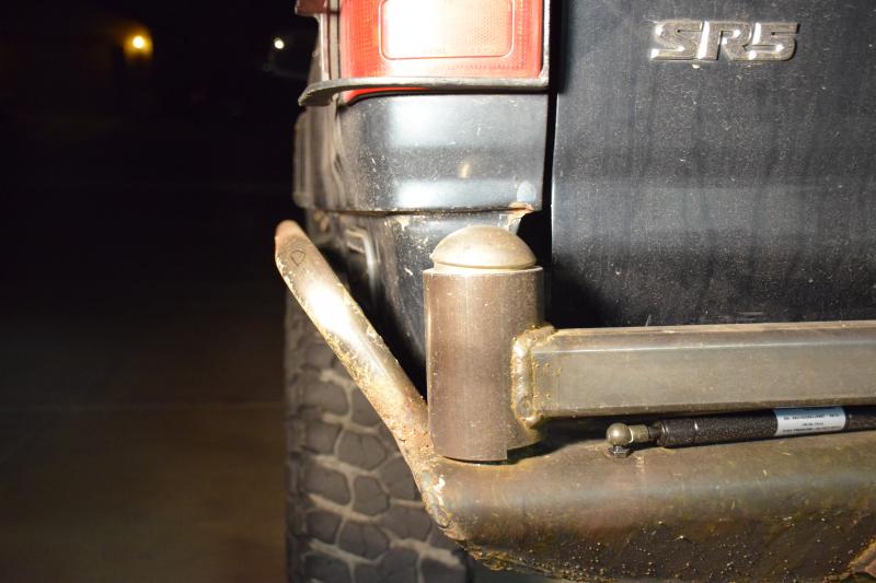

Is there a tube for the wings? The kickout on the top of the wings is interesting and I am curious how that gets finished off.

Yes there is tubing for the top of the wings...more pics to follow!

Here are a few pic of the wings, still haven't welded in the end caps and tubing along the top. I'd think this would look pretty good with the limited flares and probably line up nice. I've got a 1" body lift...

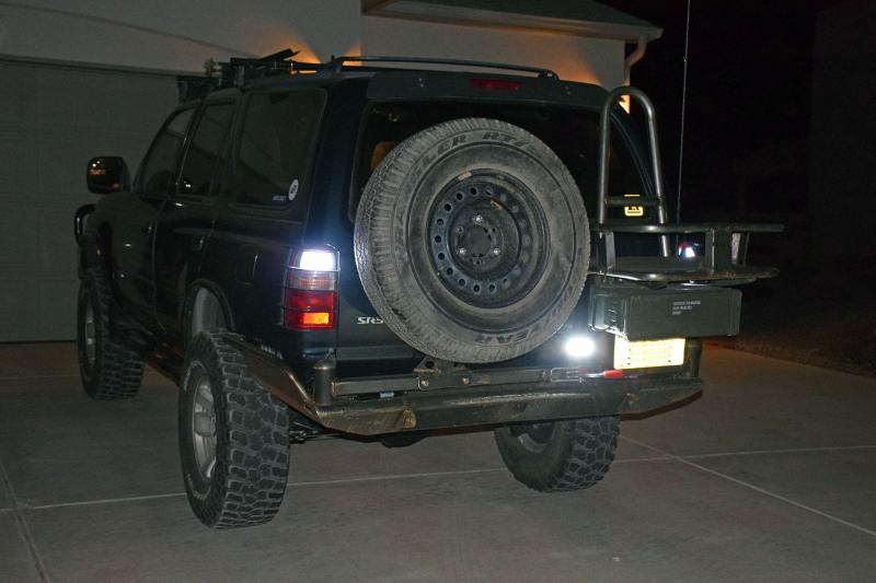

How are you incorporating the military ammo can into the bumper set up? Any close ups of it's use?
It mounts to the horizontal support for the basket with 2 L-brackets. I'm planning on making a plate that goes on the inside of the can to reinforce it.
This was originally Sl33p3's idea and is going to be used to store used PETTs on the trail, nothing like a PETT turning ripe in the trasharoo to stink up a camp site. :flush:
Also installed a 1700 lumen aux backup light from superbrightleds.com. I had 2 50watt aux lights on my old bumper but this one light (2 10watt LEDs) is so much brighter! Planning on combining it with 3way switch for on,off,backup.
