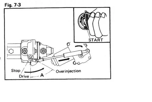

Hi Moterra
This picture may help. It shows the start (overinjection), drive and stop positions:

great pic lost marbles....
I think i have it down to getting the lever, trying the system and oil level switch out...

oh yes i kind of got the positions backward in my other post oops thanks big blue
