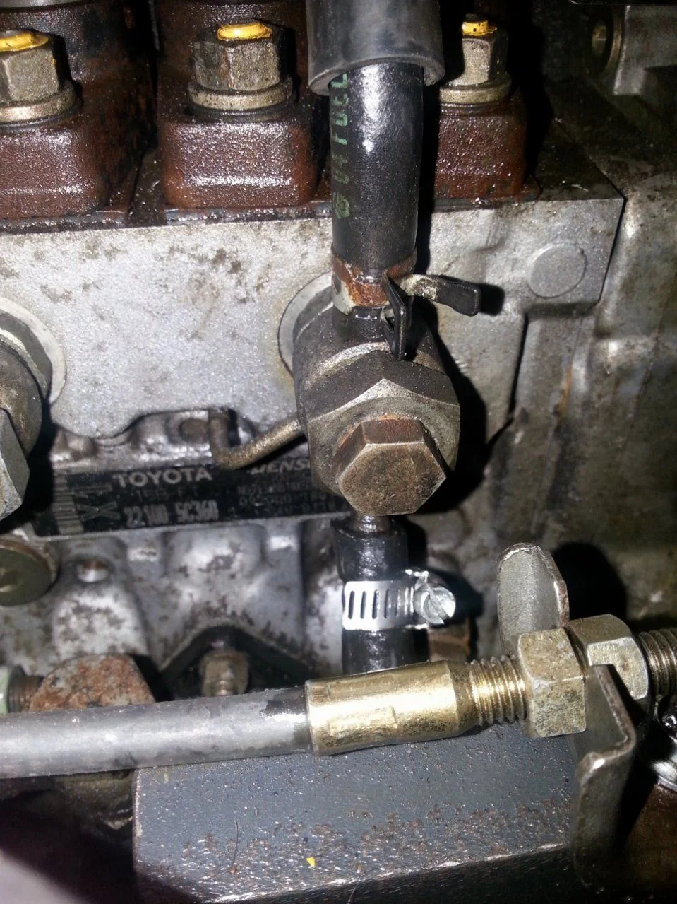

The EPC shows a bleed nipple here on this hollow banjo bolt:
And your photo shows it too:
Have you opened that (while operating your primer) to confirm your IP is full of fuel?
And where does the line heading vertically upwards from this banjo go to?

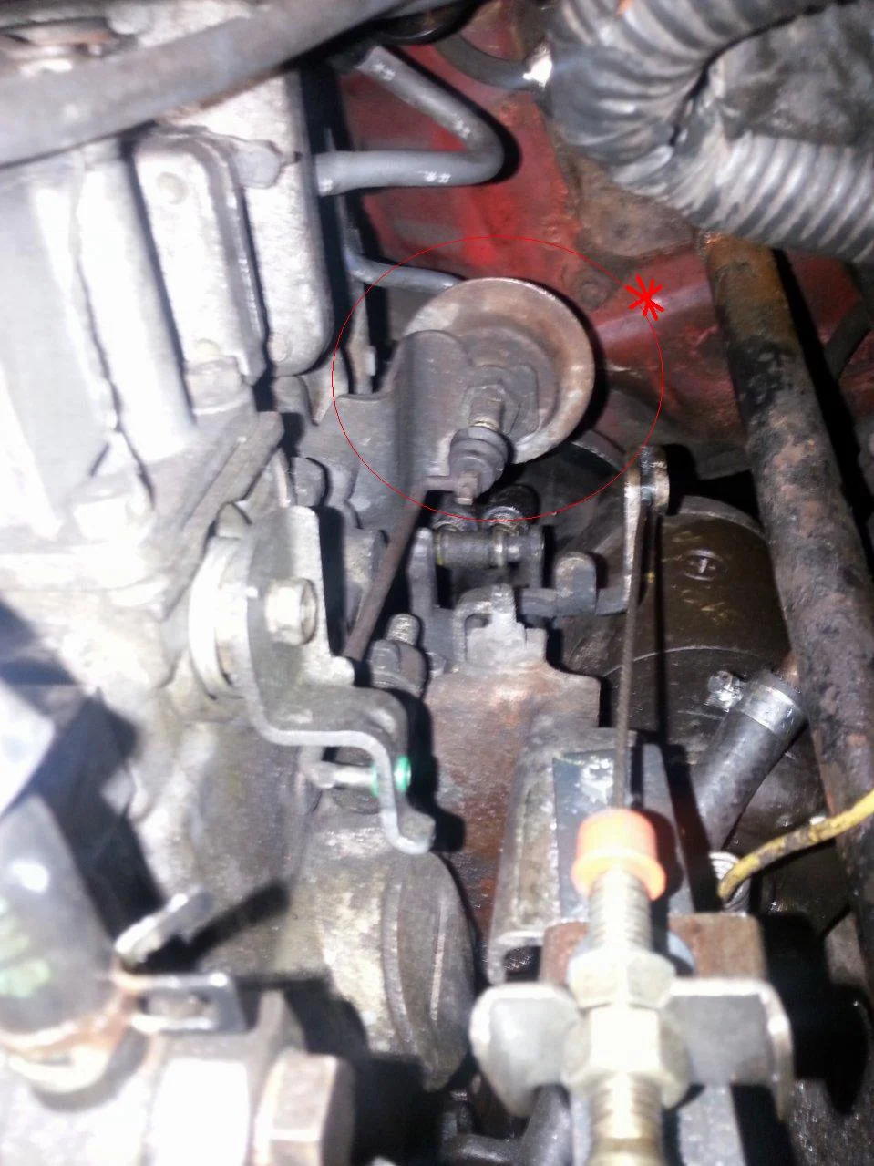

Right now I'm seeing exactly the same pic that I posted in post #9 (so I accidentally got that one right) as applying to your "inline-pump engine"... And once again I see that top-right actuator labelled as "Fuel Cut" (for a 15BFT/BU142).
And here it is in your photo:
I'm wondering if this may somehow have it's linkage sitting in the fuel-cut position (as another possible reason for why your IP doesn't ejaculate fuel when you crank your engine)?

thanks again ... the hose going up is return fuel owerflow from the injection nozzles.... it is returning to the pump and below return to the fuel tank.
the shut off linkage have been tried in any position, thats why the rod from the vaccum disc is not connected.

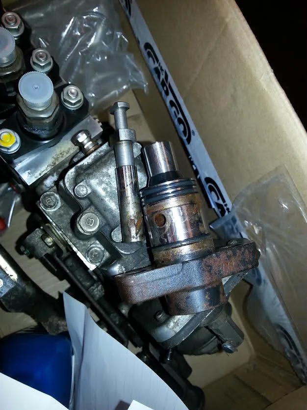

Yesterday I gave up on it and called in an expert from a diesel company in town, he knew this engine type quite well, he looked at it,
.... opened one of the "bloks" in the fuel pump and said, " this pump is dead, you need to renovate it " .... " it is rusted and coroded inside, everything inside it is stuck, either caused by bad fuel from previous car or bad climate in warehouse" ....

Those inline pumps last almost indefinitely when well cared for.
But they are precision machines and I cringe when I see parts of them left open for contaminants to enter ... which unfortunately is common to see when motors have been removed for resale.

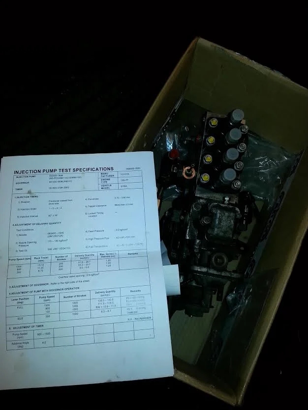

pump is back ...... now I know what to do this weekend. Price : 1534,- euro ....... incl. tax and wat and whatever ...... I´ll keep you guys postet.
Ouch! That's a lot of moolah! But that engine should be worth the extra expense.
I look forward to your next report............:clap:
Wow, for that sort of money you would think they would strip & clean the whole pump so it looks new.
When I had my pump rebuilt for $1500 aus dollars the thing looked new again.

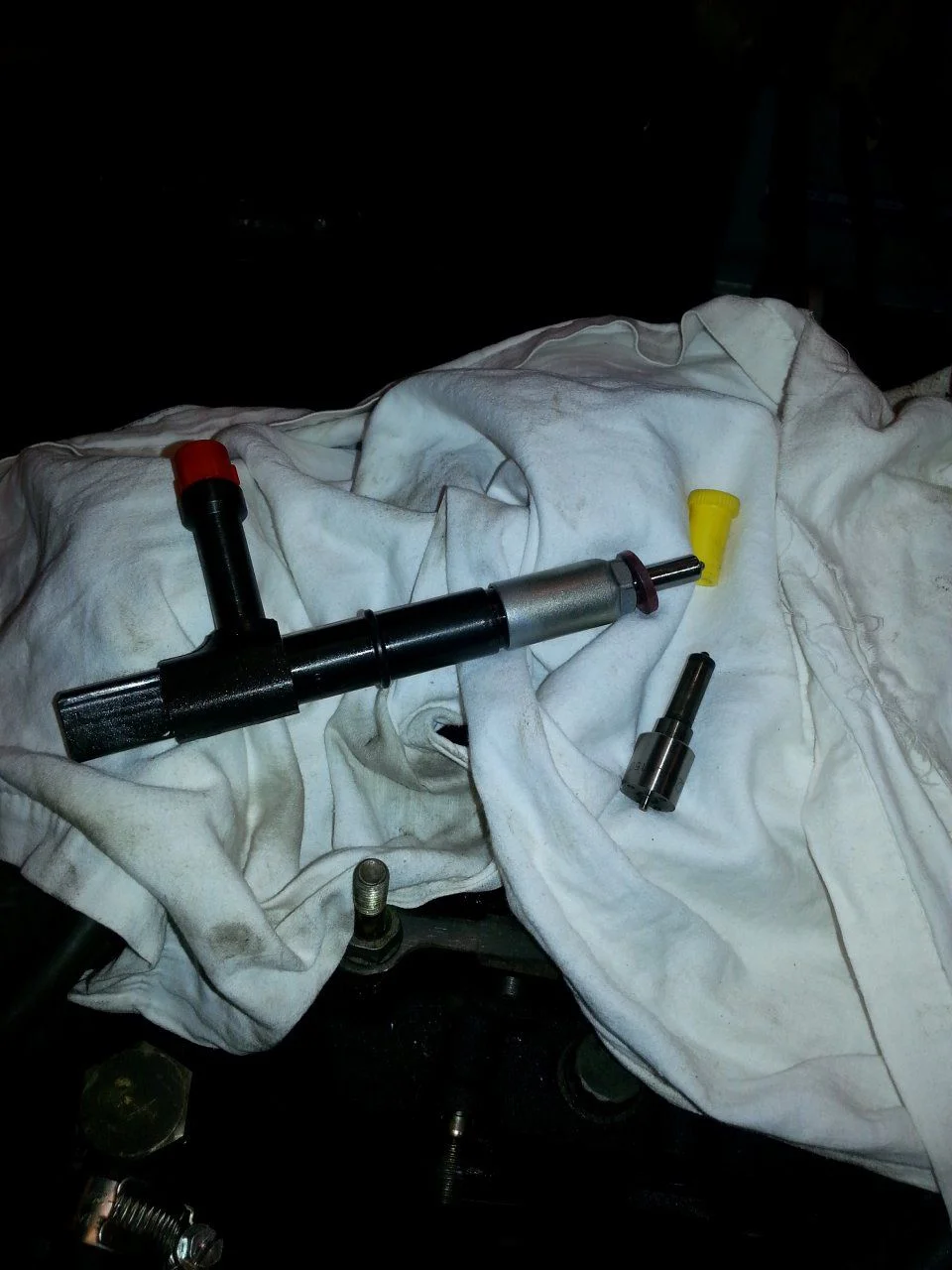

I diced to renew my injectors as well ...... the only right thing to do when i have come this far...... good call..... first nozzle in the test pump got stuck in first test, opened okay with spay of diesel at approx 150-170 bar, but after that it opned right up at 15 bar .... 3 straight line of diesel instead of a spray ........ damn it, ....... well, we got hold of 4 new nozzles ...... now we are moving on ..... you will get a new report when the time comes to start i up......... (fingers crossed )
