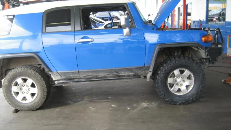

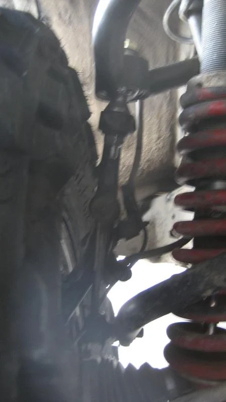

I'm running 35x12.5R17's I'm still in the process of fitting them I'm going to be extending the bump stops by ~1.5". I'm also going to need to adjust my back spacing a little clearances are tight around the upper A arm less then 1/2". Gears are defiantly on the todo list as well.
attachment.php
285x70R17 to 35x12.5R17
attachment.php
upper A arm clearances
attachment.php
attachment.php
