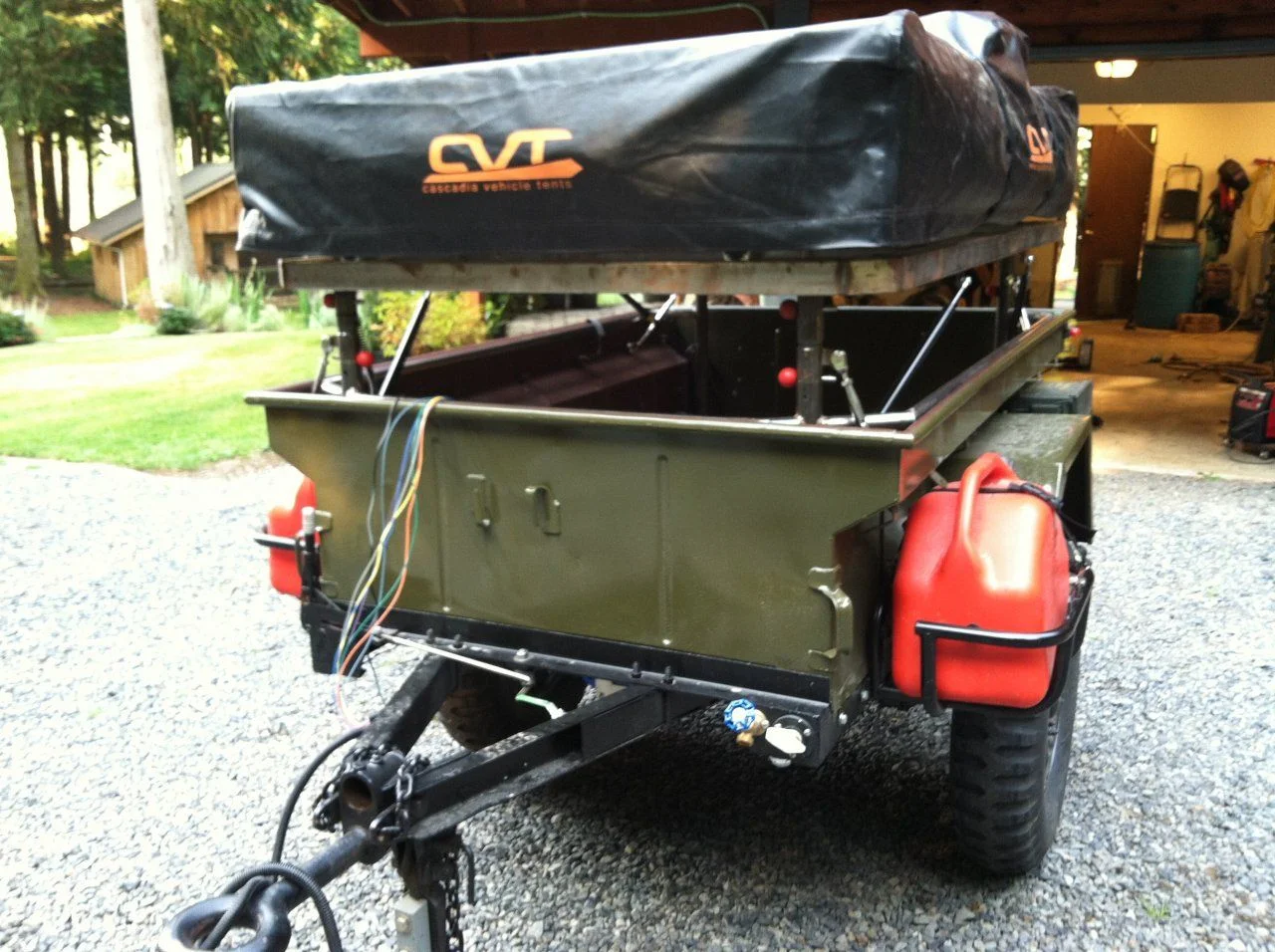

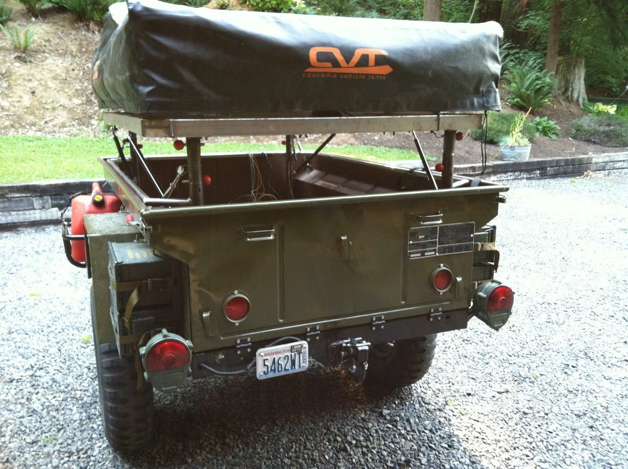

The lifting system works VERY well but it took quite a bit of hit/miss engineering to get it there. The main supports are 3/16 wall DOM tube and they are bored slightly to fit a bushing. I used .120 wall 6061 tubing for the telescopic (sliding) legs and once raised, the rack/legs are secured with quick release pins. It comes up approximately 19" so that the bottom of the RTT sits at exactly 76", that way the annex room works appropriately.
All told, the rack/tent are HEAVY (approx. 210lbs) and the 4 lift struts equal 300lbs of lift. However, you can raise it yourself without even breaking a sweat. All it takes is one small push/lift to get it moving and it goes up on it's own. Lowering it can be done with one person but it's way easier with two. The rack/tent need to be pushed down some to compress the struts but overall it's very easy.
I did however, need to add large turnbuckles to help support the weight of the rack/RTT during transit. I didn't like the thought of things wiggling around and the main support legs are all tied together with 1" tubing.
If you've got any questions about your own rack projects or want some pictures or P/N's just ask :)

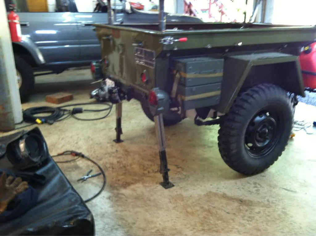

Here's a pic of the rear stab jacks I came up with also, the trailer with the tent raised moved around too much
These jacks can be adjusted up/down 7" and they are secured to the trailer with quick release pins when mounted.
On ebay for about $35 then I modified/extended them.
