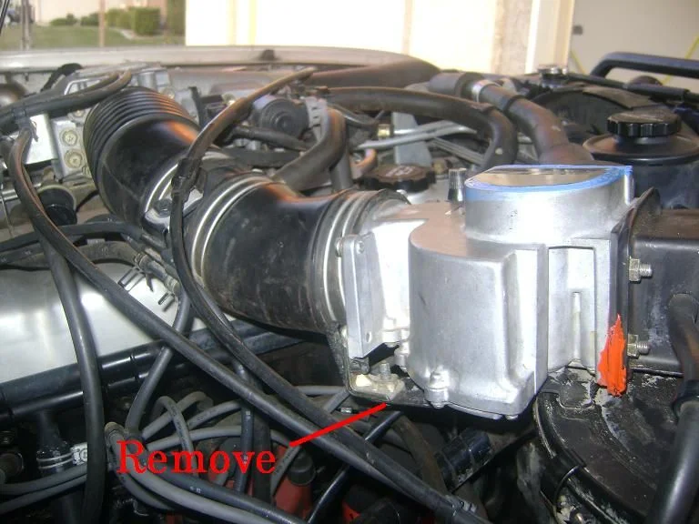

Step 1) Remove VAF/AFM
Picture should say LOSE ... not loose ... my bad

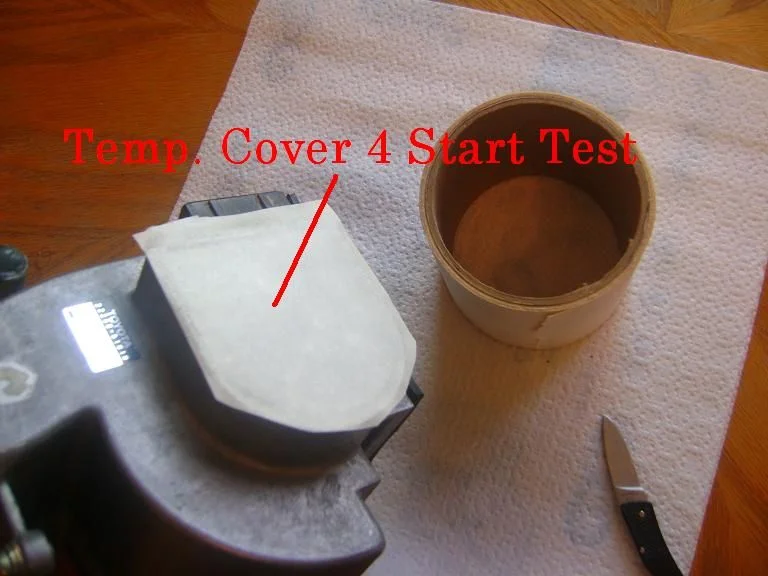

Step 2) Remove black plastic cap. Be careful not to puncture the thin plastic. I used a flathead screwdriver to scrape off silicone then gently pried the black cap off.

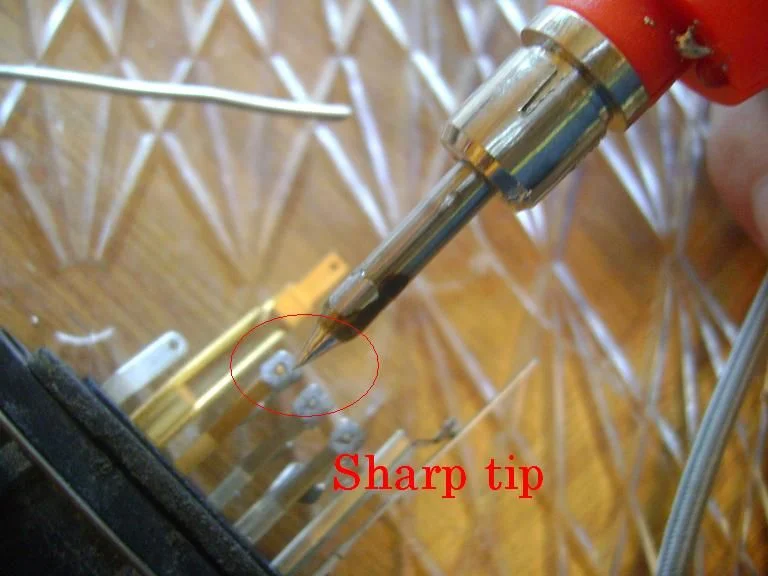

Step 5) Reinsert plug and tighten screws, once in place use solder Iron to melt contacts to circuit board. This is difficult, I was not skilled enough to do this. (if you are better this may be the end for you) If you suck at soldering like me see the next step.

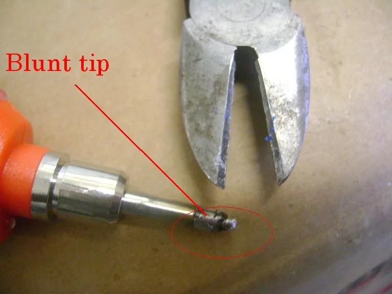

Step 6) Plan B .. Remove contact clips and solder to Circuit board individually. I could not seem to get this to work. I found out later it was due to the fact I was using a fine tip solder iron. Later I fixed the tip by cutting and filing. Had I done this for this step I may have been done at this point. You need to be able to heat the board and solder at the same time for the solder to stick. A fine tip won't cut it for this.
Step 7) Once you get the contacts on the circuit board carefully insert the plug and solder the contacts back to the electrical prongs. Before you silicone the black cap on do a test run to see if you have a good connection. I placed a piece of heavy duty masking tape over the top and put it in the truck.

Step 8) Take a deep breath and try again. I decided to remove the contact clips and really focus on getting the solder to take to the circuit board. This is where I made the solder tip blunt to heat a wider surface. The solder finally began to stick to the board. The prongs on the plug are spring loaded. They make contact by pushing on the board.
I figured if I gooped enough solder on the board they would get a good connection. Not the most beautiful thing to look at, but it seems to have worked. If anyone knows of a good reason why this is a bad idea, please let me know.
