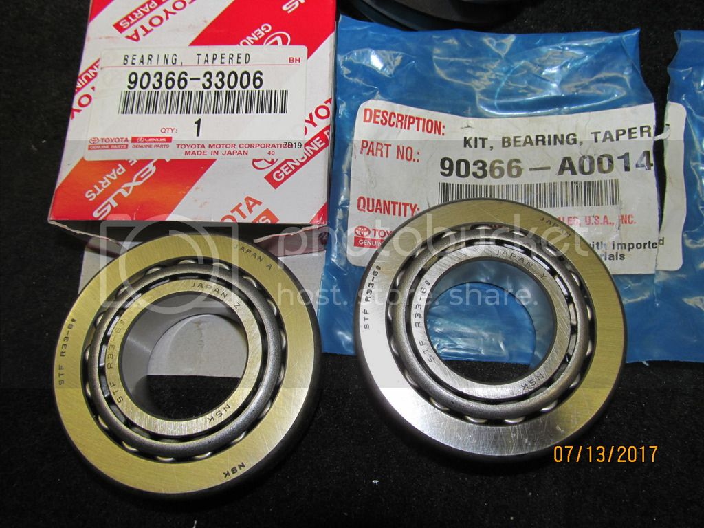

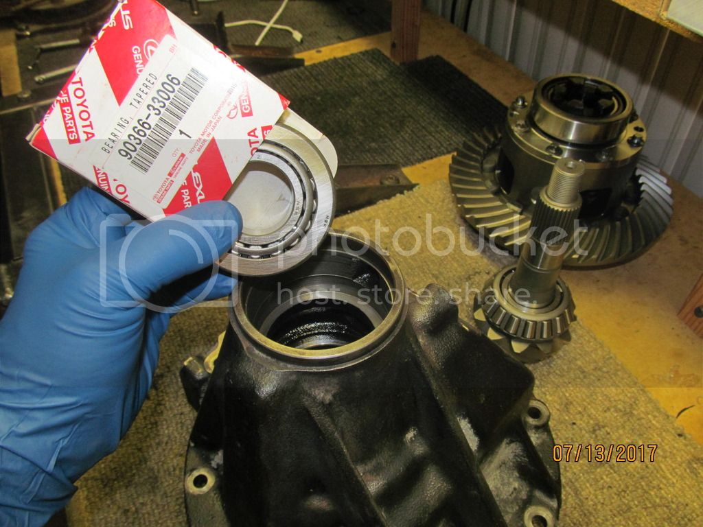

God bless America :).....looks like I have the right outer pinion bearing for the 32 spline pinions. Thanks Locked79 for confirming.

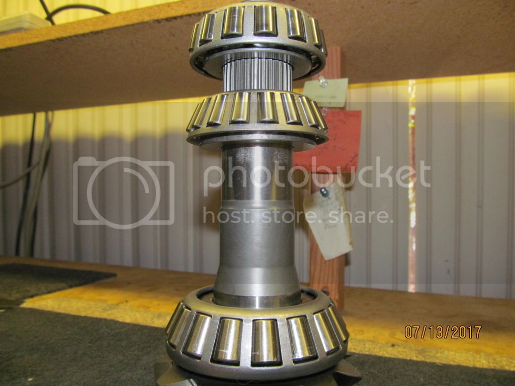

Either one of the bearing part numbers shown in the pic will work. Both have identical part numbers. Shown is the issue that I was having....the usual 30306 pinion bearing designed for 27 or 29 spline pinions stands no chance of slipping over a massive 32 spliner.
I quick check with the dial calipers shows that either part number will fit just fine both inside dia and outside dia. for the 32 spline pinion.
These bearings are used on the newer 9.5" rear diffs I believe(here in the USA).
IMG_0664_zpswh3kehuo.jpg~original

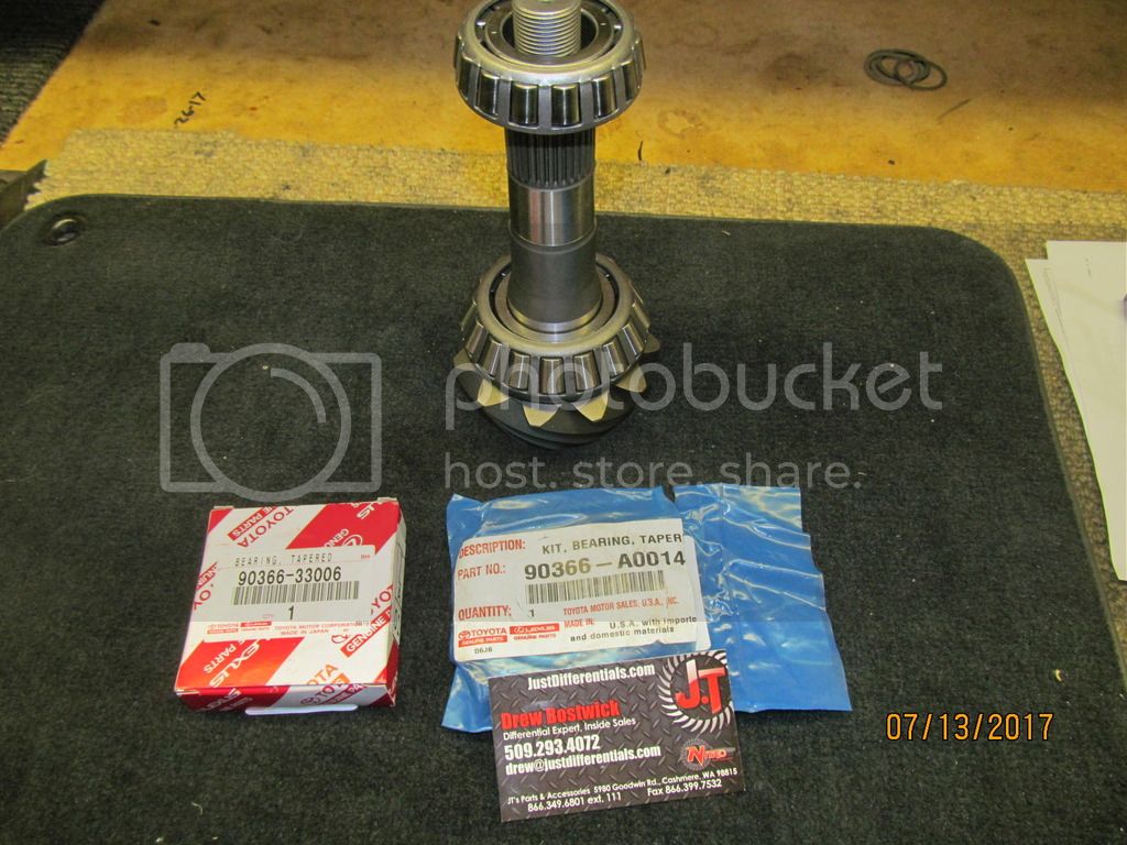

The 90366-33006 is direct from Toyota and it was back ordered and took 1 week to get to me. The one on the right is from JustDifferentials.com and took the usual 4 days to get to me. It's stamped the same exact part number and the sealed wrapper appears to be genuine Toyota.
