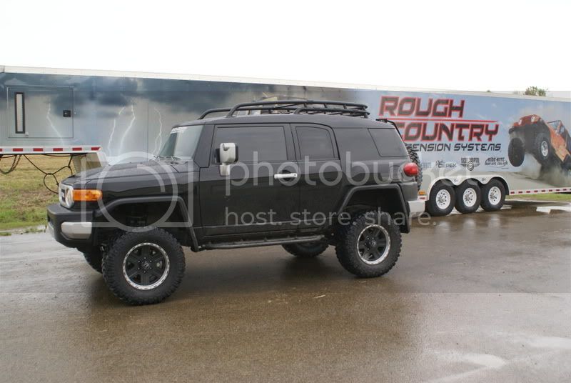

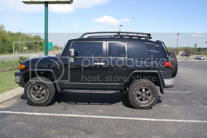

Here is a pic from someone I know who had a Rough Country 3" (first pic) and then went to the 6" (second pic). It was actually the first FJC to get the 6" lift. They go by Tennessee Squire on the FJC forum.

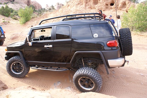

Here is a Moab pic
