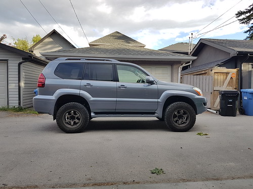

Anyone running these? Not sure on the rate, claim 15% stiffer than stock. Not sure on their specs though, same free height and spring rate listed for both the 3.5" spring and the 2" spring. Don't think that can be right.
Up front i have Icon 2.5s with ~1.5" preload... Rear is Icon 2.0 with AllPro 2" coils and SSO coil conversion. (Adds another 0.75")
