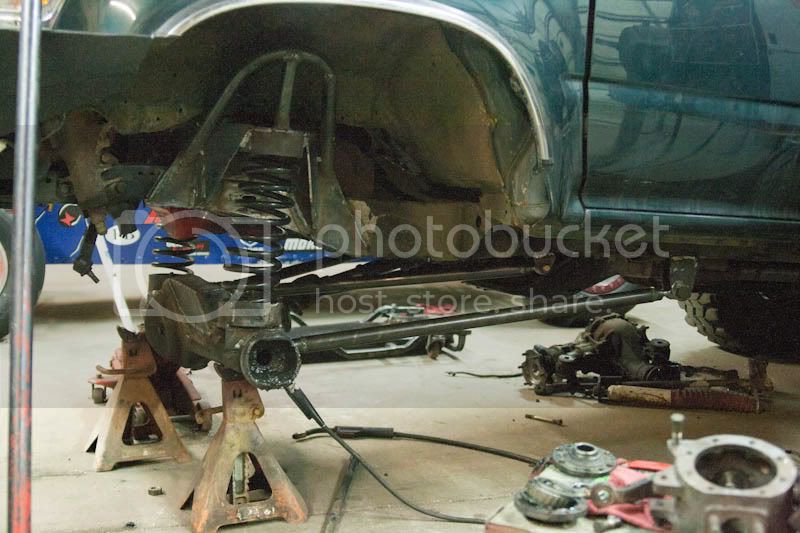

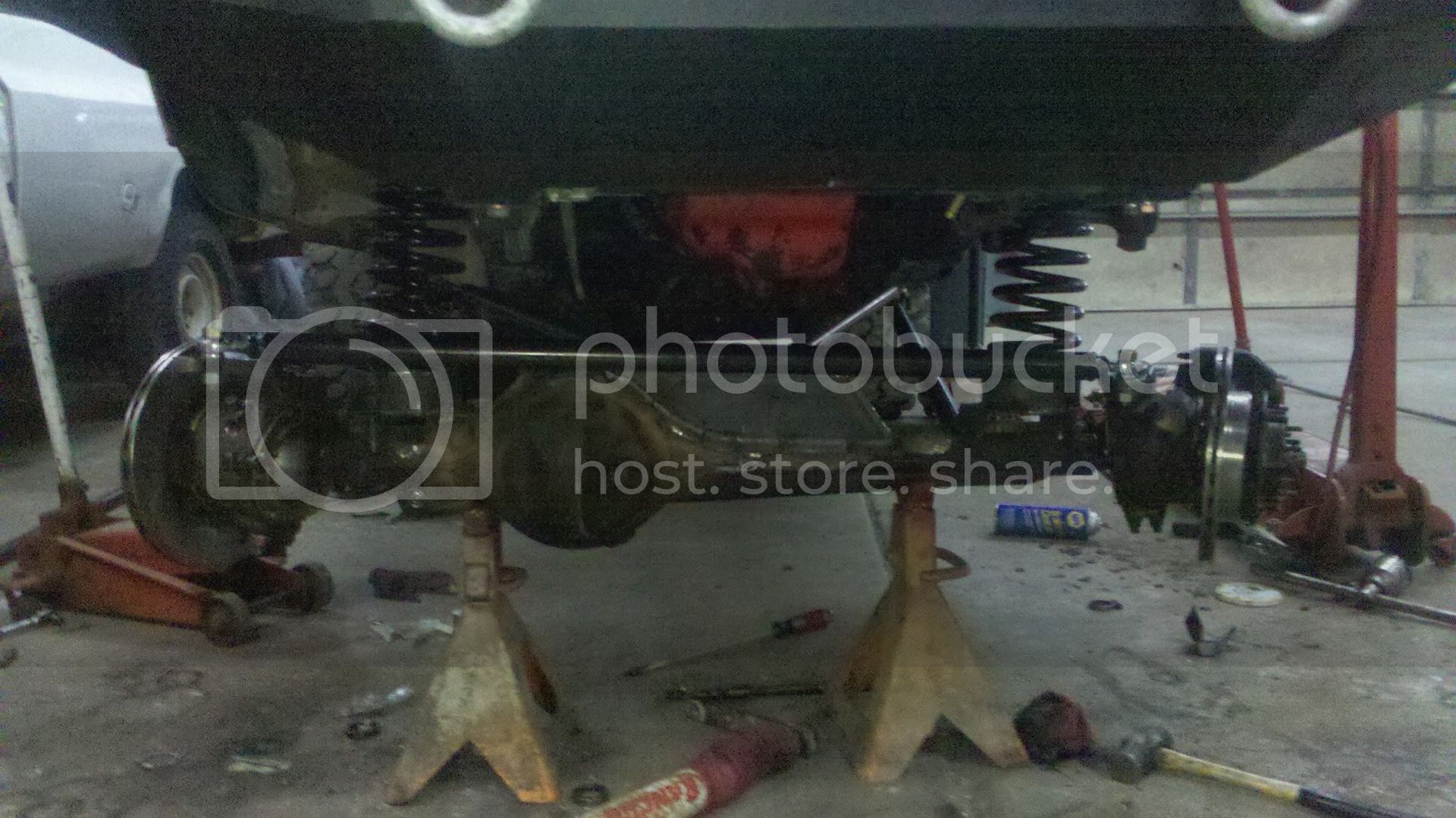

Running a 4 link is a lot of work, especially in the front. Mine is getting close to done, (maybe this weekend if all goes well) I have about $1500 or so into steel and suspension parts. I lost count
this is my first attempt at anything like this, so im probably gonna find out I didnt build some stuff strong enough.
and I think im going to have issues with my upper control arms being to close to my driveshaft with the high pinion diff (should be here wednesday)
