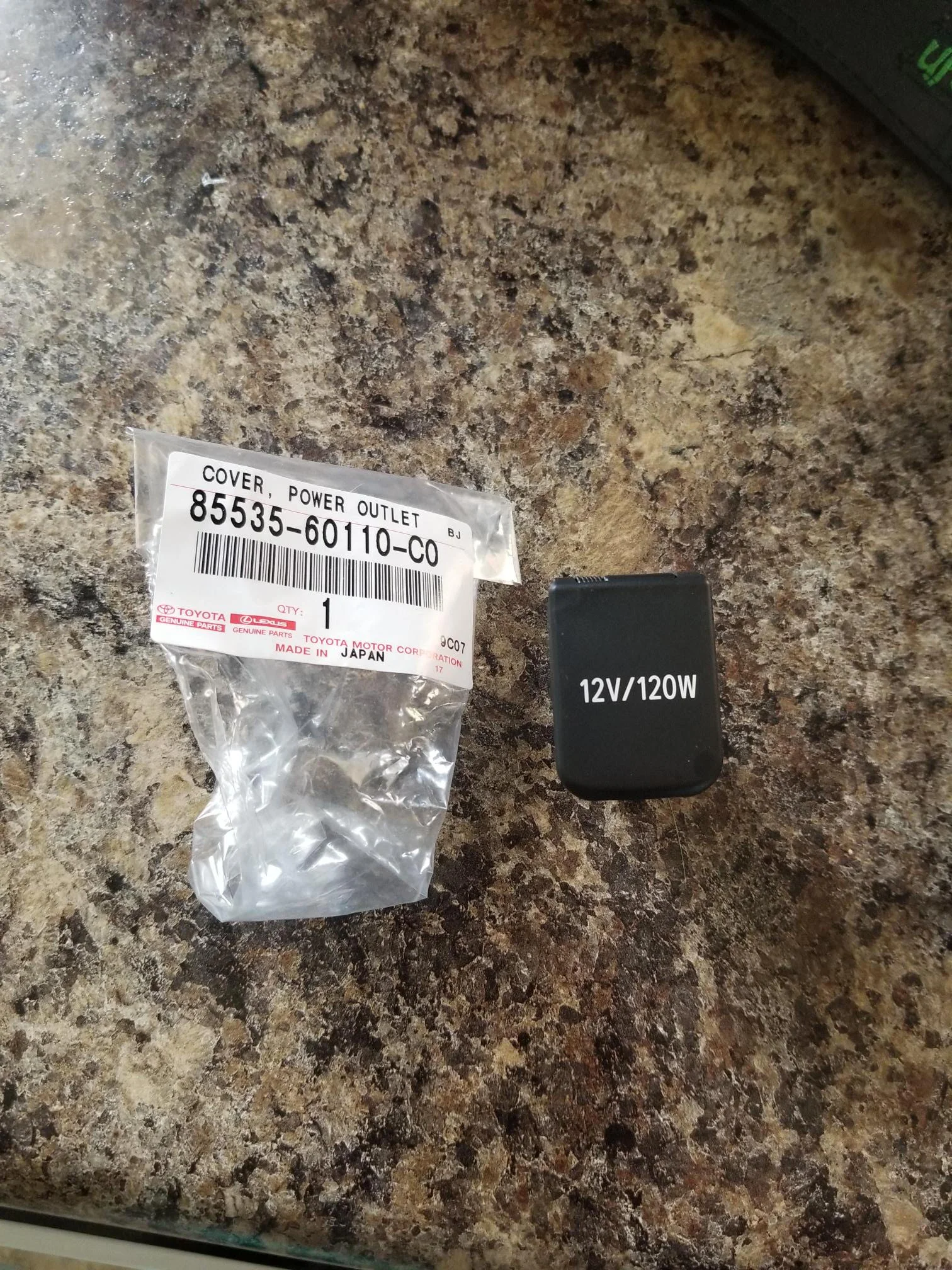

I noticed this morning that my second row power outlet cover is missing.
Can anyone provide me with the part number for this cover, 2015 Land Cruiser with black interior. I looked at all my typical sources and am having a bear of a time finding it in the parts diagrams. I think it is PN 85535-60110-A0 but hoping someone can confirm.
Also can I just pop it out from the front with a trim tool or will I have to pull the whole console apart? Help is appreciated!
Got this sorted so here is a brief writeup.
PN for a 2015 with black interior

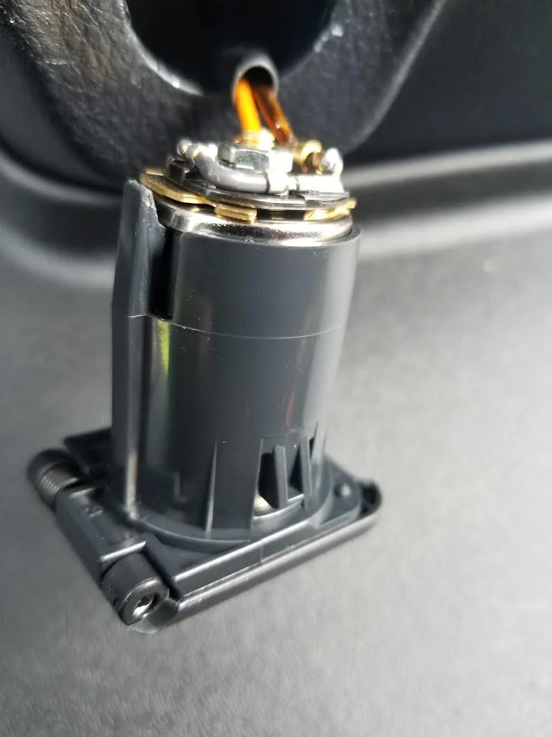

Trick to installing this without disassembling the console is to slide the silver sleeve out of the plastic tube.
Use a small pick to depress the plastic tab shown, and at the same time slide the silver sleeve forward out of the cover assembly.
Once the silver sleeve is slid forward, the cover assy can be pulled out of the console with a trim tool.

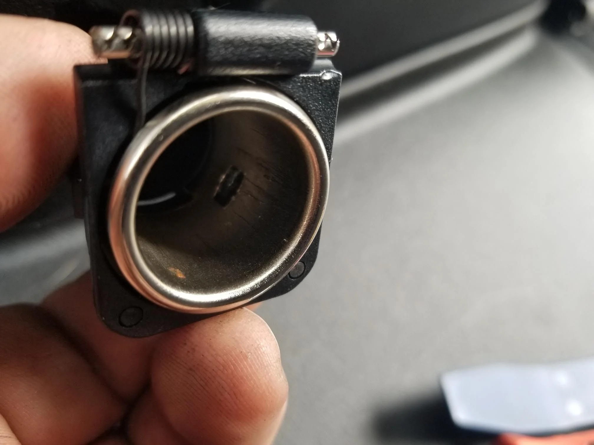

Reassemble the cover assy and remove the hex nut on the back.
Transfer the silver sleeve and all the wiring to the new cover assy.

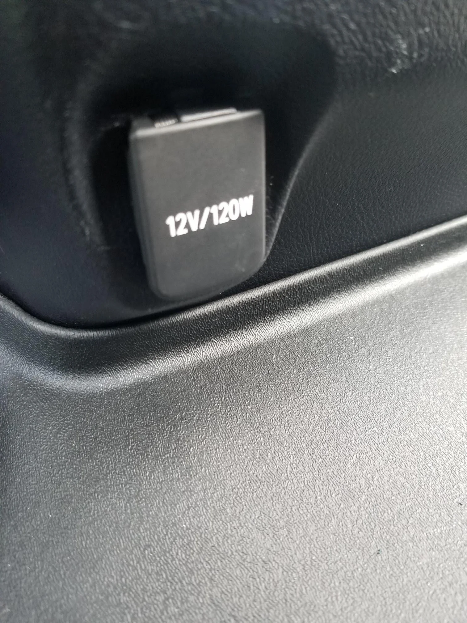

Disassemble the cover assy but leave the wiring hooked up, slide the silver sleeve forward. Press the cover assy into the rear console, then press the silver sleeve into the cover assy until it clicks into place.
Done!
