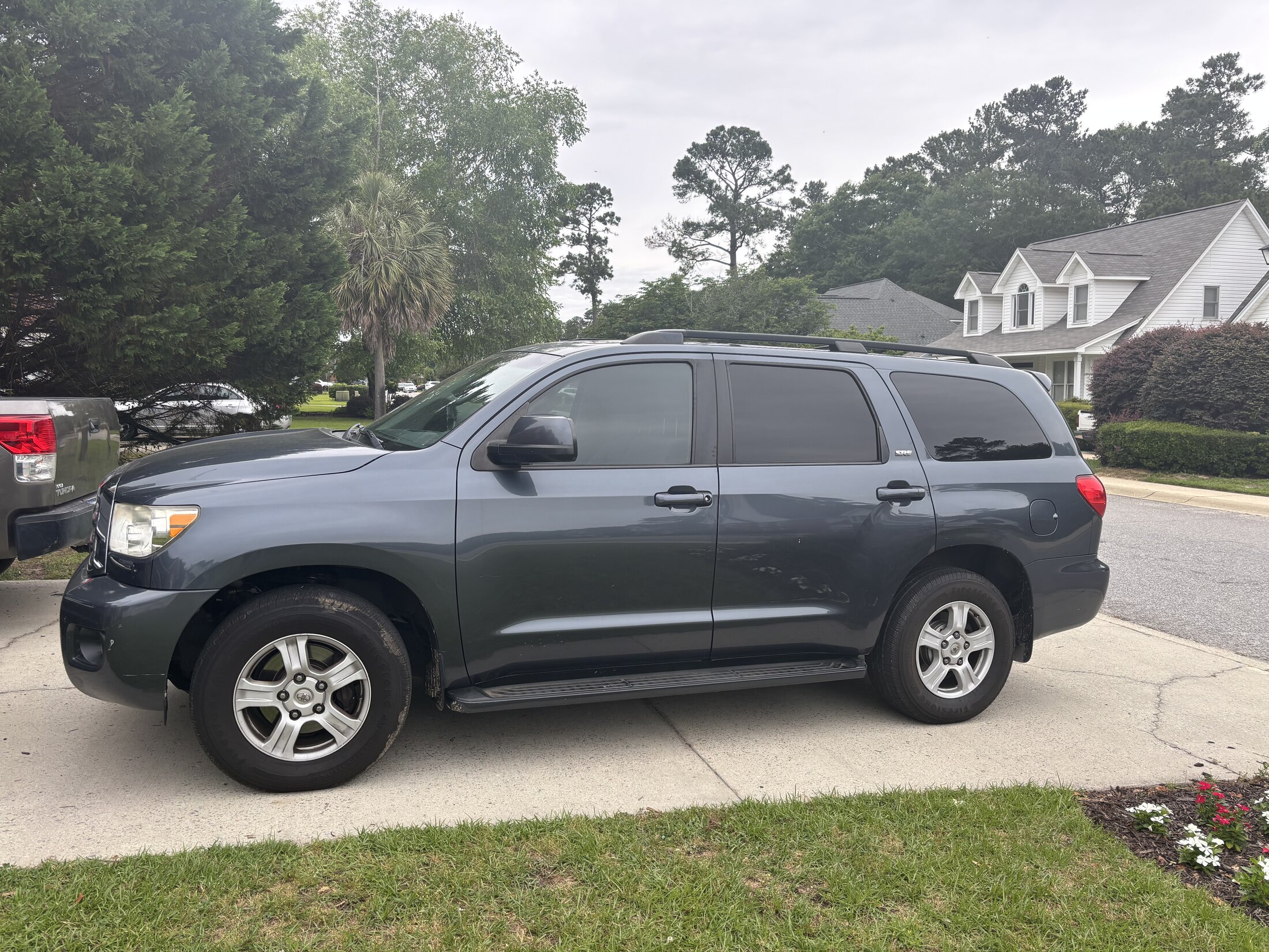

Finally found my Gen 2. I saw a good deal on a 2010 SR5 4x4, cloth interior, 2nd row bench, 217k miles with a decent dent on the liftgate, 1 owner (Tennessee and Arizona),good car fax, and maintenance records from 2016 on at the local Nissan dealership. Less than 500 miles ago they did:
  • All four pads and rotors
  • Alignment
  • All new shocks/struts
  • New upper control arms
  • Spark plugs/ignition coils
  • Battery
They confirmed no rust so I flew out to get it. Got there and, sure enough, the under carriage looked like it was new. I mean the heat shields looked polished and there wasn’t a spec of mud behind any crevice. It hadn’t been washed/detailed at all- it had just never seen salt or off road. It drove extremely tight- noticeably better than my 2011 Tundra I’m pretty proud of. I wrote the dealer a $7500 check and drove it 8 hours home. I had to fiddle with the 4wd hi/lo actuators - they were in perfect shape but just hadn’t been used enough. now that I did that, they respond predictably. I’m still going to do TC case fluid, diffs, and ATF last done in 2018.
I’ve been driving it every day and it’s been great. Really exceeded my already high expectations of Toyota. It just feels good having something that didn’t cost much and will last me a long, long time. Now to find a Slate Metallic liftgate!

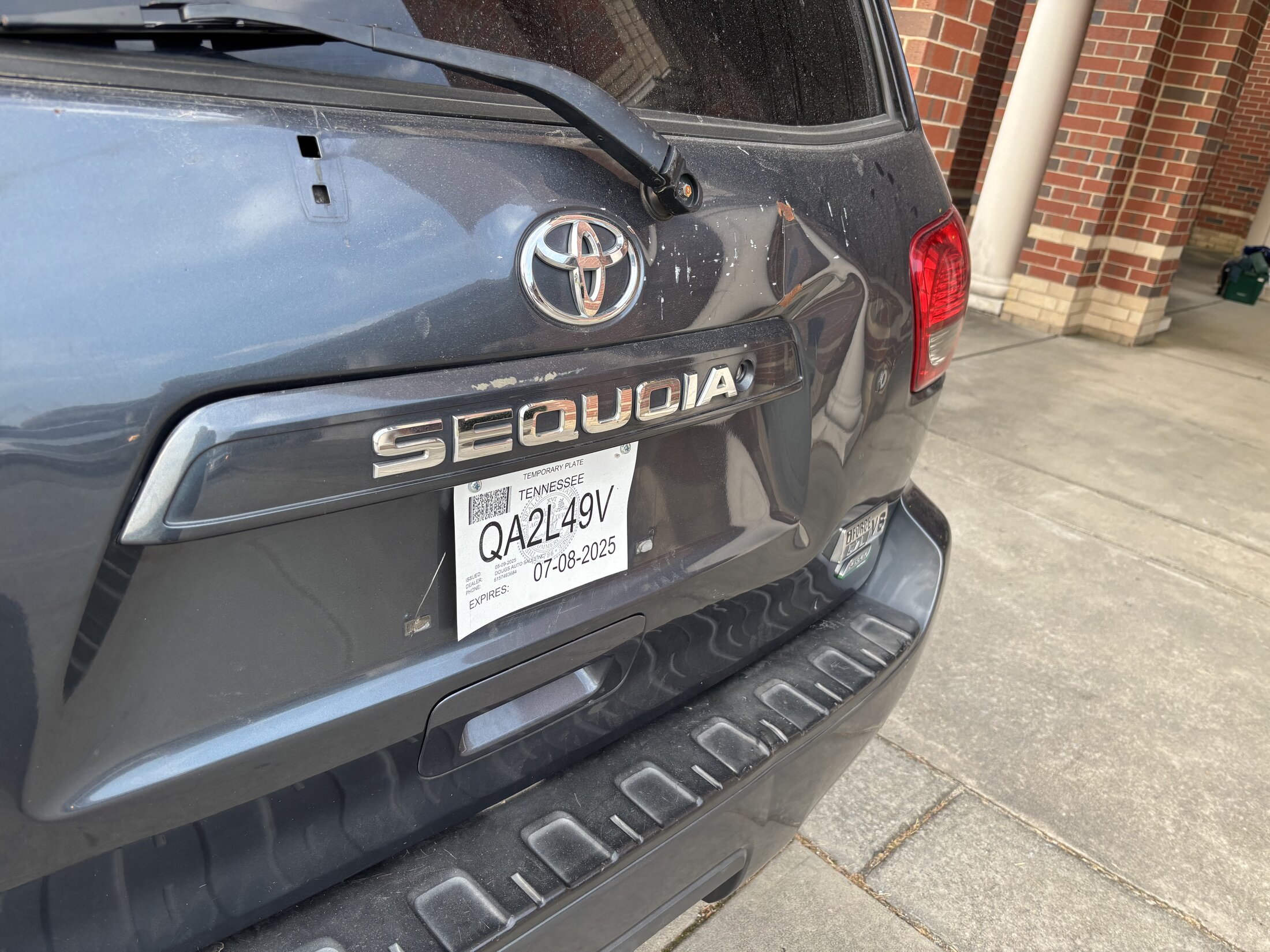

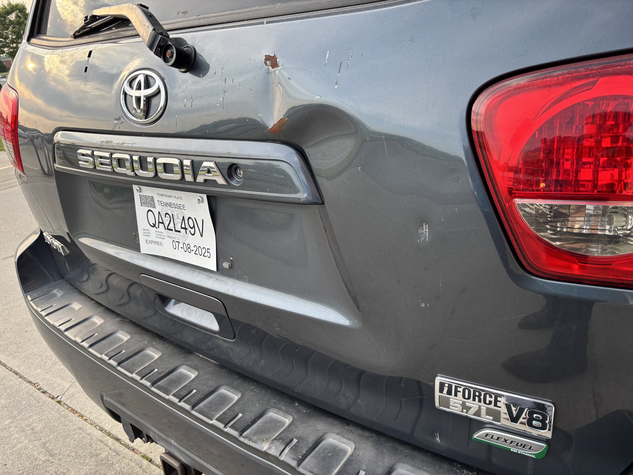

It’s caved pretty good, involving the structural pillars of the liftgate. I’ve taken it to a few small shops so far to get some quotes. Most suggest finding a used tailgate but it’s all around that $1k range so far. Let me know what you think.

Doesn't look to bad to me. I've fixed worse dents on a car with like 3 times sheet metal rigidity than Toyota does. Finger does not flex it no matter how hard you try, and the dent is pretty hard to work with. Contrary, fixing basketball dents on the roof of my Tundra is nearly zero effort. It just pulls right back with no visible indication of the past damage.
However. I see the wiper rest is missing. This means a lot of water intrusion into the tailgate. It likely has a lot of rust already developed inside. So I would direct that $1k towards a good used tailgate in this case specifically. In case you decide to work with your dented tailgate anyways, have it inspected inside for rust. It would be pity to bust time and money, only to find a through hole a couple years down the road.

Great point on the water intrusion- I hadn’t considered that. It makes me want to investigate. That’s a common missing part in even the used gates I’m seeing…

Yeah, inspect yours. If the corrosion looks minimal then just spray it with Noxudol 700, it will stop it once and forever. And patch those holes over. With the tailgate pulled apart you may assess the damage done to structural elements. I think your body shops stay away from fixing body elements with structural damage, because this may be against the law, even if the damage is nominal.
