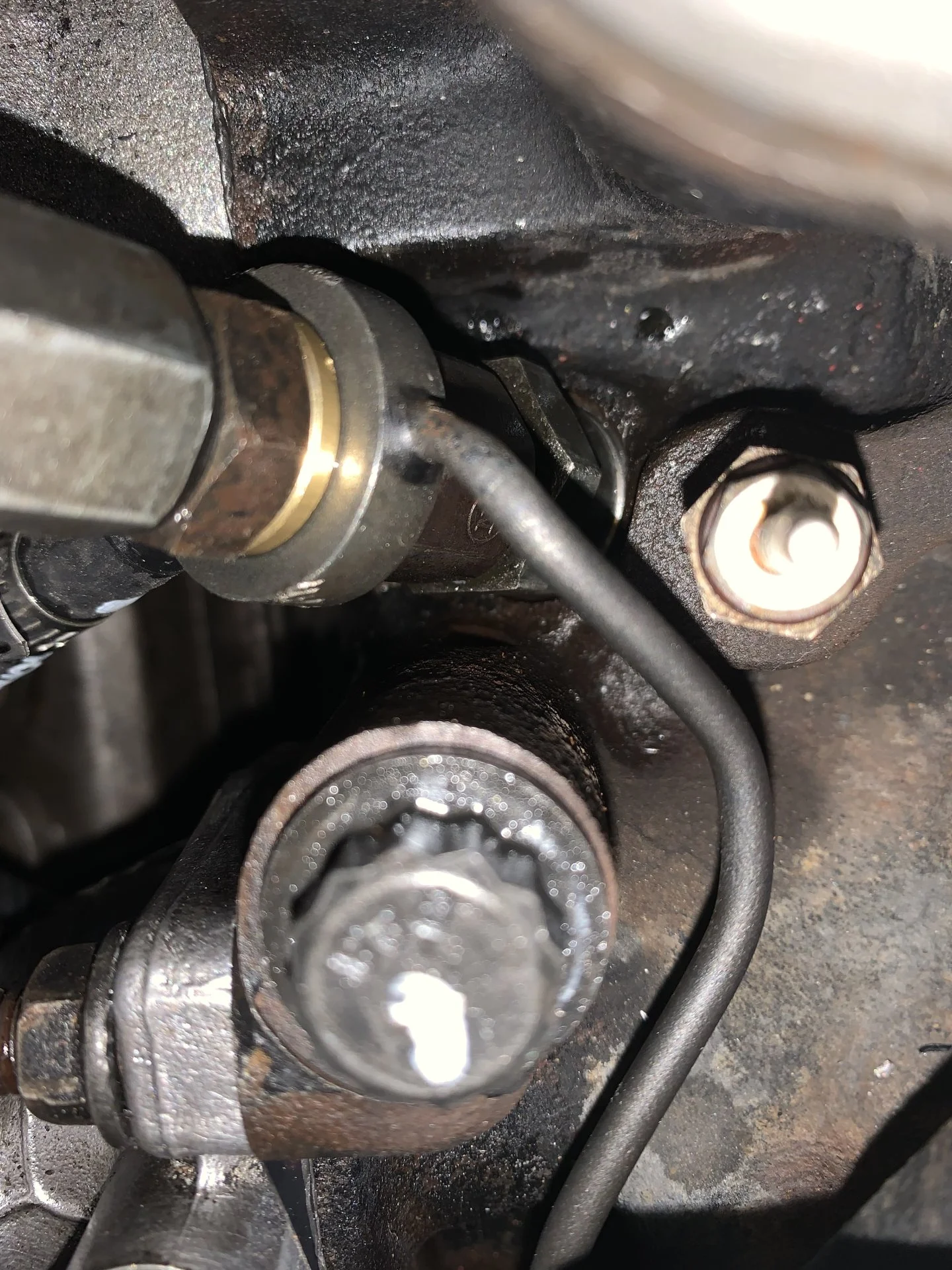

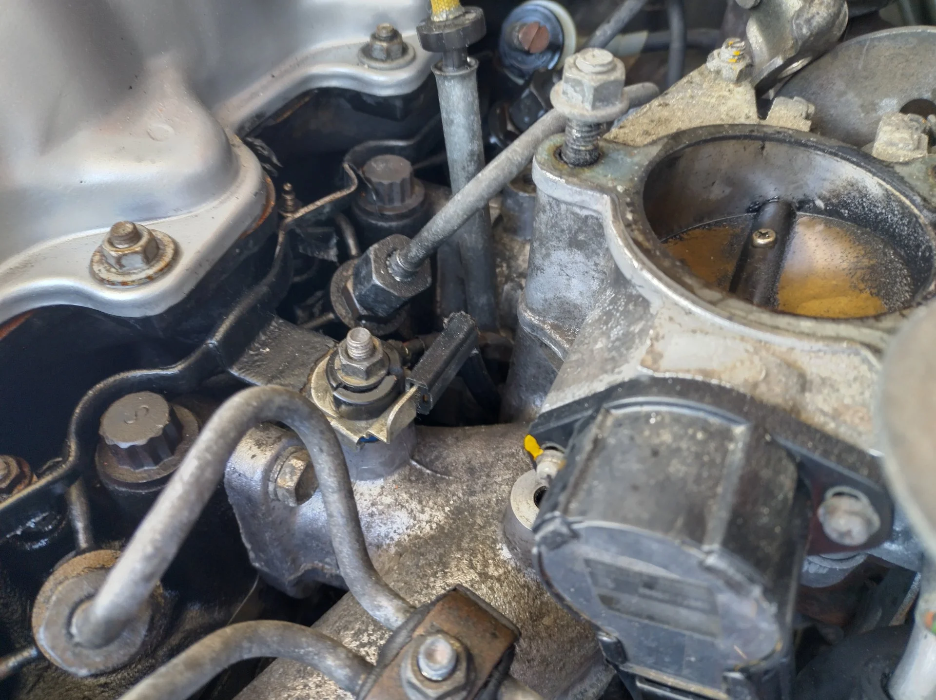

I’m new and I have a 91 LJ78 RHD 2LTE Auto imported from Dubai. I’m having a question about the fuel rail configuration. When I tighten the compression nut of the fuel line to the injectors the nut bottoms out on the return rail nut and the line doesn’t tighten on the injector.

Yeah so I got all that but my problem is my compression nut for the line bottoms out on the nut and doesn’t seat on the injectors. My washers are all new but I’m missing something the washers are too thick or the nut is too tall but they’re all original parts.
@MojoMuffy The washer at the fuel return rail is not supposed to be there. That washer is supposed to go down inside the injector hole. There are only supposed to be little copper/aluminum washers up by the fuel rail. There could be more bad stuff going on then that. Someone has done some poor work there. I recommend buying all new washers for all injectors and re-doing everything yourself. Use megazip to find the part numbers, order the parts from partsouq. Generally if you had the right washers, they can all be reused except the smallest one that seals the injector nozzle to the cylinder head/ upper precombustion chamber. If that washer is not replaced everytime injetors removed, then they will get fouled with combustion carbon and not work right.
