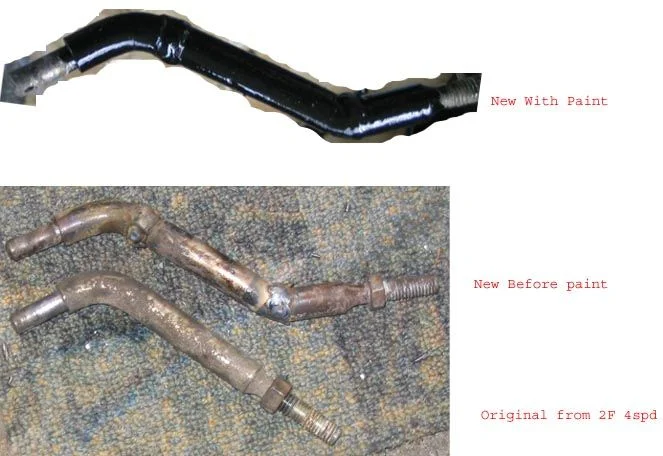

1)I got a direct shift type front "half" off an fj60 (?) from James at cruiserparts.net
Make sure it has the 38mm idler shaft. There was a bolt hole on the mechanical
front half that had to I had to fill-in and remember to put in that plastic oiler for the 5th ear, too. The shift linkage required modification. I used my 4 speed's linkage combined with that on the H55. I'll try to post some pictures...HTH
