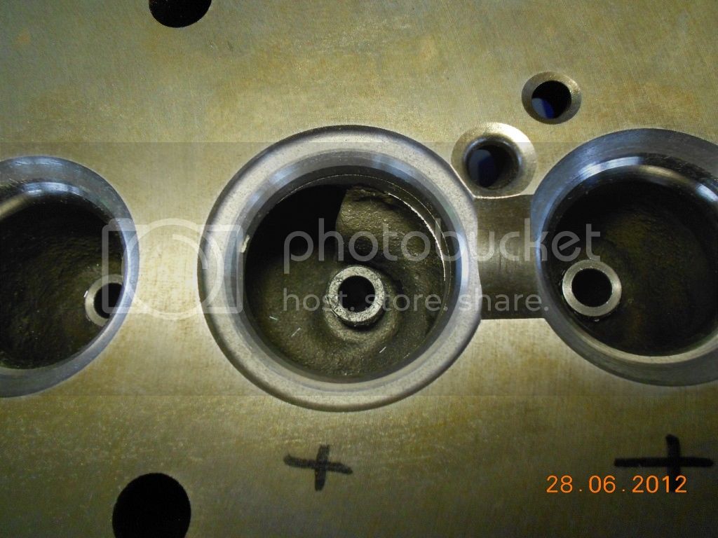

Putting a swirl gadget before a throttle plate and hoping to get in cylinder swirl is way past a stretch. Now designing a swirl mod in the intake runner just before the intake valve will influence in cylinder swirl.... Which is what they did on the hd and Hz heads. Tons of other engines run the same head design in one form or another. They are however, customized to each engine and are not a one size fits all deal. In cylinder swirl is a a super difficult thing to model and you can over do it and actually induce too much spin and chuck the fuel droplets out against the cylinder walls. It is not a simple subect and would involve a lot of trial and error, a dyno, lots of sensors and lots of spare time.
g
Hey Greg, do you by any chance have a picture of the swirl Toyota put into the 1HZ or 1HD heads? Reason I ask, is I just installed a second generation updated OEM 2TLE head (11101-54121 93+) onto my engine (thought the original was cracked, but turned out to be a small head gasket leak). One of the differences in the second gen head (vs. 1st gen) is a strange spiral cut just above the intake valve seat. I just assumed it was messy machining, but now that you mention the above, I'm wondering if it has something to do with this swirl thing. Incidentally I'm getting 1l/100km better economy so far...not sure if it's related. I wish now I'd taken a picture of the swirl cut. The old head has nothing like it.
EDIT: Nevermind, I found a picture of a 1HZ intake port and the swirl design is very obvious. Totally different than what I was looking at. It is a very obvious casting spiral in the 1HZ.
