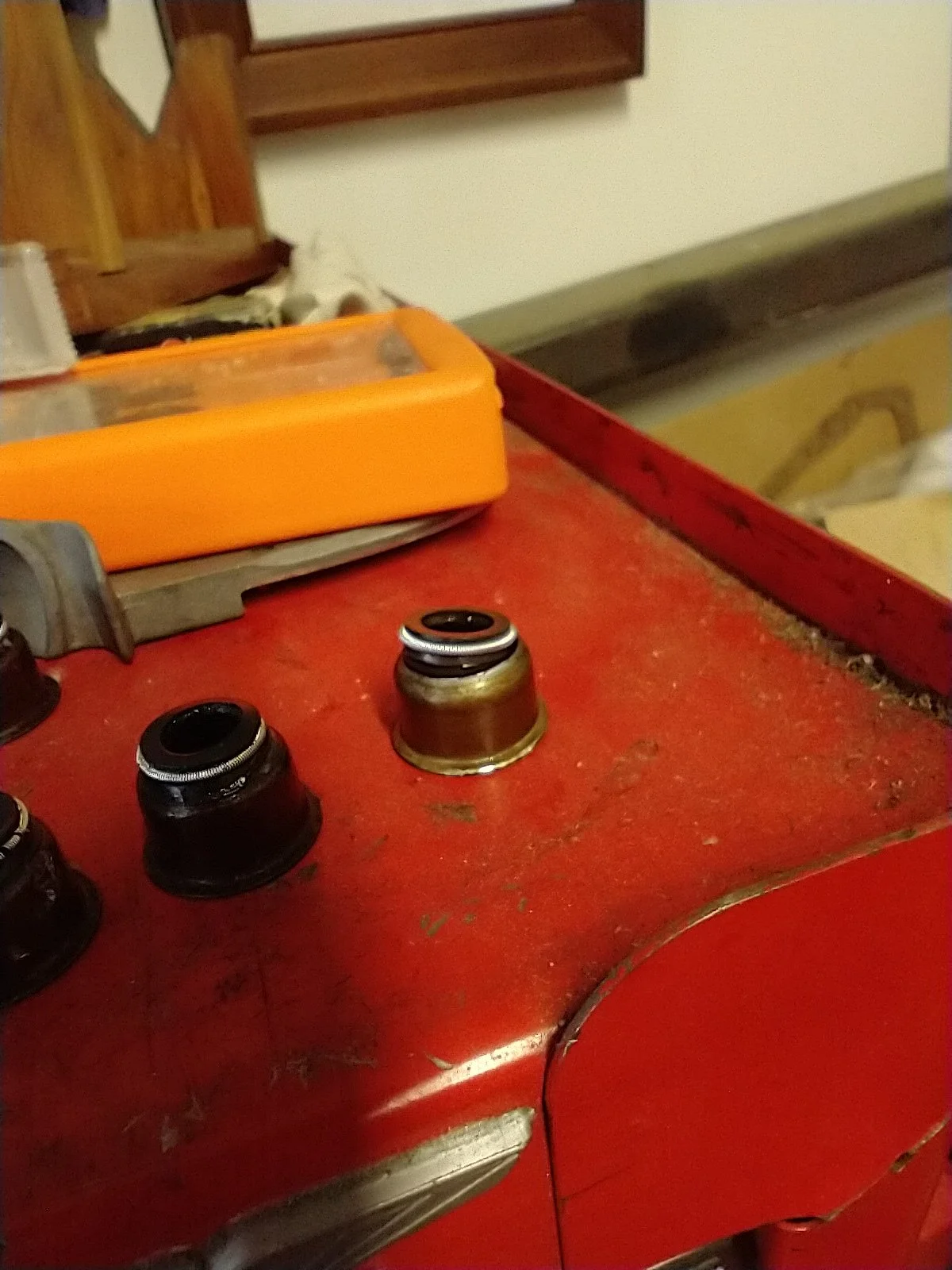

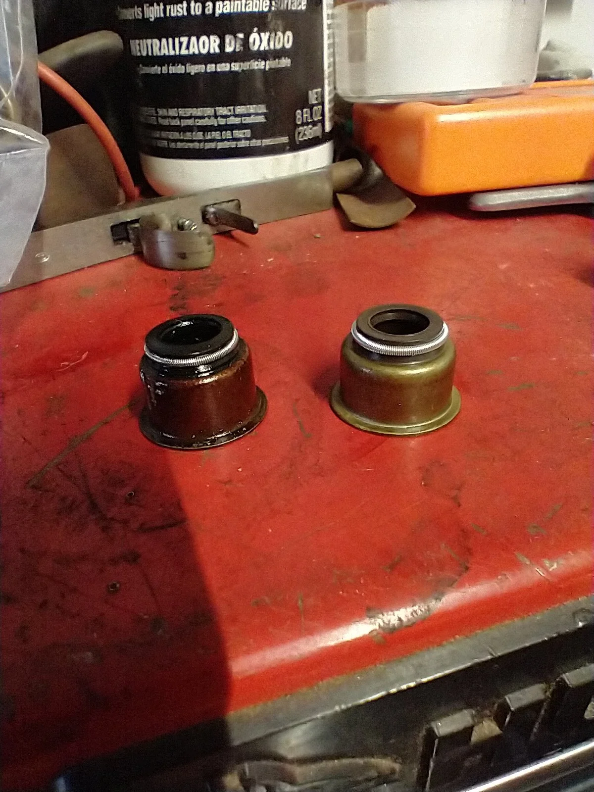

Just looking at the OEM removed on the left, the Mahle looks like the same thing.
I know the pic ain't great, but the rubber on the OEM valve seal is much wider than the Mahle aftermarket
Note the separation.
I used standard fluoroelastomer (Viton) valve stem seals on the last three 2F head jobs and have not noticed any problems with them. They look just like the two pictured above. There is no reason for the rubber part to separate from the metal housing unless you are installing them "dry" on the valve stem, which is not recommended. I agree that the ones that seem to have more "body" to the rubber would probably be better. If someone has a part number for that style, and it is "Viton", please post the part #.

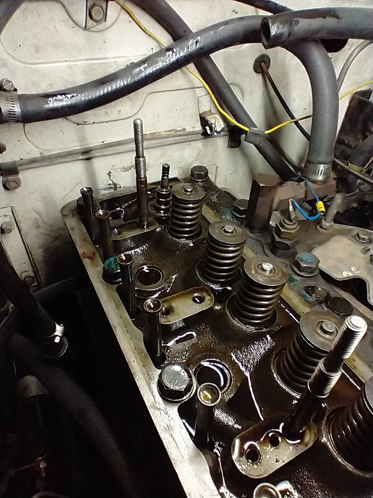

Now if there were an "easy button" for getting the second valve keeper on....

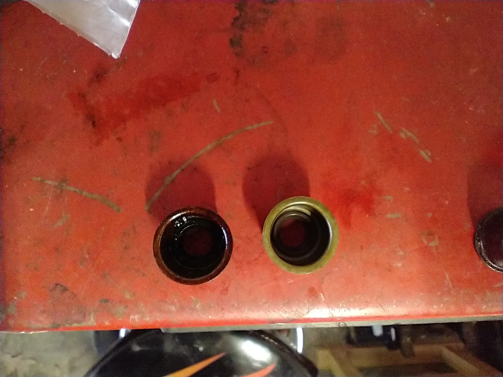

Well, got the stem seals from McGeorge Toyota today, and installed them. Went on super easy and without issue.
In addition to the Toyota OEM seals having thicker rubber, the metal part has better hardness. When you drive them home, they don't distort like the Mahle do

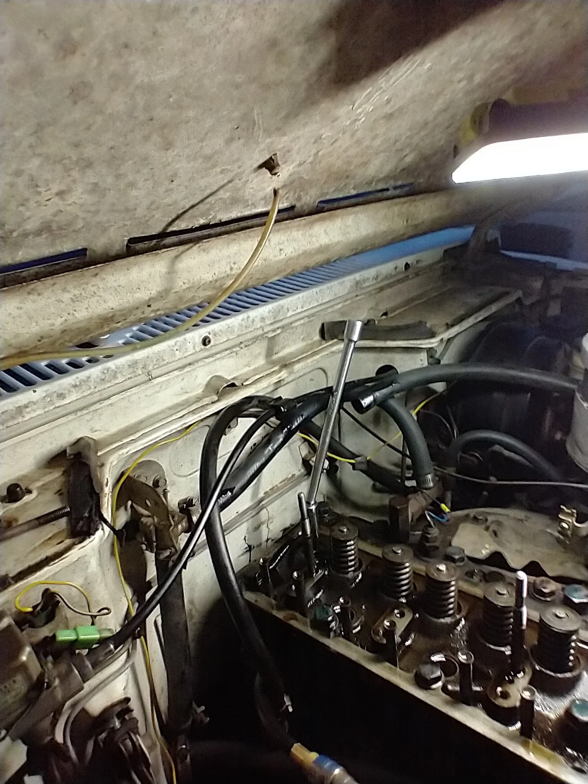

note the use of a wobble extension to install that last seal on #6

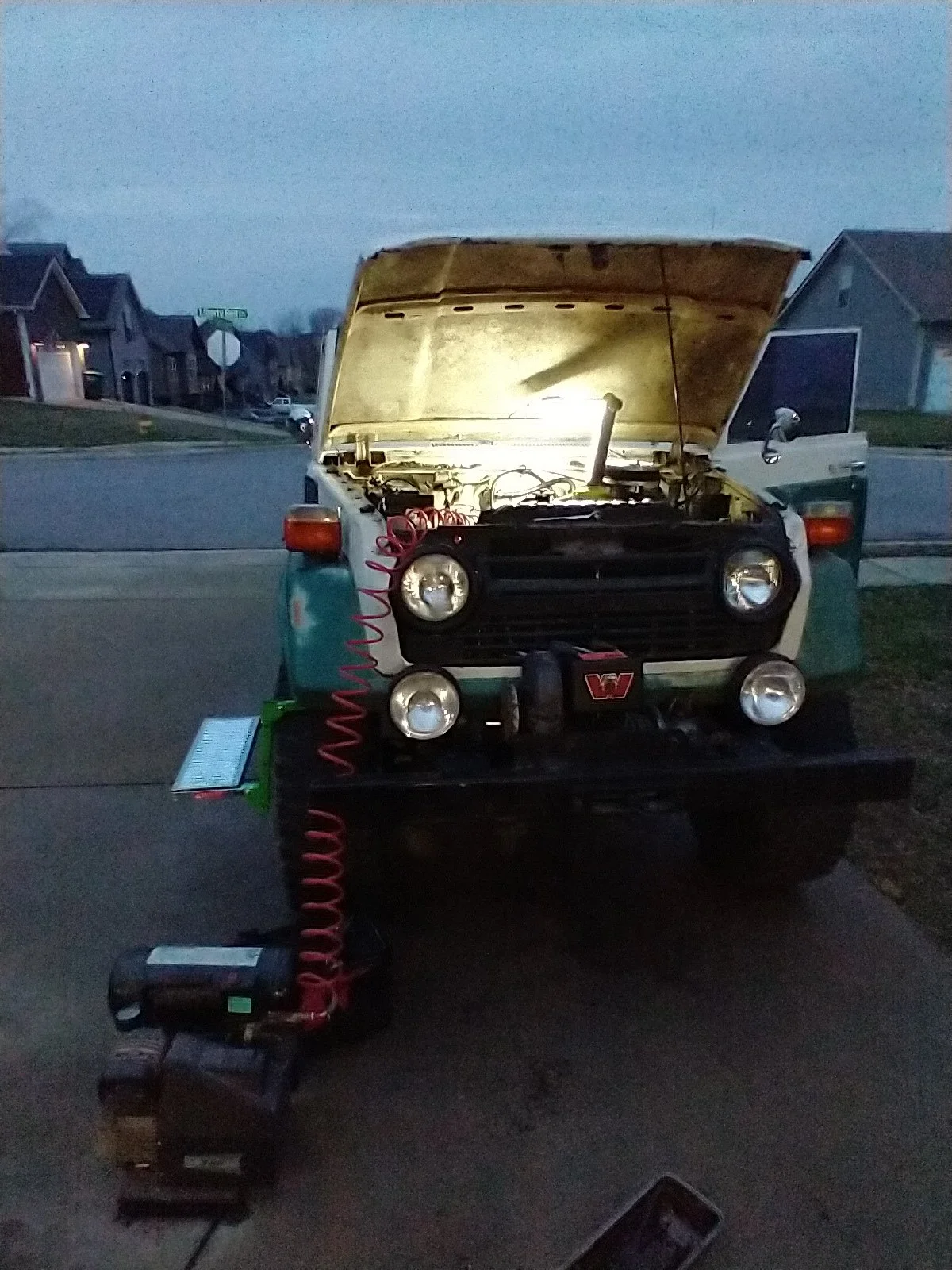

Did you use the compressed air to keep the valves up?
