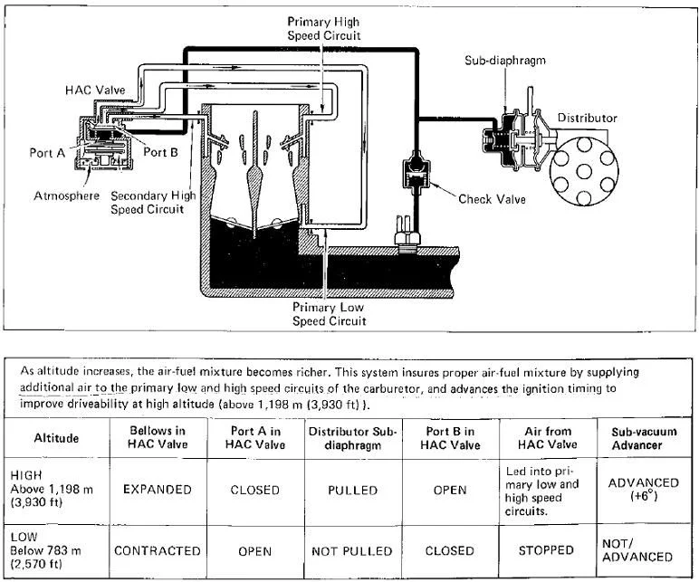

Is there a way to test the HAC valve when off the engine? My manual says that you can blow "into any one of the three ports on top when the engine is idling. If the passage is open, the valve is in the high altitude position. If it is closed, the valve is in the low altitude position".
Would the same prove true if the engine is not idling? Since the bottom tube is only for atmospheric pressure and any of the others can be removed to test the valve, I just wonder if there is a way to test it off the engine.
I think mine has failed, and the passage is closed. It should be open for the high altitude position and lean out the mixture over 4,000' elevation.
you would need to apply vacuum to the middle port near what's indicated as "port B" (the middle port).
Thanks! I applied vacuum and still no air passes through the other ports for the high altitude setting. Sounds like I'll be calling CDan on Monday.

There is a metal diaphragm that expands when at high altitude. If the diaphragm has a hole or has leaked it's "pressure" then it won't expand at altitude. You would have to fix the leak and fill the diaphragm to the correct pressure.
If you are spending all your time at high altitude you should be able to bypass the HAC by disconnecting the HAC tube from the distributor advance, plugging the tube and manually advancing the timing. Disconnect the three vacuum lines from the top of the HAC and put filters on them to allow them to lean out the carburetor.
