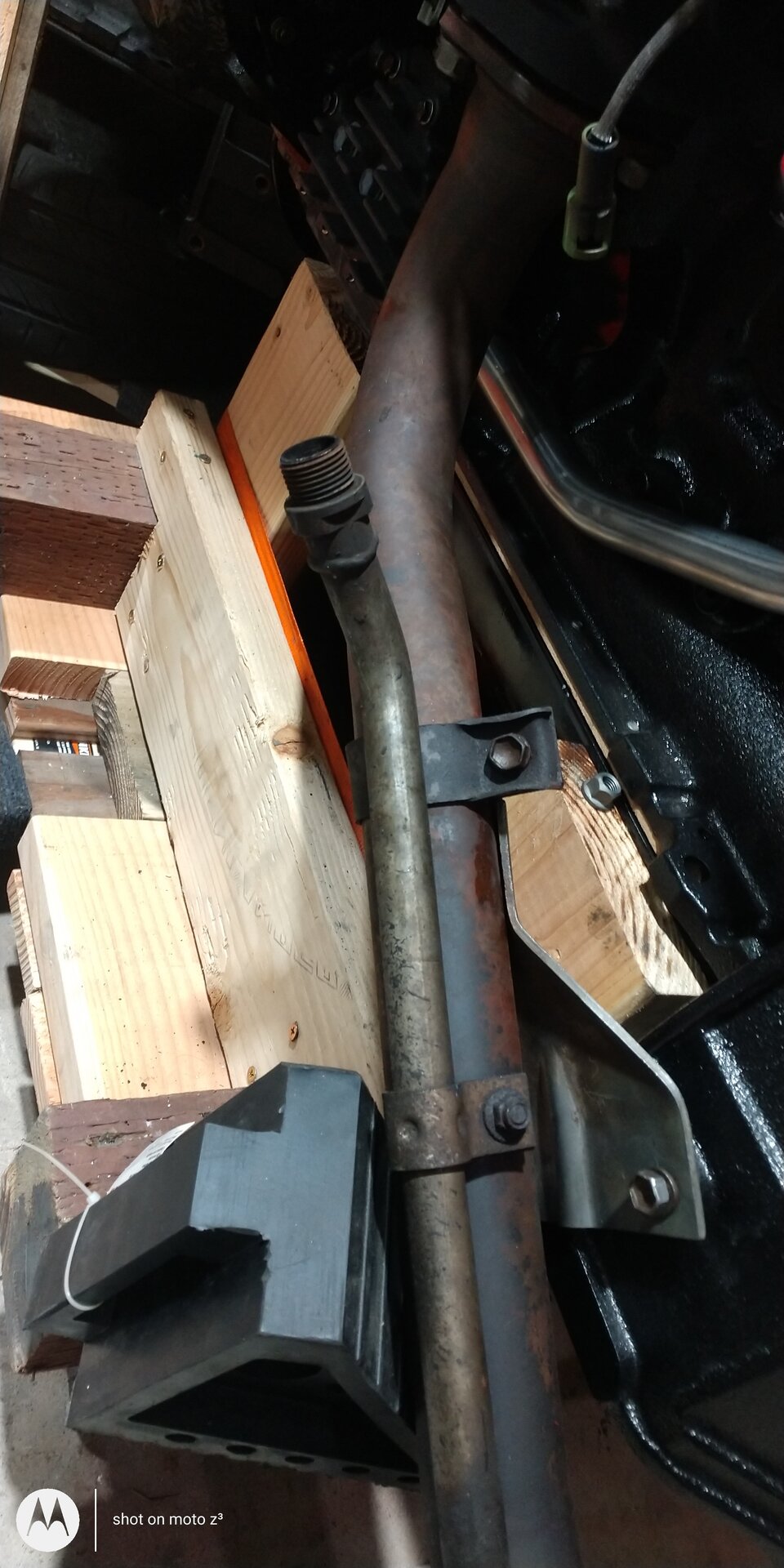

Hi All, the previous owner of my truck ran headers and removed the downpipe and downpipe brackets. Does anyone have images of how and where the downpipe brackets attach on the frame and/or drivetrain? I believe the below brackets I highlighted in yellow attach somewhere before the catalytic converter and may be partially hidden by the skidplate. Appreciate any help. Thank you.

Maybe these will help. Stock down pipe but the air injection tube has been removed.
Mystery solved. The FSM for the 2F and the Chassis didn't have diagrams on this. Anyway, I hope this is helpful to anyone in the future dealing with a PO's exhaust mods.
but the first gen. microfiche was 100% correct on its angle and location too
between all 3 oem resources , you can't go wrong,. and will always be correct at the end of the day
