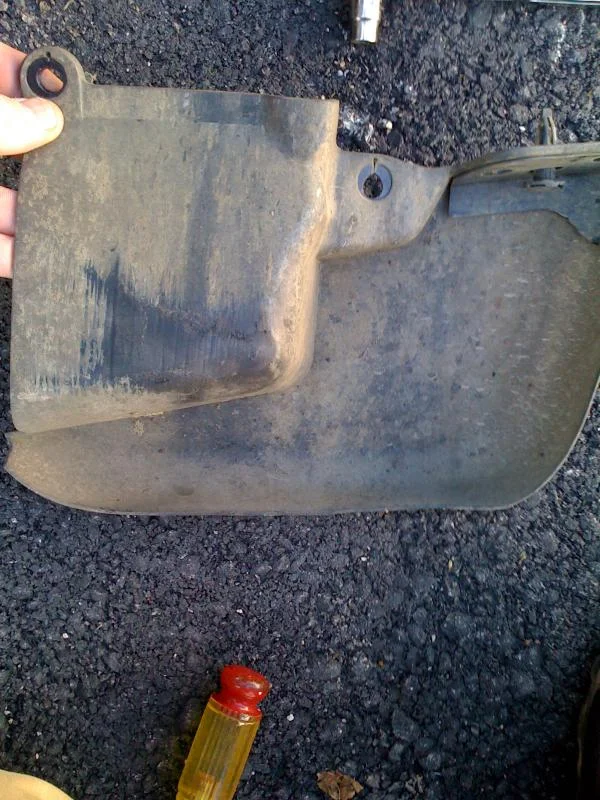

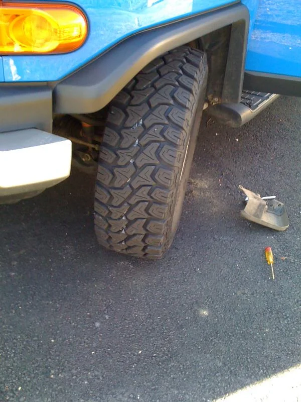

They fit but I had to take off the gay mudd flap. I am going to get a lift but I thought I would add my pictures.
