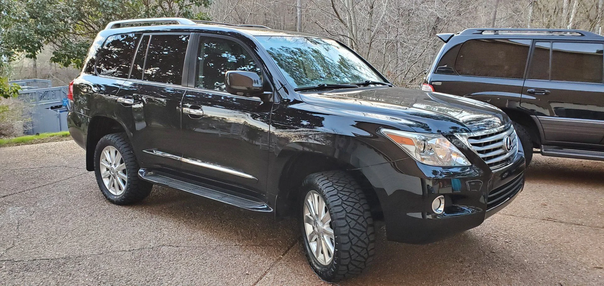

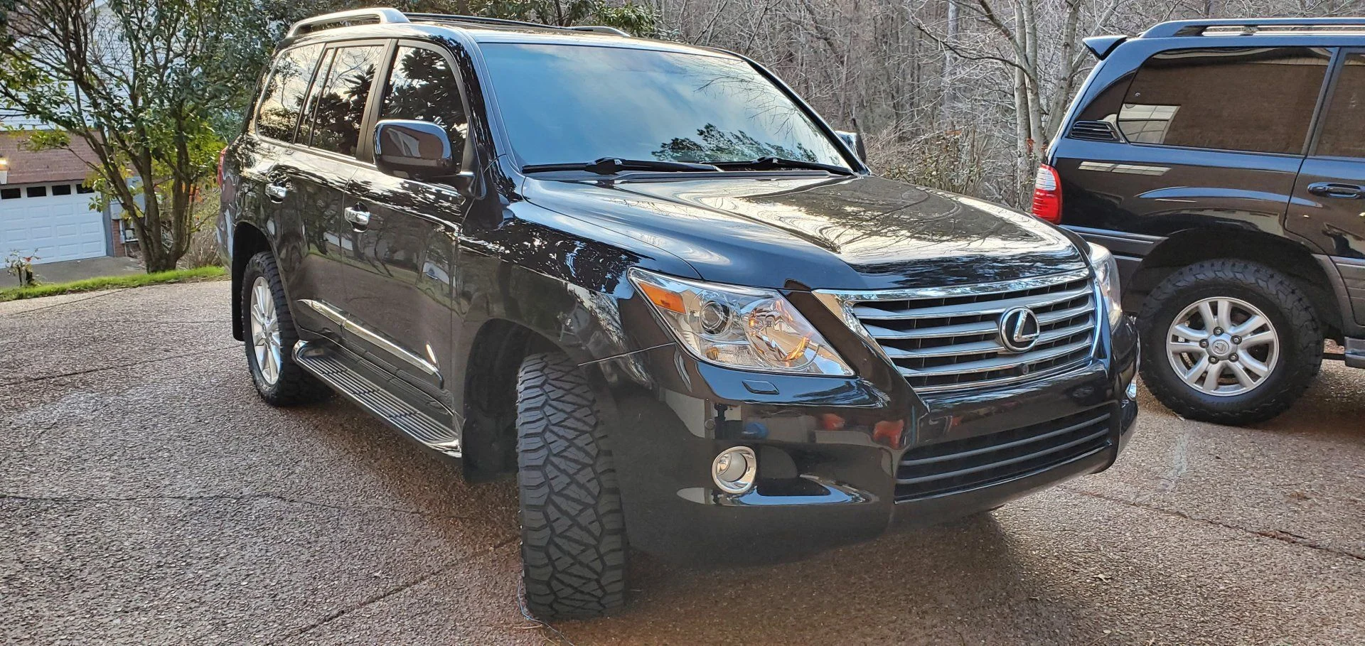

275 60 r20 k02’s, while narrower than stock, are also 32.9”, fit fine, and are only around $250 each.
I went back and forth on whether it was a good idea to go narrower than stock, but, upon finding out the above is an oem size for f250’s and f350’s with tow ratings far beyond anything the lx570 would be pulling, decided that they would do the job.
I’ve been satisfied with them and, unless my rims become damaged, will replace them with the same when it’s time.

@highfructose Just when I thought I had made up my mind, you come in with a completely new option! :)
1. Do you have any pictures of your rig with the 275/60r20's on it?
2. How has ride quality and mpg been with this size, as compared to stock?

I only had stock tires on for a very short time right when I got it...I noticed a slight increase in road noise with the k02’s, but it’s not something I notice anymore. K02’s are known to be on the quiet side. Fuel economy is what you’d expect. I don’t like going more than 65-70 in it if I can help it...it’s a 6,000 lb suv on a luxury suspension and 33’s after all. I drive very conservatively (seen too many dead bodies and read too many statistics).
My notes indicate I got 20.7 mpg at 55 mph (in Florida) on my most recent 200 mile trip. I got 20 mpg at 65 on that same trip on the way back until I hit traffic...the total hand calculated mpg including change in odometer due to tire size was 19.55 mpg. I haven’t kept close records of what I got from 70-75 on my interstate trips. I think it was north of 16.5 though...so the hit to mpg by going up just this little bit isn’t major. I can’t stress enough that I’m a conservative driver though. Your mileage may vary. My tank to tank average is usually in the 14-16 range...which is typical I think.
ride quality is good in my opinion...this is subjective however. These k02’s are light truck tires. If you want ultimate comfort, I would stick with oem sized p tires.

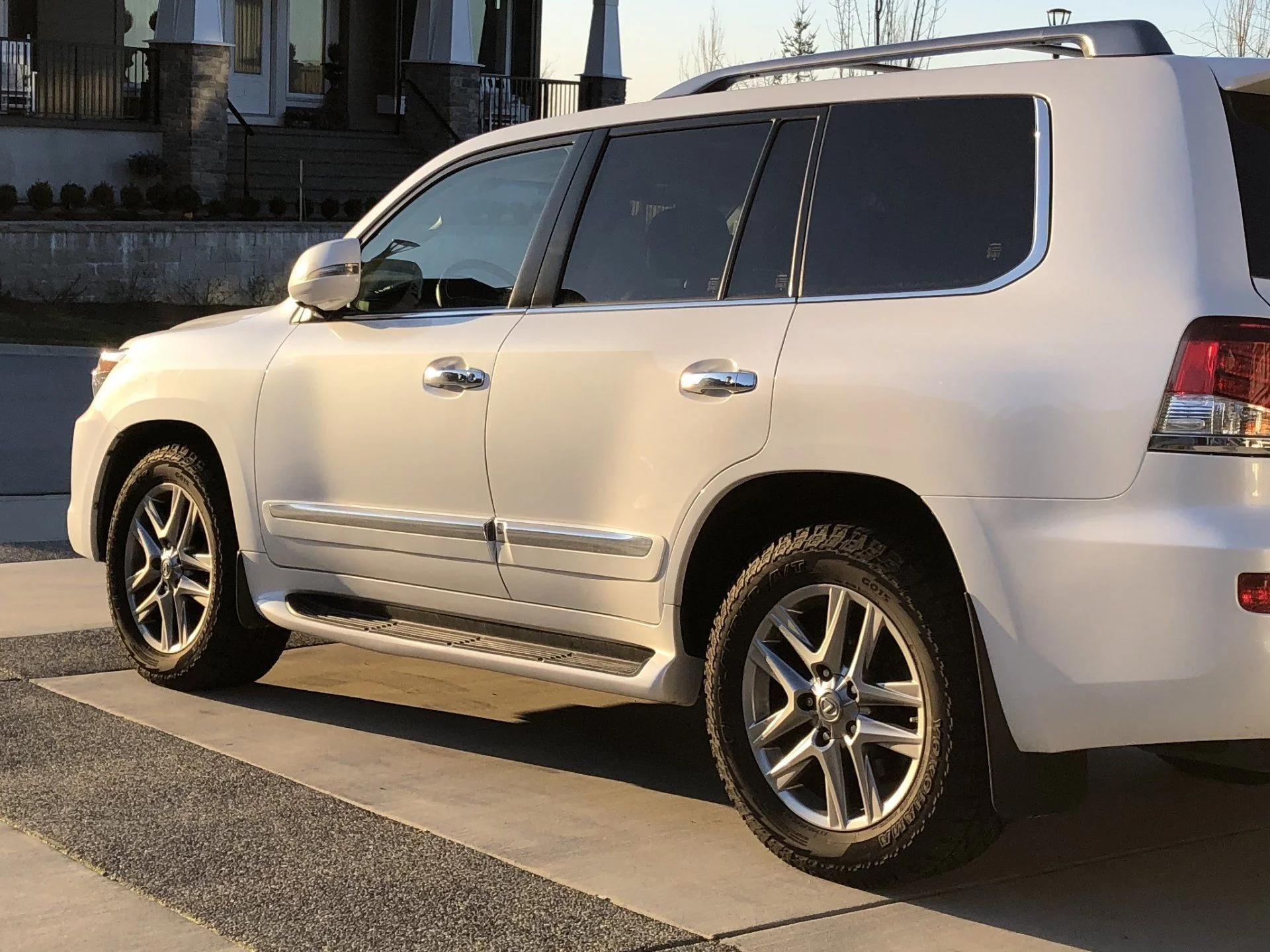

I'm an advocate for larger and wider tires. Not necessarily wildly so, although I've found the platform to take increasingly larger tires with aplomb. The level of performance at each step over my build iterations gave me the confidence to go all the way to 35x12.5s. To that point, I think there's a great opportunity in a mild lesser represented size - 295/55R20.
It's available in both KO2 and Toyo ATIII flavor. Spec sizing at 32.8" x 12.2" which is a tire size that the LX will easily accommodate. Diameter that's inline with a factory approved Rock Warrior 285/70R17 (32.7"x11.2") fitment, but wider for the heavier LX, and to maintain cornering and braking performance as builds gain weight. Wider tires also help with ride quality with more compliant sidewall geometry.

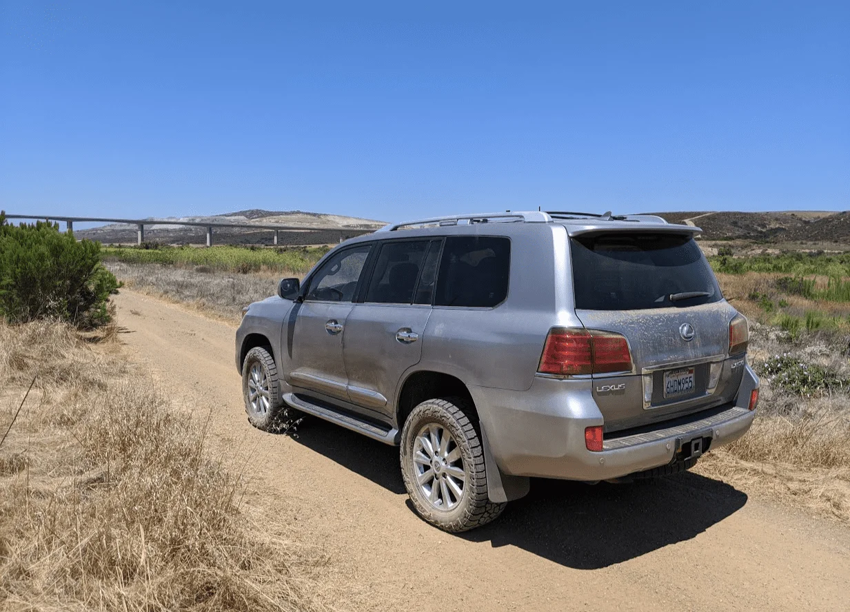

Here's my incrementally larger 305/55R20 (33.2" x 12.4") which I ran for over 50k miles on Falken AT3Ws. Can't say enough good things about this setup.
To the points about NVH, comfort, quietness, and performance... I'd highly recommend the newest Toyo ATIIIs in LT flavor. These have 4+ years of advantage over other tires in development technology having just been released.

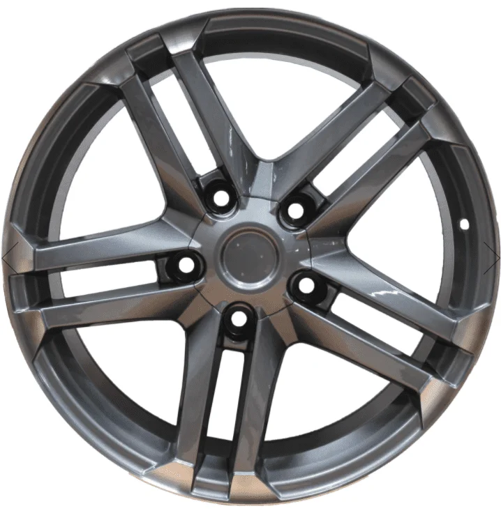

Theoretically, let’s say one wanted a 295-305 width and somewhere in the 32.5”-33” diameter...is there an optimum offset oem rim available to maintain proper scrub radius and requiring no massaging and trimming of plastic?
i would be curious to find the “perfect” size tire and rim sans spacers for the platform with all terrains.

This question is tougher than it seems as there's not a lot out there. If we're talking about tire analogues of similar overall dimensions, then the 17" Rock Warriors being designed for a 32.7" tire with +50mm offset is it. Once upon a time, there was a BBS/TRD forged 20" wheel that came in +45. I've not seen it since but it was of this style
