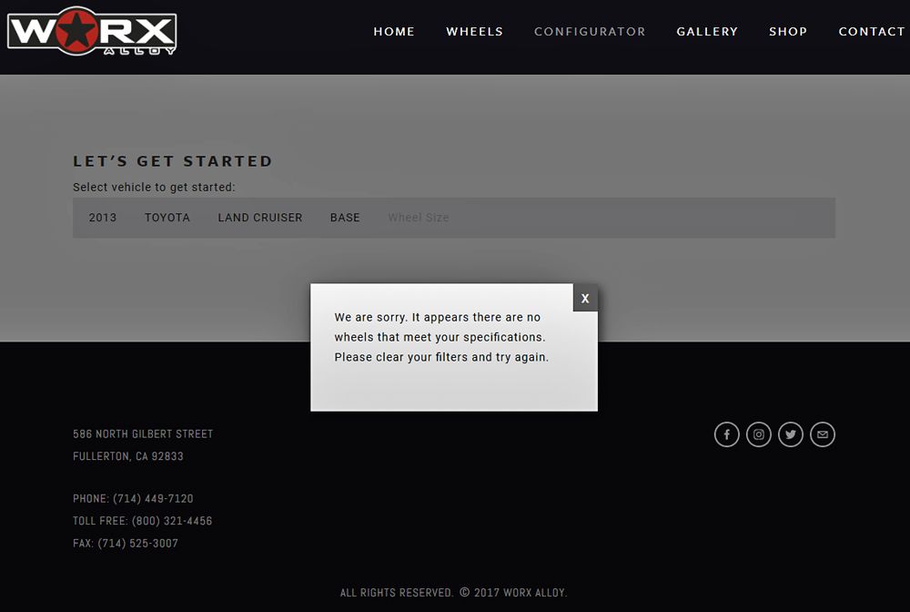

I don't want to be "That Guy" (maybe too late already), but do you know the Load Rating for the Worx wheel you have chosen? I went to the Worx web site to see what they recommend for LC200's and found this when I plugged my 2013 LC into their configurator:
Undoubtedly you found a wheel that has 5x150 lug spacing and a 110.3mm bore that will physically bolt onto your LC200, but do you know it will be safe? If the wheel manufacturer stands behind no recommended wheel, probably not a good sign.

uh oh. thanks. tirerack and tirebuyer listed it as options. let me look into.
HTH
I've seen that before, and if you run it through the same way for a Tundra, it works. I can only guess that a lot of wheel manufacturers see such little demand for the 200 they don't go through whatever steps necessary to see if it will work on the truck even though it most likely will if it works for the Tundra.
